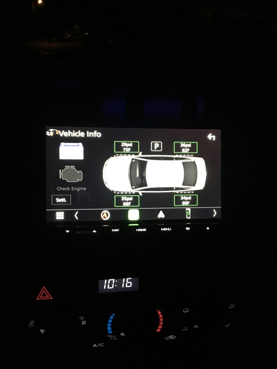

    Yes you could use a C clamp - I just didn’t want to waste a clamp.
    I have a pioneer deck that displays the pressure at each tire, so I didn’t want to disable the system completely; that’s a separate discussion anyway.

    You can get individual tire info on the 2nd gen, we just don't have the hardware from the factory to display it (ignore the low tire....it is my spare).
