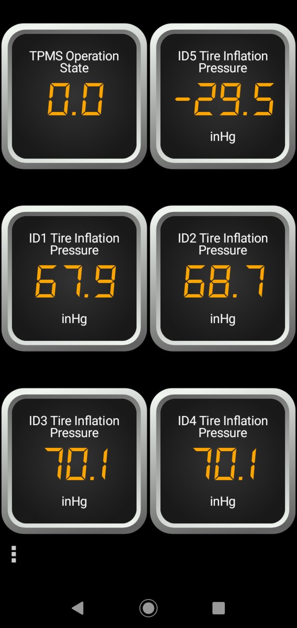

    43
    I have an OBDLink MX with the optional Toyota software. It can connect to and give me a per-tire reading.Screenshot_20191026-152908.jpg. I had it set for inches of mercury but, it was working.
