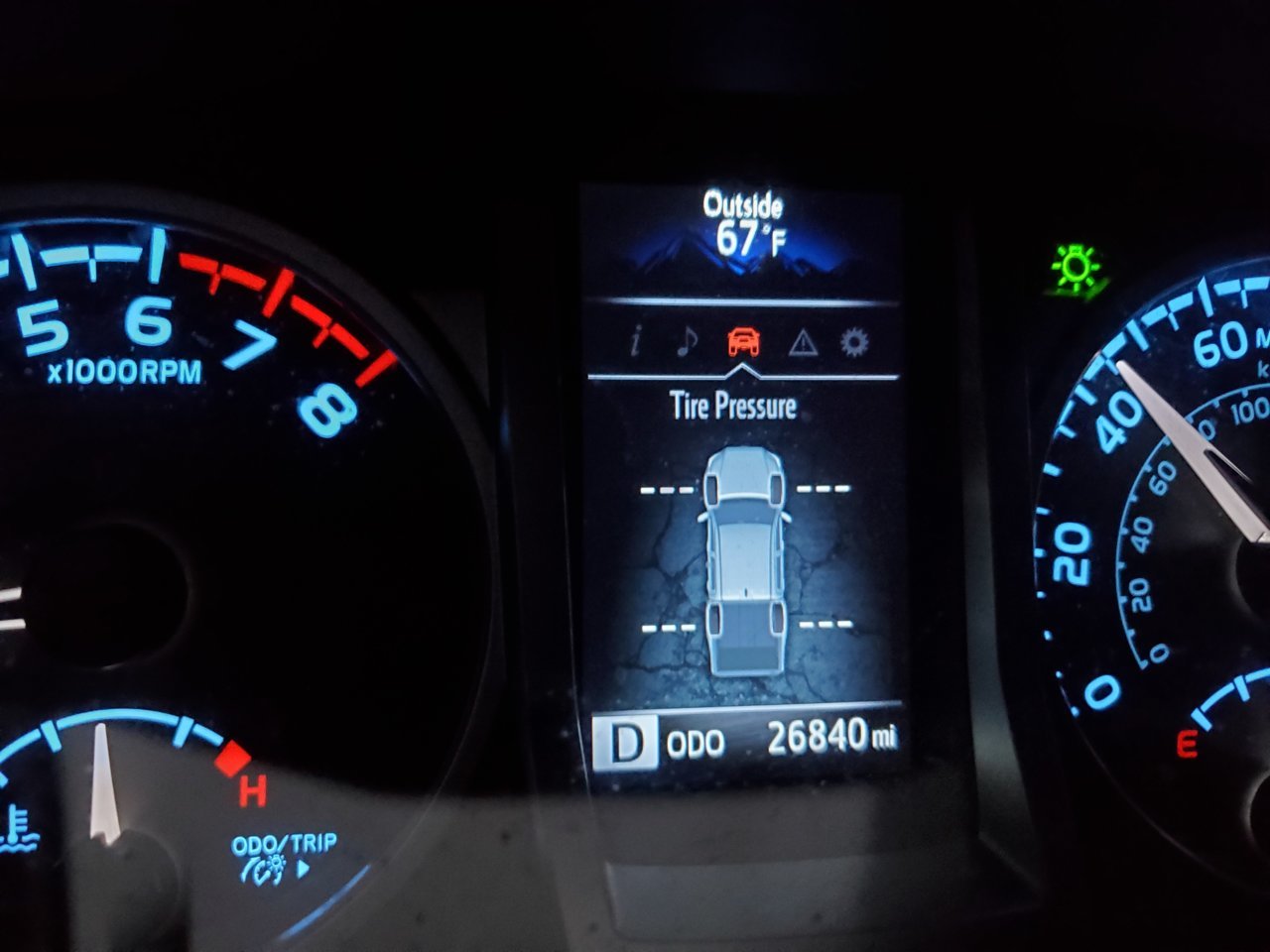

    So I did my first tire rotation on my truck. It was a 5 tire rotation. I took the truck for a ride and noticed that three of the four tires I was driving on were having some increase in tire pressure as I drove. The passenger front tire pressure did not budge. But it suddenly occurred to me that I had rotated the front passenger tire to the spare so maybe it was reading the pressure on the spare.
    So I read how to do the reset. I turned on my engine, hit the reset button and the tire pressure blinked three times then went out. So I took my finger off the button and the TPMS on the display remained blank for each tire:
    So I went on a drive so the TPMS could relearn. Drove 30 minutes. And nothing: the TPMS just remained blank for each tire.
    What am I doing wrong?

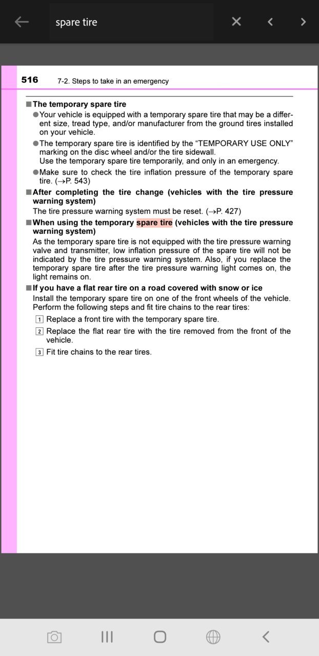

    Spare tire is always for TEMPORARY USE so you can get moving and get the regular one repaired. That is unless you replaced it with a full size spare. It's not meant to be driven on as a regular tire. Also, per manual, spare does not come with tpms sensor.
