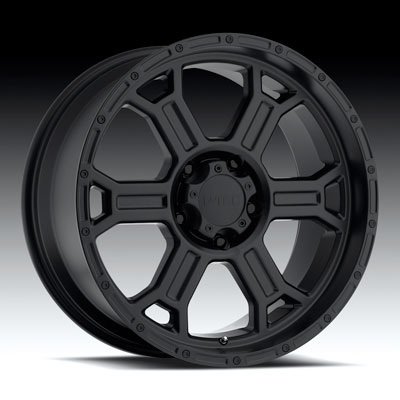

    I just purchased new rims to replace the 16" steel wheels that came on my 09 Tacoma 4x4 AC. I went with these:
    I ordered them online from DiscountTireDirect.com.

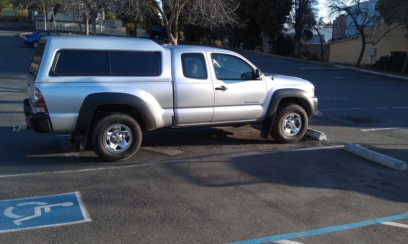

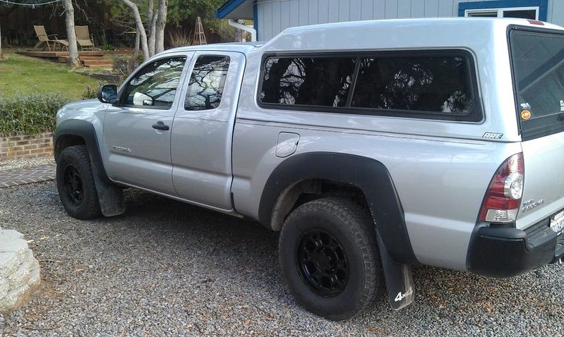

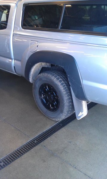

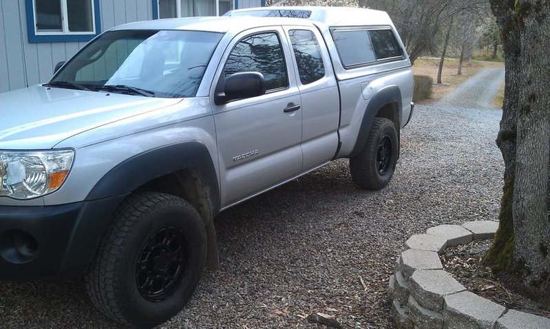

    Here are some before and after pics..
    Before:
    After:
    And all did not go well with the installation. The TPMS straps that DiscountTireDirect.com sent me did not work with the stock TPMS sensors from the steel wheels.
    I called my local Toyota dealer for info. What they said was the steel rims use a sensor that has a 20 degree angled valvestem, and the alloy sensors have a 40 degree angled valvestem. The cost? $116 per sensor.
    So I called Americas Tire store and they had TPMS sensors. I drove there, 35 minutes one way, and had them test fit the sensors in my new wheels. They fit and were $60.00 per wheel. So I sucked it up and bought them. 1/2 the cost of Toyota sensors.
    I went back to my local tire place, again, 35 minutes one way, and had them install the tires on my new rims.
    All is well? Nope, they could not reset the TPMS monitor in the truck, it had to be done through the OBD plug, which they did not have.
    SOOOO, 35 minutes back to Americas Tire and they reset them for free.
    My 8am tire appointment was completed at 1:30pm. Long day but I love my new rims. This week, the lift install.... :D
