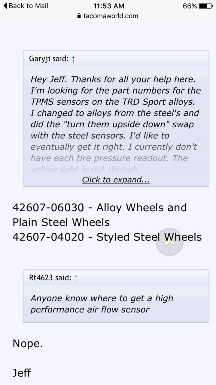

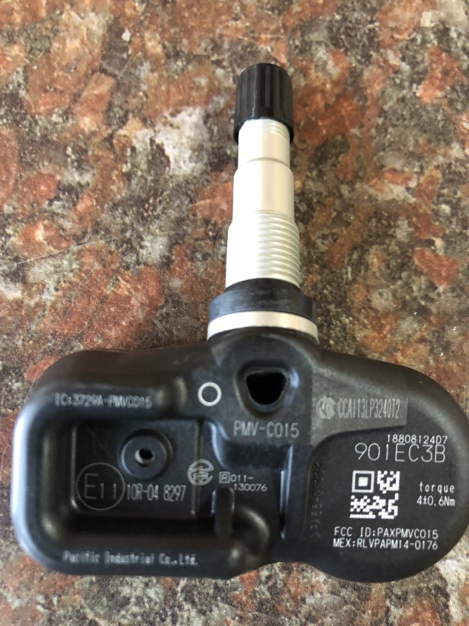

    Here ya go. The big number on the right has to be entered into the ECU, and it's location.
    G.

    Not sure if the deal is still out there, but I got 4 OEM sensors (06030) from a dealer in California for about 50 bucks each. Check the net.
    You can find them for less than full Toyota retail.
    G.

    There are also Denso sensors which are the same as OEM. Part #550-0106. As mentioned you should be using OEM (or Denso) sensors. Aftermarket sensors don't work well with our trucks. Also there are aftermarket TPMS programmers that can program the OEM sensors. Just need the code from the sensors which is located directly on the sensor or scanning them with a tool.
