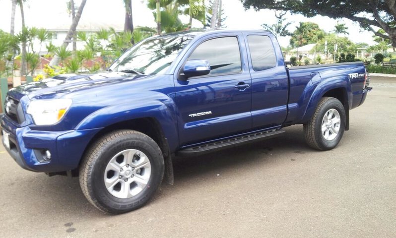

    I'm looking at a set of 4 Runner wheels. The seller's wheels are complete. Rims, tires, sensors. Will the sensors from these activate in my truck? Do I need to do something to make them work? Or is it just a swap and go?

    Well, thanks, I went to the local tire shop, $35 bucks later, no light
