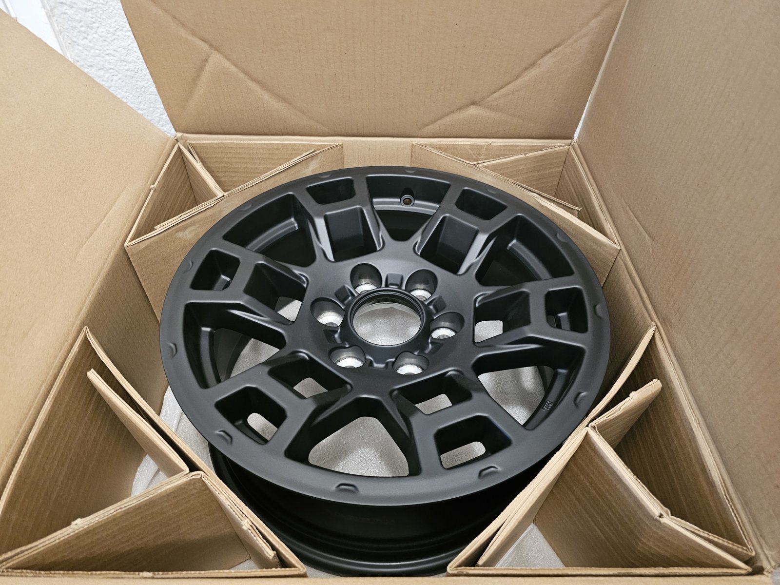

    They are alloys. Got this today:
    OEM (Toyota) Part Number 42607-02050 & 42607-06030 share the same protocol. In factory configuration they both have metal valve stems and the reason for the different part numbers is because they are different manufacturers. Originally Toyota offered 2 fixed metal valve stem sensors from the same manufacturer that shared the same communication protocol as one was for Alloy wheels and the second for Steel wheels and the only thing different is the valve angle. As for your application, there is OEM Part Number 42607-04020 for Steel wheels and 42607-02050 for Alloy wheel however, they also share the same protocol but in reality, you can use either in your application Rubber or Metal.

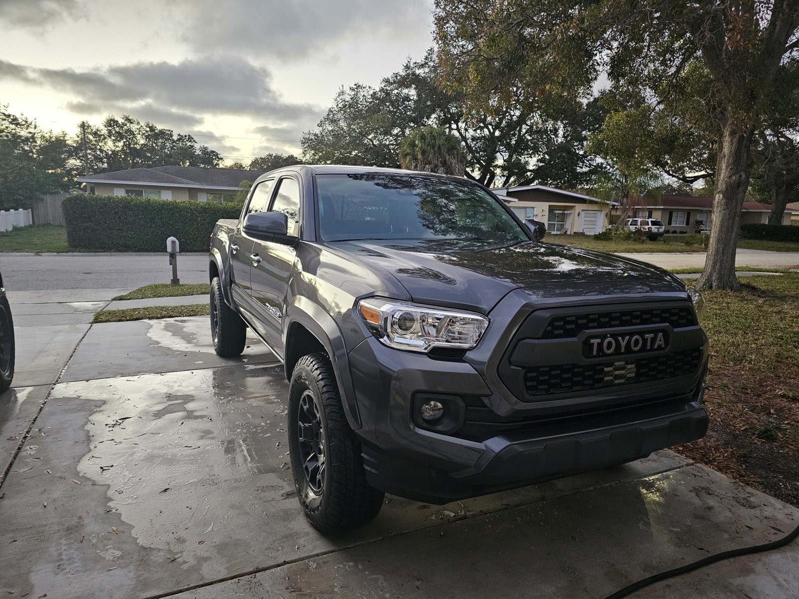

    2023 MGM SR5
    No spacers, all stock.
    Goodyear Wrangler AT/S P265/70R17 . Didn't want heavy tire.

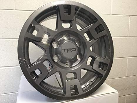

    I bought the 17x7" in glossy gun metal.
    (Pic from the .net)
