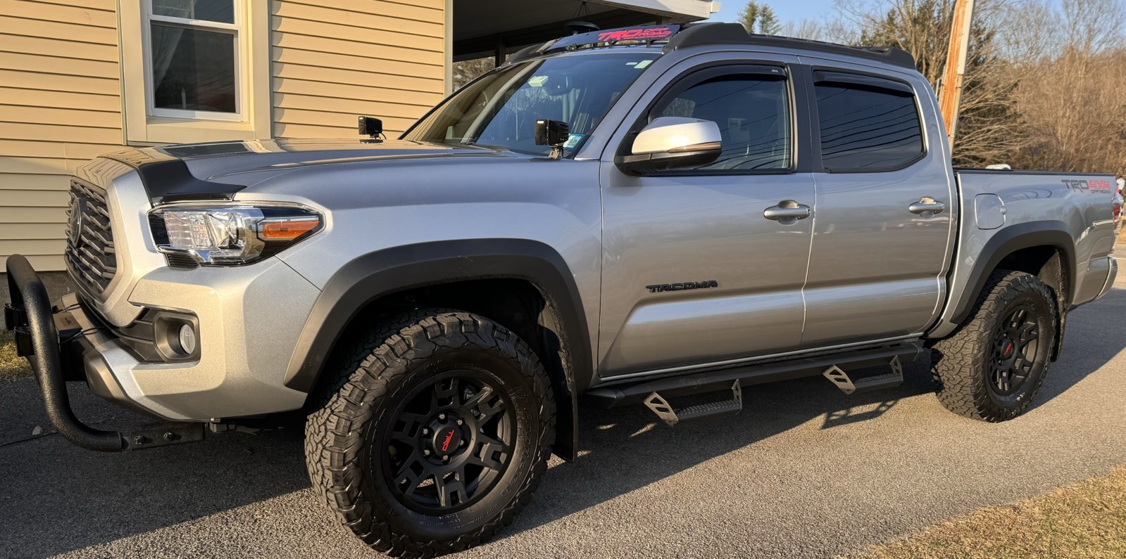

  4. Mar 16, 2024 at 11:45 AM
    #44
    lukr11
    lukr11 [OP] Well-Known Member
    Apr 1, 2023
    #421590
    80
    ‘23 TRD OFF ROAD SILVER
    All set up. Transferred sensors and used stem kit for correct angle. Have an OVS Expedition Cap coming next week!
