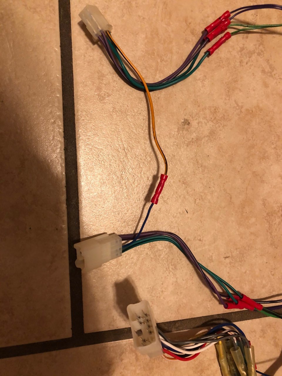

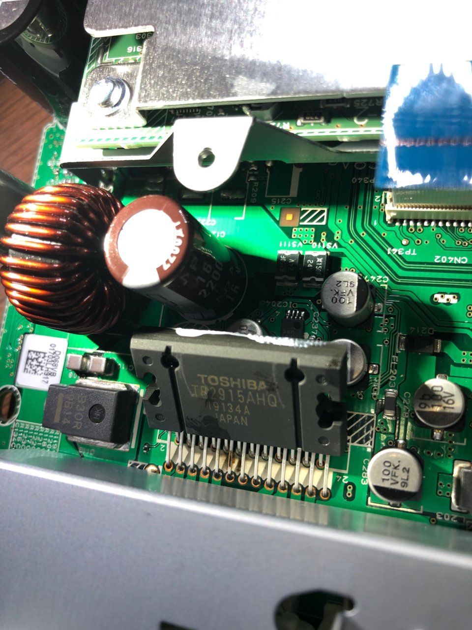

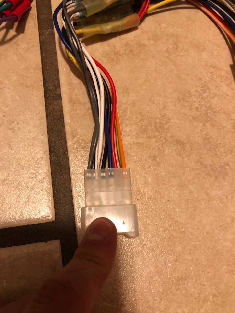

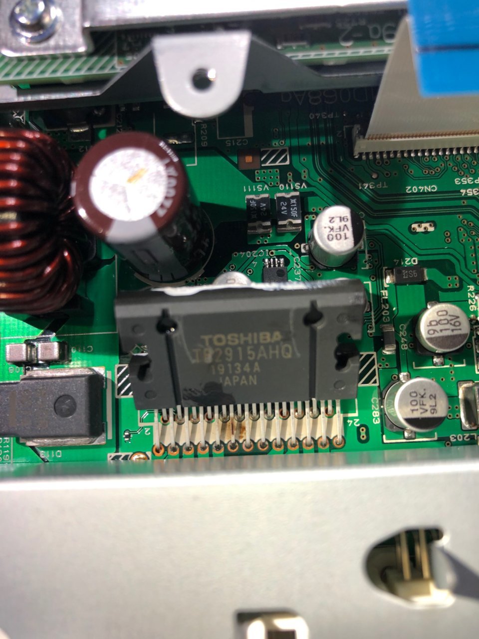

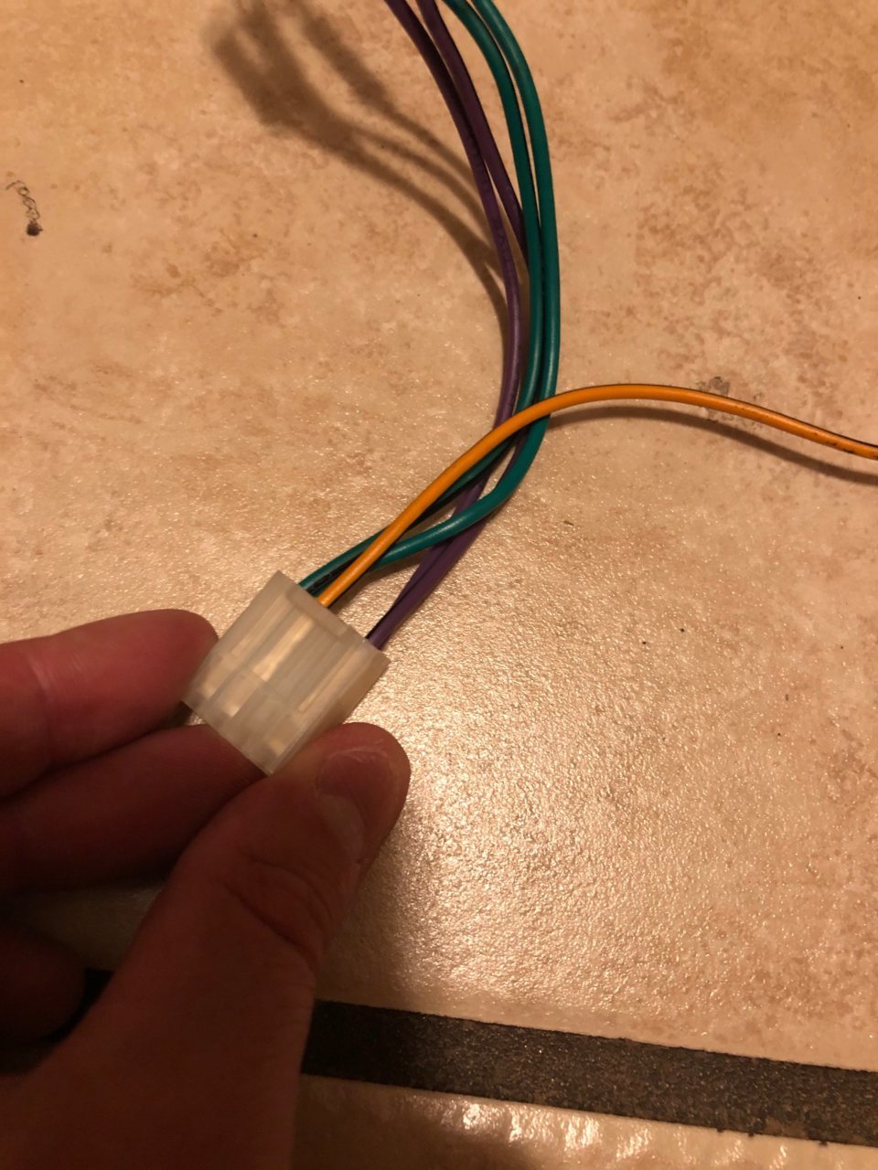

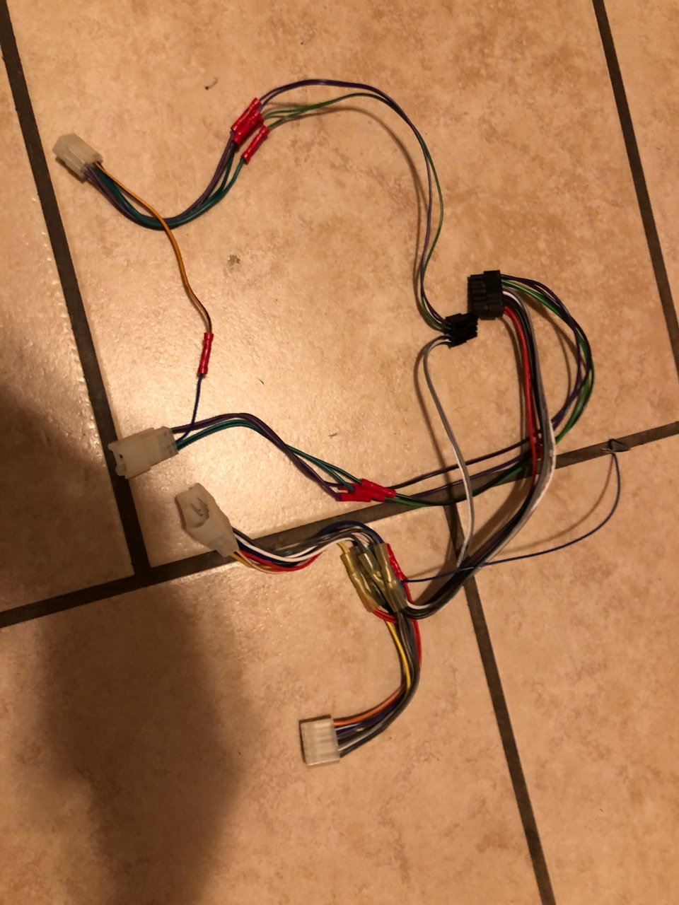

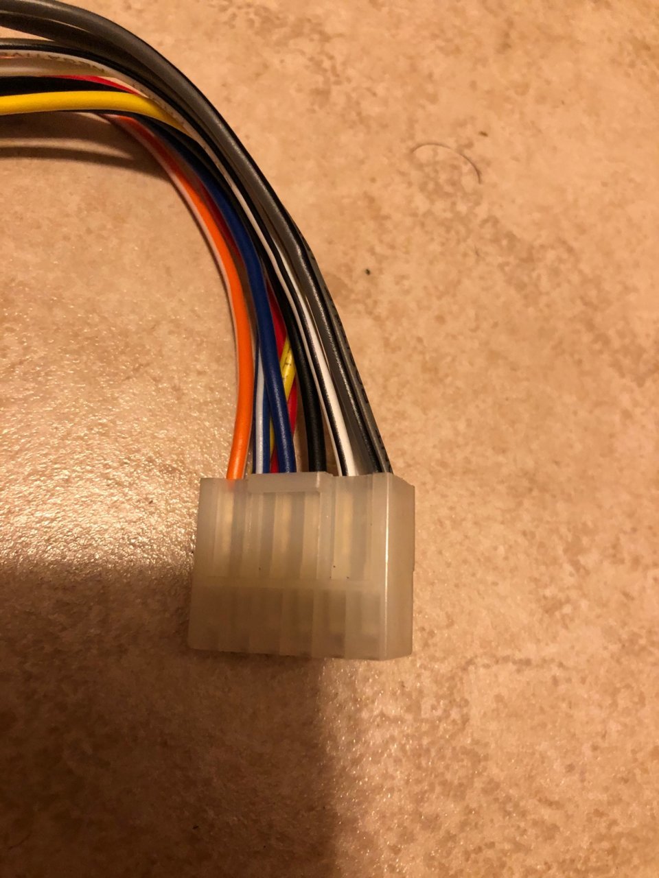

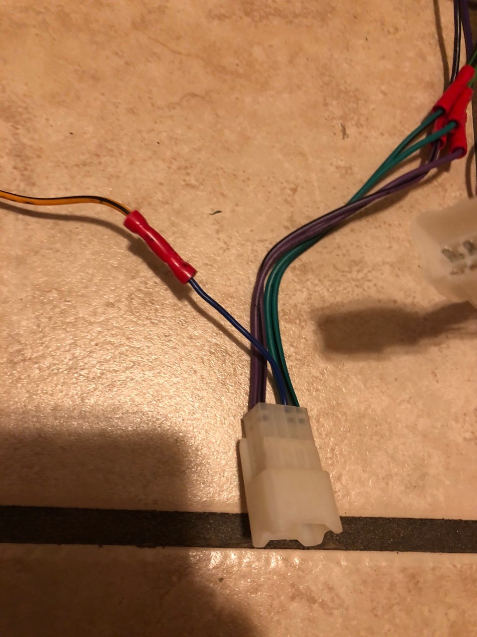

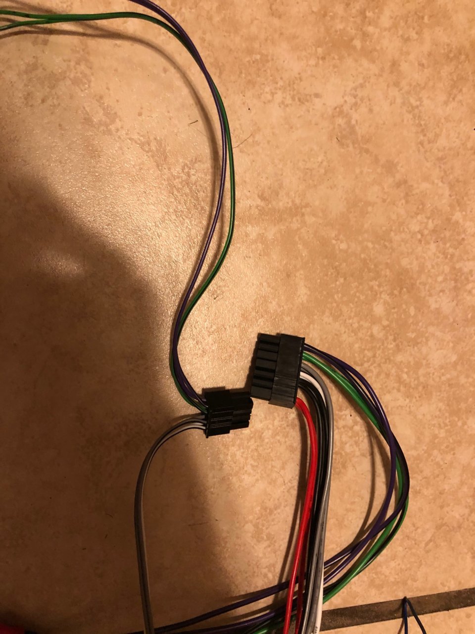

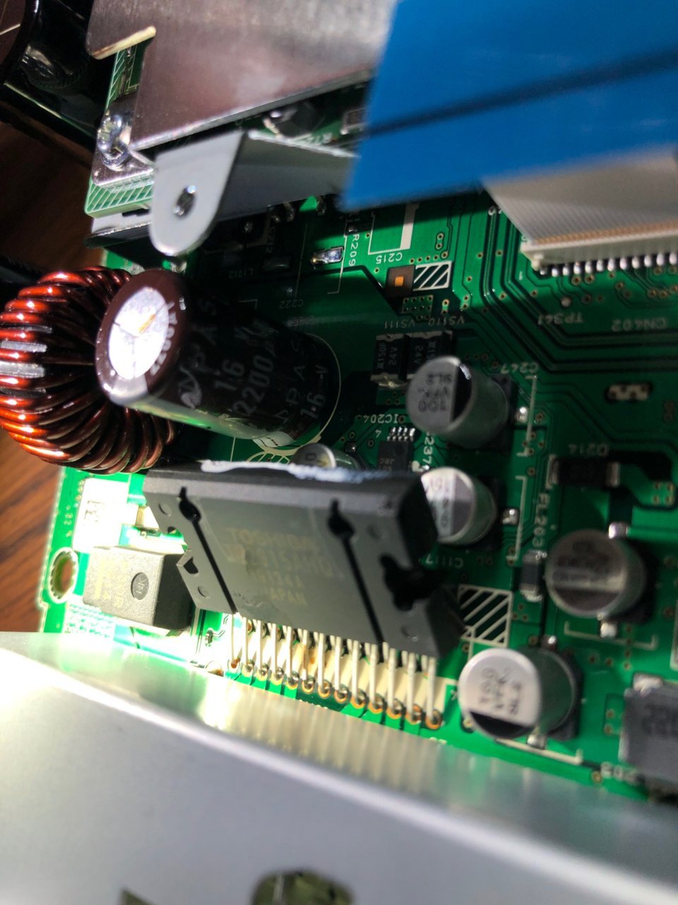

    Is anyone willing to part ways with their factory entune 8"?? It looks like I blew the stock amplifier on the board (TOSHIBA TB2915AHQ). Its bursted and smells burnt. When I turned on my truck to ACC, I got loud noises through the speakers and the amp red light was going in and out. It started to smell bad so I shut it off. I disconnected the battery and checked everything to find the pictures attached. I also have my t-harness. Please let me know if there is something wrong with it.
    I have the remote wire detached shown in the picture.
    EDIT 8.13.2020 9:26PM. My dumbass spliced the whites and gray so essentially the key amp was amplifying back to the stock board amp:mad:. Still need a factory head unit though. I'm going to try and desolder this one out.
    EDIT 8.14.2020. Local guy had a headunit to spare so im back up and running with my kicker key and speakers all good to go!:thumbsup:
