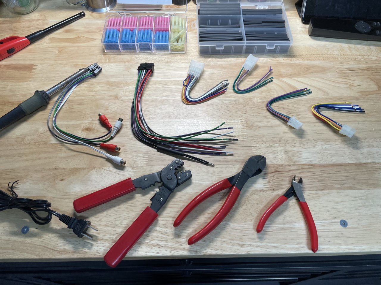

    Just to confirm, to depin the Metra harness, you are coming in from the wire side and not the connector side, correct?

    Correct

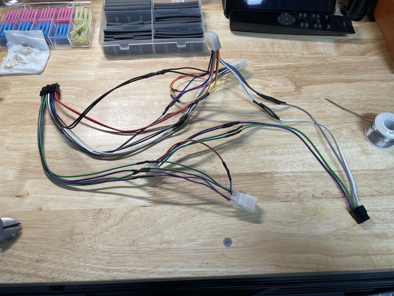

    Where I started...

    2 hours later

    Electrical work on the bench is like meditation to me

    i wanted to buy a harness, but since nobody had one ready to go I figured I’d use my old soldering skills. Used to drag race so have some experience wiring in gauges and making decent connections. Used to race rc cars back in my teenage years so I’ve always been able to solder well. Fun way to waste two hours, now let’s hope it works haha

    Finished my install, pretty simple and straight forward. I could probably build a harness and install it going forward in under an hour now, but I have 3-4 hours invested doing it the first time.
    For anyone wondering, I feel it made some good improvements. I'd compare the improvement similar as going from stock speakers to the Kicker speakers. A similar sound improvement from going from factory amplified Kicker speakers to Kicker Key amplified Kicker speakers.
    I'm sure going back to a stock stereo truck is just horrible now.
