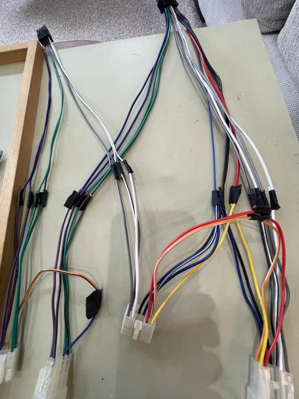

    I know this is a fairly old thread, but I'm hoping people are still willing to provide some support.
    I got my wiring harness all planned out. Does this look right @destin_meeks or anyone else? I'm pretty good with electrical so I'm not super concerned about it being wrong, but always good to check with the experts.
    I appreciate people still supporting this thread after thing long.

    All looks good to me

    Man, you are a rockstar for your help and quick replies! Thanks a ton.

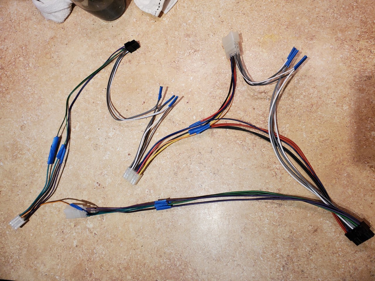

    Could someone please confirm that I did this correct please. TIA 2A92CBA8-E731-4E79-9263-0A3B4AA1F5AF.jpg
