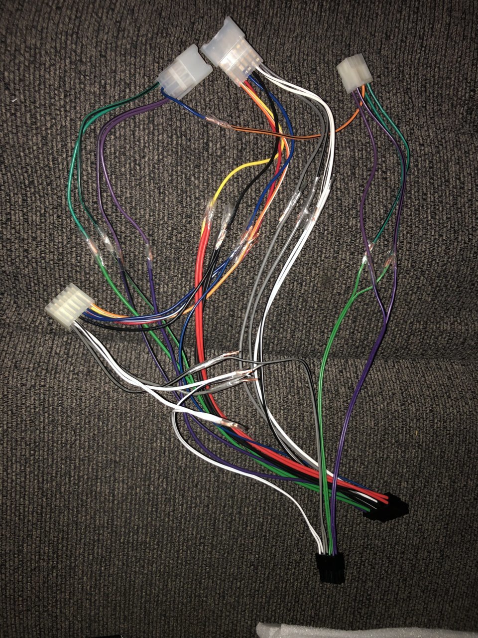

    Yeah, looks right from what I can tell

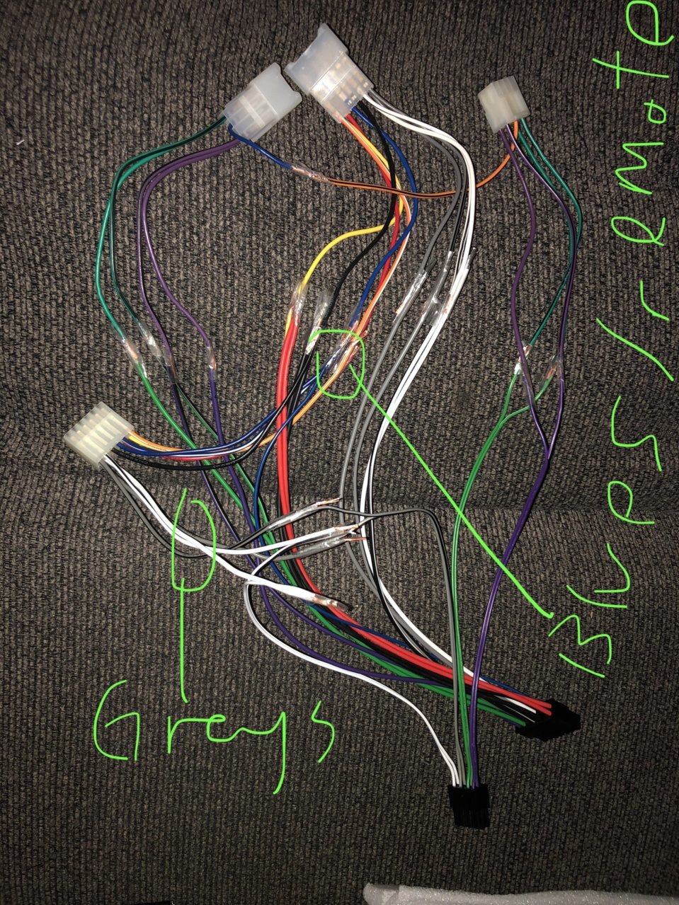

    Thanks! So I’ll be adding my loc and amp remote to theses areas. Are these the correct wires to tap in? C25678BE-617A-489C-966C-86B78E323CA1.jpg

    Yep

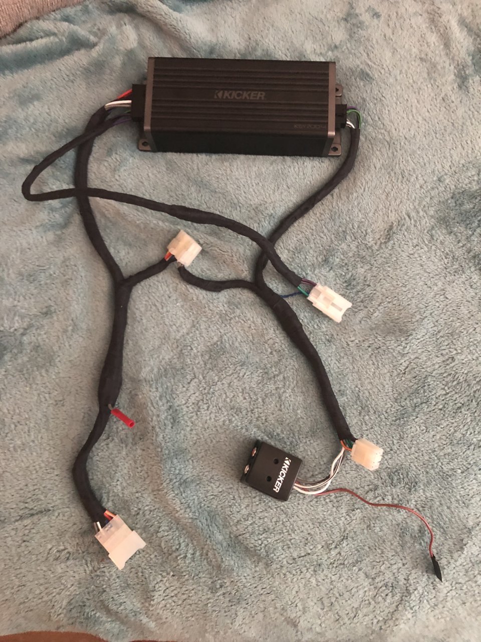

    C17C1D56-033D-45B0-A98C-E239DB3C4A05.jpgProject finished: Thanks to destin_meeks and tpp4. After doing the key auto tune I think I got the happy music. Can you guys tell me what it’s supposed to sound like? And I have a lot of noise when my volume is down do I need to turn my gains down lower? Thanks C17C1D56-033D-45B0-A98C-E239DB3C4A05.jpg

    The sad noise is very obviously sad. You’d know if you heard it
    for the noise, turning your gain down will definitely help. You’ll lose some top-end volume, but you should still be able to push it plenty loud

    So lowering the gain will get rid of the hiss? It has nothing to do with any grounding issues? Thanks

    Yeah it’s nothing to do with the grounding. You will see a bit less hiss if you run dedicated ground, and power to the battery. But these are honestly just noisy amps.for all the features they pack in and the price point they hit, somethings gotta give

    Yeah I had to lower the gains but you can barely hear the hiss after turning the volume up: thanks again for all your help my upgraded cabin speakers sound better.

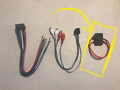

    Does the cable with the fuse need to be connected as well?

    Only if you’re running power to the battery
