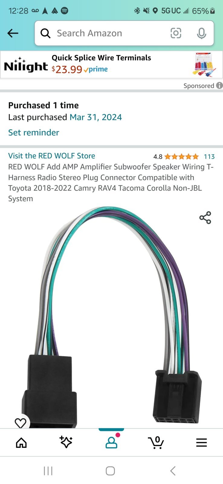

    Grab the redwolf harness you’ve seen here and just make it with that. Then disconnect the factory wiring from the current adapter you have, and add in the new harness as well

    You can follow the instructions for the 2020+ (or maybe it’s 2019? Whatever year it changed to the smaller black connector)
    a brief rundown of what your install should look like
    -red wolf harness from Amazon
    -1 roll of speed wire (multi-conductor speaker wire)
    -10awg amp power kit, or even better, a fused distribution block placed near your sub amp, and you can just split the existing power wire to both amps, as long as it’s at least 8awg. This will save money and lots of time
    Cut the redwood harness in half.
    Cut the speedwire in half.
    Splice one side of the harness to one half of speedwire.
    Splice the other side of harness to the other half of speedwire.
    For the part you just spliced the MALE redwolf end to, splice the SMALL key harness to. Cut the RCA’s off if they are on there.
    For the part with the FEMALE redwolf end, splice the LARGE key harness to.
    route your two newly formed wires from the radio cavity down into the dash and under the center console. You may want to pull up some panels around the gear shift and e-brake, but it’s very easy.
    Feed them down the center console, and under the passenger seat.
    Splice a few feet of 12 or 10 awg power and ground wires to the key harness and run them under the console and over to the distribution block.
    Plug in key
    Pull sub fuse, run key auto setup.
    Put sub fuse back
    Rock out

    Yes, you’ll do a double-tap.
    Radio > add-an-amp > redwolf > factory
    you could extend the remote wire from the sun over to the key if you want to, or just use the auto-turn-on feature

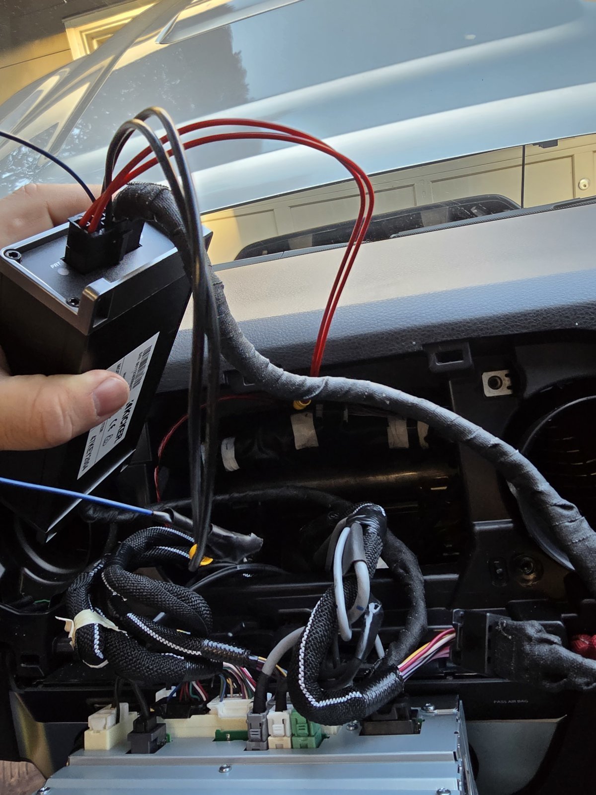

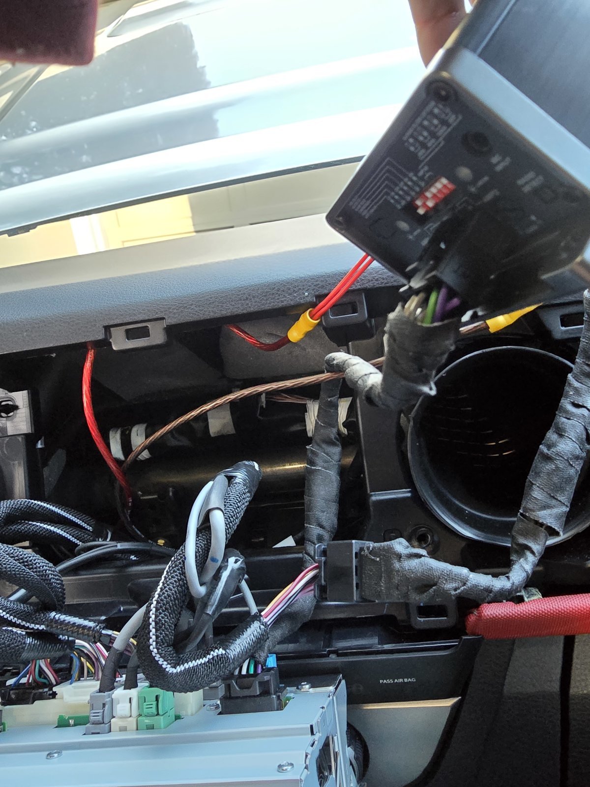

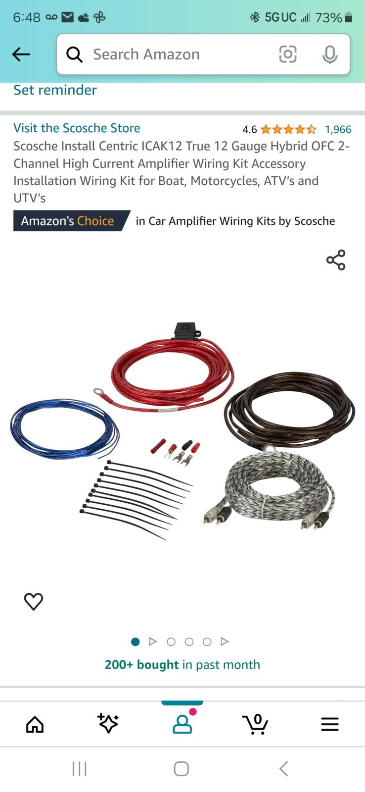

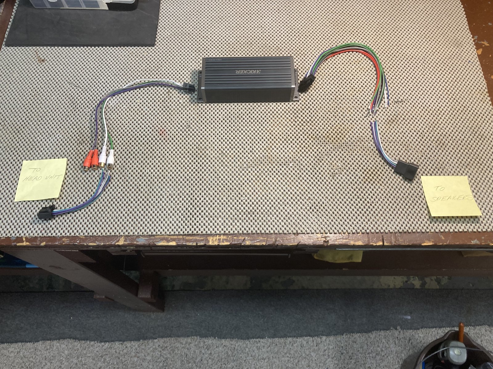

    I just installed the kicker key 200.4 in my 2021 tacoma w/ premium entune headunit (NON JBL). Buy this harness, cut it in half, match wires to each end of the kicker key. Male to male, female to female, since this will insert between your headunit and the factory speaker wires harness. MAKE SURE you color match every single wire, I'm dumb and didn't do this correctly the first time. There's 2 wires for every color, on both the female and Male ends between the redwolf harness and the kicker key harness. So each end will have 2 purple, 2 white, 2 gray, and 2 green totally 16 different wires total you need to butt splice or solder separately between both harnesses. Set all your dip switches on kicker key to up except the first one, that one should be down. You will also need a power and ground kit to run through your firewall to the battery, ideally the power wire should have a dedicated 10A maxi fuse between the kicker key and the battery terminal FYI. I chose to ground to the passenger kick panel near the passengers right foot. Also tape off the blue wire, you won't need it with a factory head unit
    Fire it up and adjust your gains on kicker key to where you can barely hear the white noise. Run your auto eq with the microphone. If you did it right you should hear happy noises. Tuck it in behind the head unit and button her back up. Donezo. Attaching some pics I took during my process

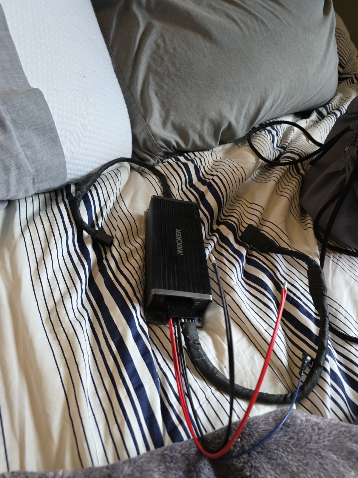

    Don't make this mistake. I didn't split the 4 wires apart intially, which means I connected the power and ground wires together causing them to short out immediately when firing up the vehicle. Each color had a solid color and a color with black stripes down the middle.

    thanks. couple questions.
    your third dip is down in the picture not just first. personal preference or should that one be down too?
    I dont have the key yet, its still in transit. But in the image why are there 2 red wires running from key to your single fused battery power?
    Similar question for ground, why 2 from the key to one solid? mpt as critical as pos side bc its a ground, but still ??

    For the power and ground, they do 2 of each but they are tied together on the circuit board. This allows them to get the correct power without needing a separate connection. Those wires fit in the plug

    3rd switch is the compressor dip switch. I was trying not to blow out my speakers initially when installing because i had no idea what I was doing and struggled to get it to work for like 3 days because I was combining the power and ground for each color (white + white/black, green+green/black, etc) on both sides between key and where key connects to each half of red wolf harness. I basically had 4 connections on each of the key when it needed to be 8 (16 total). Also I now just have the first dip switch down for DC Turn on

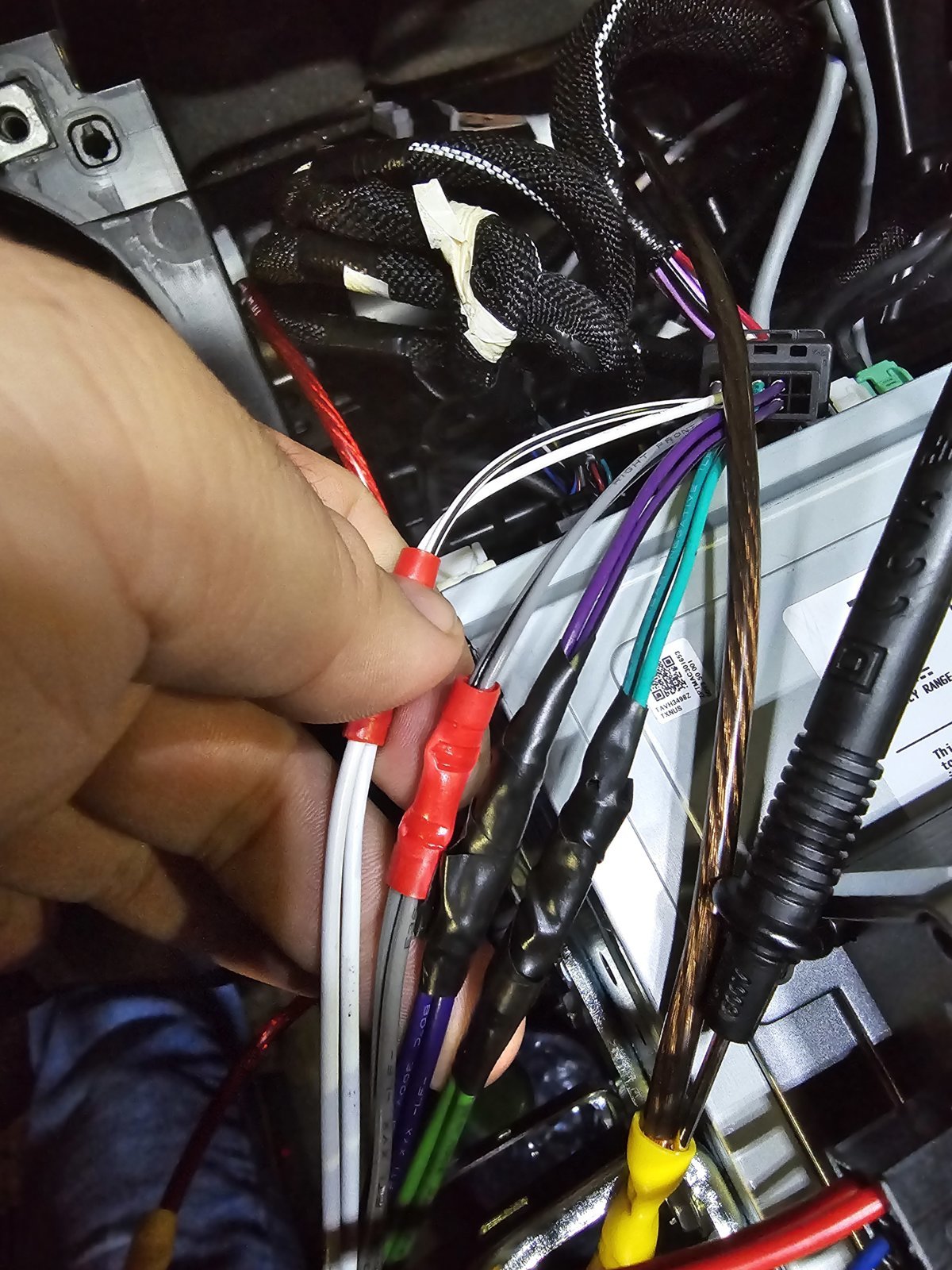

    @destin_meeks, is the configuration, using the cut in half Red Wolf harness, in the above photo correct? I do realize the RCA connectors need to be cut off before I proceed further.
    @Integerdy, after soldering the pre amp and post amp harnesses, did you have enough length in each harness to comfortably put the amp behind, under, beside, etc. the head unit or did you add additional wire to the two harnesses?
