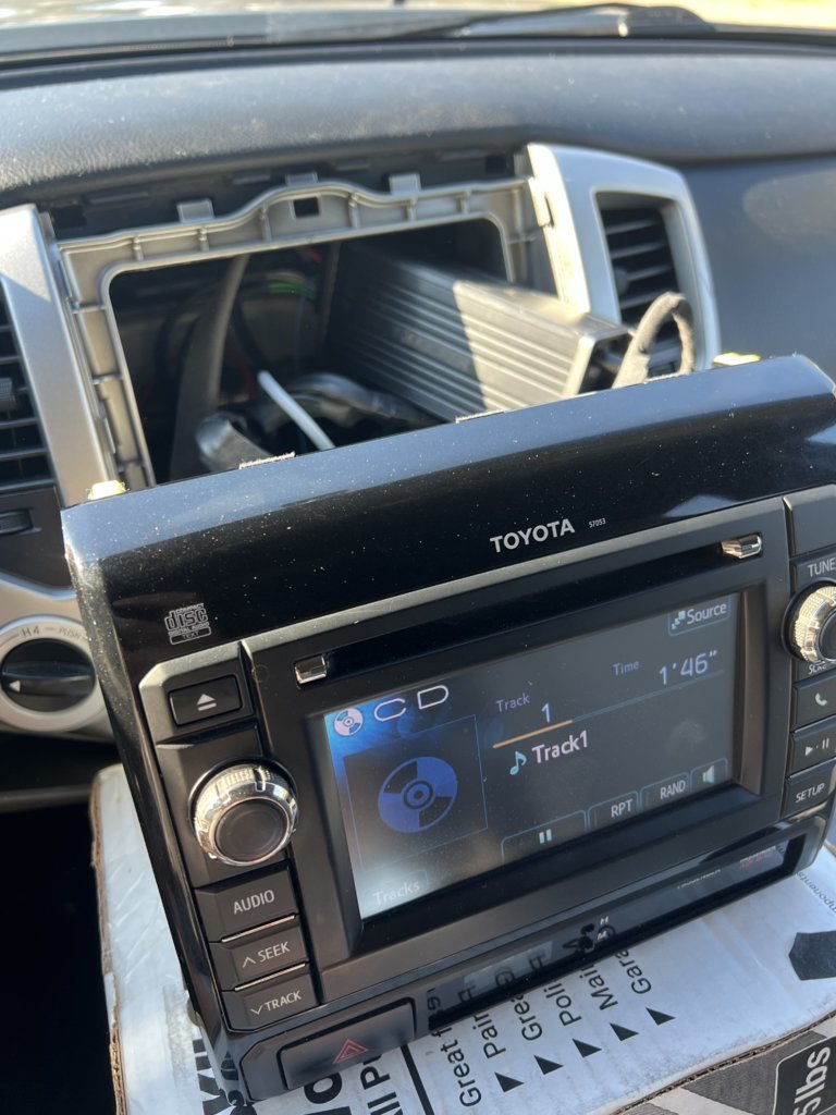

    Finally got this one knocked out. Kicker KS 6x9 components up front and KS 6.75 coaxials in the rear with the doors and back wall treated with deadener. Key 200.4 on the factory 2013 head unit. Went through 2 of the female Metra harnesses trying to depin the connectors, still haven’t figured out how to do it without destroying the tabs. I opted to run power straight to the battery and ground to the drivers side kick panel, I didn’t get a warm and fuzzy feeling about tapping into the existing power and ground. Sound is much improved and overall I’m happy with it aside from the white noise which might just be the nature of these amps and the awful head unit.
    Thanks to OP and Destin for the help!

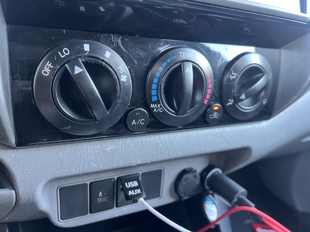

    Also scratched the hell out of my AC control panel putting the HU back in, not good.
