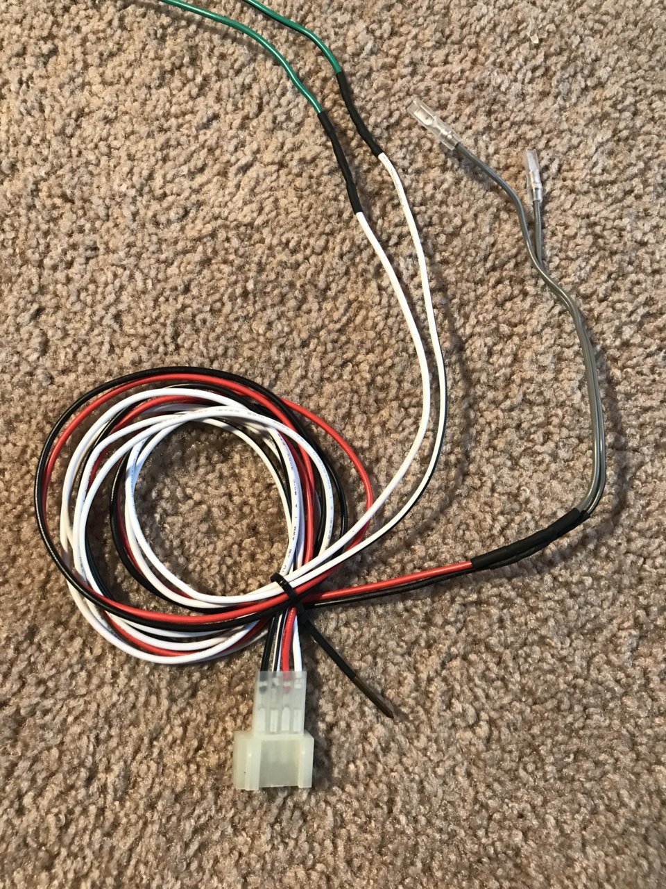

    Please take a look at my harness. This is wired for front component speakers using the active crossover Bi-Amp feature of the Key. The rear speakers will connect directly to the HU. A pair of TT tweeter harnesses (right,) have tweeter connectors spliced to the input wires and woofer outputs directly from the key spliced to the output wires (I’ll connect the door speakers to the stock plug.) There is an additional set of speaker wire (front L&R out of the Metra male) and a remote turn on wire(grey) exiting frame left for a Kicker Hideaway.
    *edits: for clarity
    stealthmode likes this.
  15. Jan 24, 2020 at 4:29 PM
    #55
    destin_meeks
    destin_meeks I used to fix people's crappy stereos
    Jul 14, 2017
    #223997
    3,940
    Destin
    Tuscaloosa, AL
    2017 SSM DoubleCab TRD Off-Road 4x4
    Post up a pic of one of the tweeter harnesses laid out. I see in my head what you’re plan is but I want to see what you actually did. I’m guessing the green/purple from the key go to the woofer wires in the connector. Then the 2nd pair of wires in that harness will get connected to your new tweeter? And that pair of wires will be fed by the factory wiring at the tweeter location, which is coming from the white/grey from the key.
    JonWB[QUOTED] likes this.

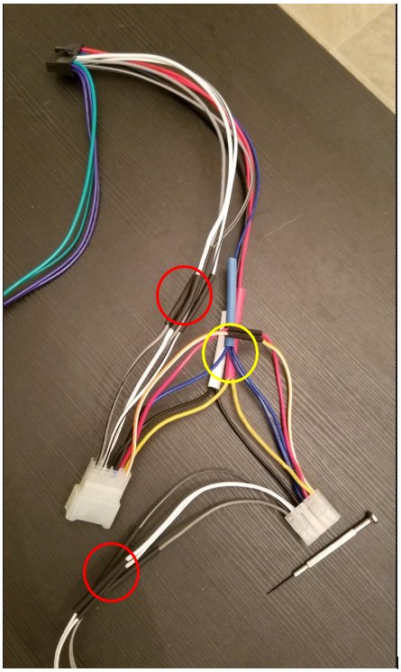

    If i want to prewire for a Kicker Hideaway subwoofer would I connect to the speaker wires where the red circles are and the blue remote wire where the yellow circle is?
  18. Feb 27, 2020 at 2:07 PM
    #58
    destin_meeks
    Jul 14, 2017
    #223997
    3,940
    Destin
    Tuscaloosa, AL
    you want the BOTTOM set of wires circled in red, NOT the top set.
    and yes, blue wire in yellow circle for remote turn-on
    Jeff Dartfrog[QUOTED] and JonWB like this.
