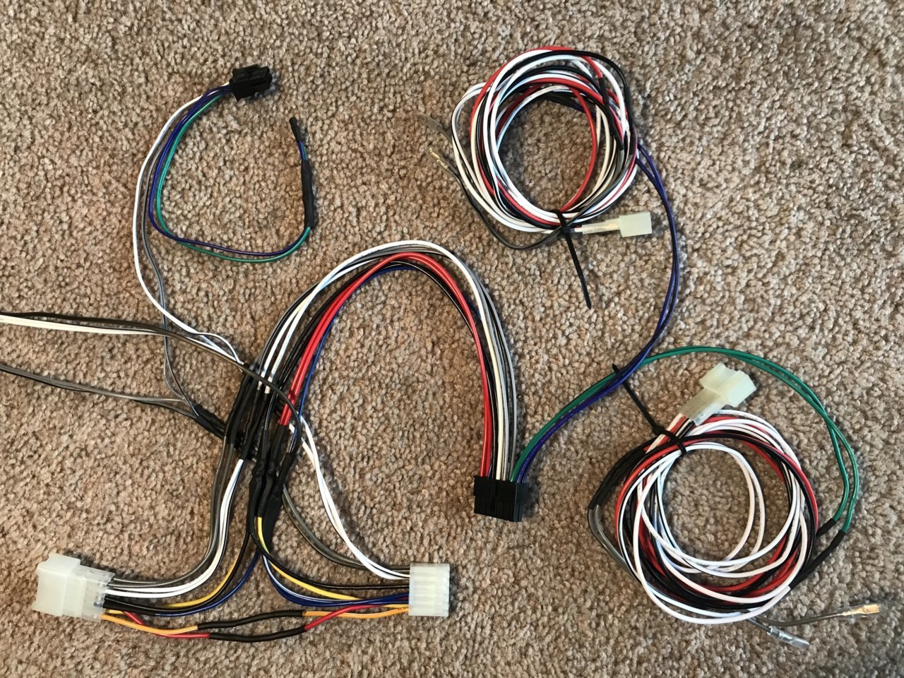

    BIG shout out to @destin_meeks ! If there ever were a more helpful member on TW, I haven't witnessed it. :cheers:
    2019 DC. Did the Subaru Kicker tweeter upgrade. Liked it. Did all 4 doors with Kicker CS (6x9/ 6-3/4). Liked it more. Needed more. Mainly bass/mid-bass and more volume. I had to have it over 40 volume to hear it on the road.
    Was just about to go the powered sub route because that's what most people say to fill in the bass. Decided on the Key 180.4 first (cheaper!) and mounting under the passenger seat in case I needed to add a sub later since there's more room under the driver's seat.
    I have no idea where you guys found room to stuff that sumbitch up behind the dash. Much less being able to access the gain adjustment and dip switches.
    With much help from Destin, I put together a T-harness for under-seat install. Grabbed some speed-wire from Crutchfield (20 ft.) and got busy. Here's the finished project.
    I decided to splice the front speaker RCA's that we cut off back into the harness on the input side just in case I wanted to add the sub later. Came out clean!
    After the Key auto-tuning and gain adjustment, I can say, I DON'T NEED A SUB!
    I had the Crutchfield CK12 amp install kit for power and ground. I wish I took more pics but it was hot AF.
    Also, the solid blue wire is not needed in pin 8. I soldered it thru before discussing with Destin. Remote amp turn-on is pin 9 Blue/white. You can run that down the amplified side of the speed wire on the blue wire
    Happy as hell. :dancingbacon:

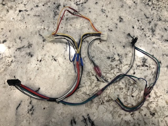

    So, I got my harness all wired up, plugged it all in and the PRT light comes on after 30 seconds or so of play. It will play for a few more seconds then PRT mode. This cycle continues.
    I have Hertz Audio 6x9s coax up front and Hertz 6 1/2 coax in the rear , both 4 ohms. The Subaru tweeters in the dash.
    I have it set to fader mode to run front and rear, are the tweeters dropping the impedance too low you think? Anyone else run 4 door speakers and dash tweeters off the key?
  12. Mar 24, 2020 at 7:01 AM
    #72
    orangeblue
    orangeblue Active Member

    Here is a pic of my harness

    Does it do this with no audio playing (music paused, volume all the way down, etc)

    I am driving 4 doors and tweeters off of it. No issues at all. All dip switches up as per Destin. The tweeters are in parallel with the front door speakers. What is a PRT light and where is it?

    edit: @destin_meeks
    Even with no audio signal it is going in and out of PRT mode. Even with the input side unplugged from the amp. Wondering if it’s not getting enough power?
    edit:
    Even with wire run to the battery it’s doing it still. Every 30 seconds or so , just cuts out for a few secs. Then starts playing again. Weird.
    edit: After checking every wire, checking every speaker, running new wire to the battery and making a new ground I think I have defective amp. I don't know what else it could be at this point.
