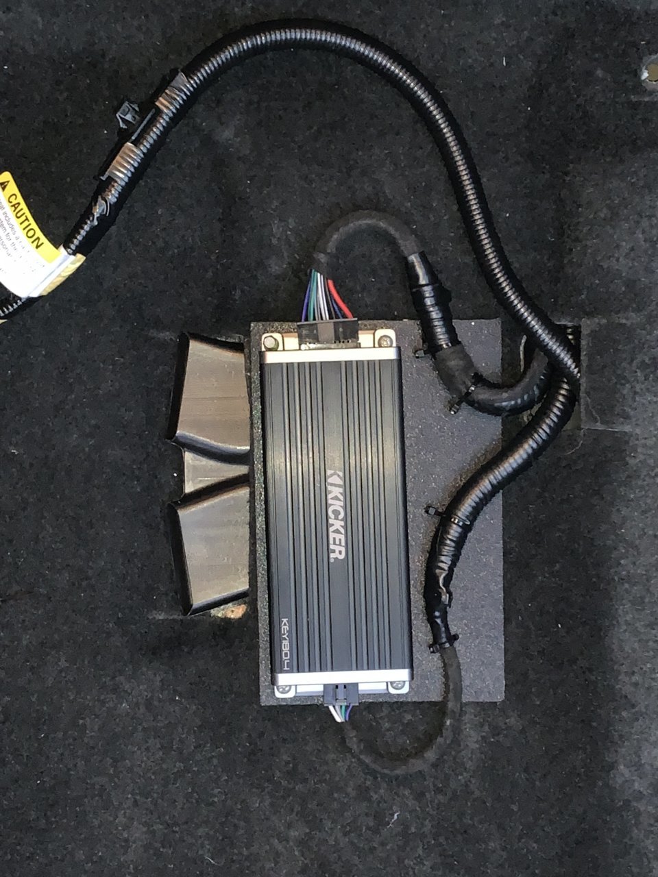

    2013 Tacoma TRD Offroad Access Cab MGM Supercharged
    Super clean. What did you use to mount the Key on?

    Got the harness done... forgot I wanted the line out and extra remote connection closer to the amp so I didn’t have to go behind the receiver again. Oh well I remembered at the end.

    Did you just splice in speaker wire to make it long enough to reach the back of the head unit?

    Two runs of stinger speed wire... got 20 feet off eBay for $20. I also ran my own power and ground outside in parallel with the harness.

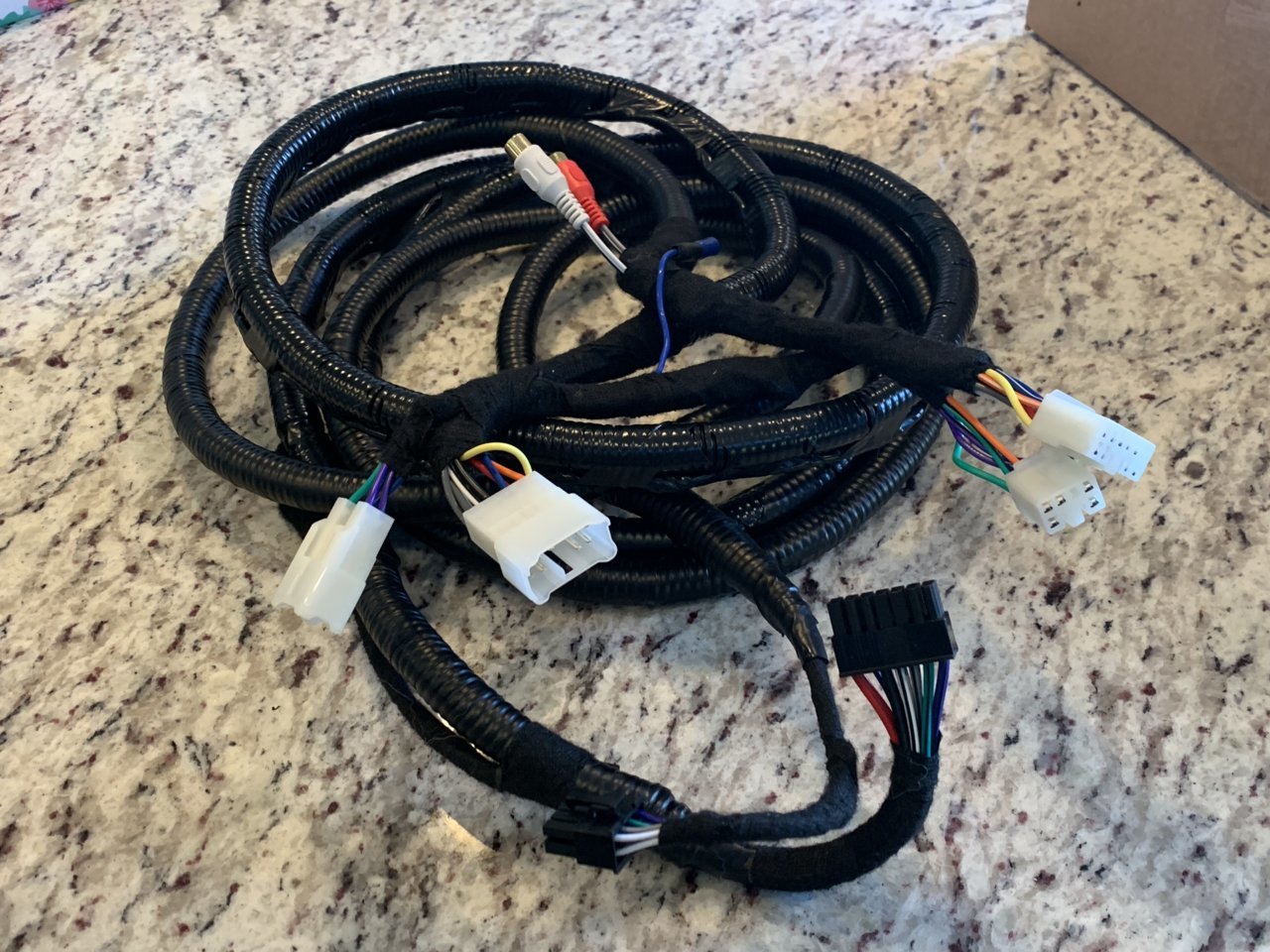

    Can anyone confirm if this is correct? I labeled the connectors in the pic.
    Also,I understand the use of the painters tape for mapping now.
