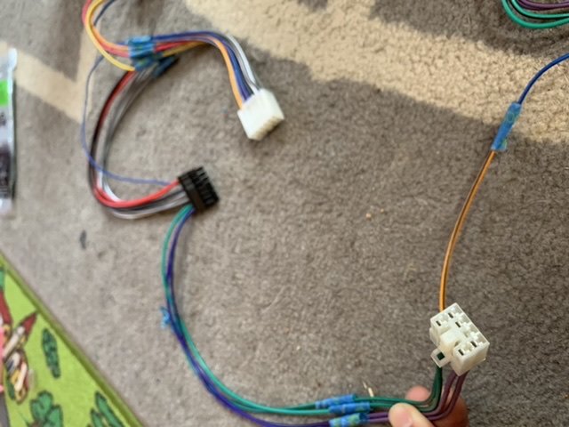

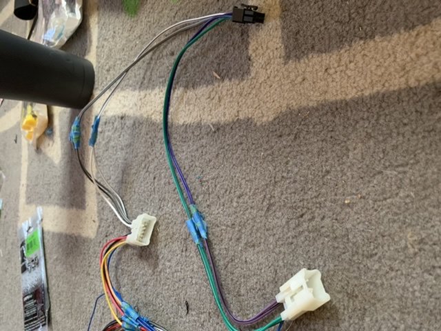

    That’s what I have here but I feel like you’re right and they should be swapped.
    First pic shows small kicker connected to metra males. second pic shows Large kicker connected to Metra females.
    917472F4-6043-4EA4-8657-06EFCA893A58.jpg FBA2B359-DDEA-4D23-A51C-F91ED8F17368.jpg

    If you’re describing your pics correctly in how you understand male vs female connectors, I think you’re backwards. You’re stereo isn’t going to be able to produce any power babies.
    You’re second pic appears to be a male Metra connector. Males go inside females, it’s really about preserving the species.
    Edit; good point by Destin, the pins can throw you off. Also, to clarify, my sarcasm wasn’t meant to sound dickish, just smart.

    As Shane mentioned above, you’re getting male and female swapped.
    In this industry, gender refers to the plastic connector, NOT the pins inside the connector. Easy mix up, and luckily you utilized the glorious painters tape and reached out for verification!

    Ahhh, got it. Thank you both for clarifying, much appreciated.
