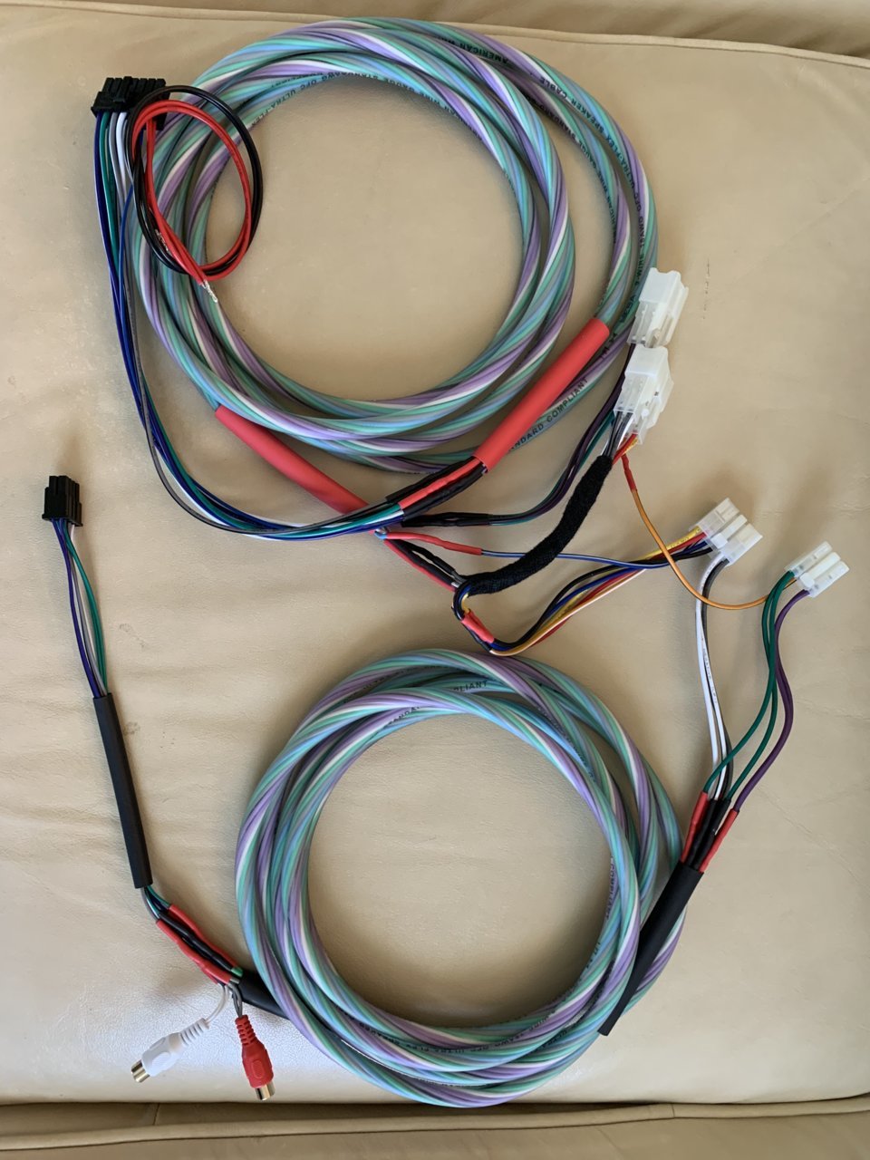

    I ordered 5 conductor speed wire, and already built the harness to tap into the key harness for my future Hideaway install. I had a burned out PC power supply and found it had blue, gray, and white wires to make the harness, I used the black ground wires to also make the speaker tap grounds. Also, the power supply had an orange wire that I used for my dimmer to blue jumper connection for my key harness. I'll most likely pull out the harness in the morning to redo it for the Hideaway prep. Also with tpp4's okay, I made a printable version of his harness guide in .pdf in case you want to do this at your workplace away from the computer.

    I wish I had done mine this way instead of the short t-harness and jamming it in my dash! Very nice work.

    Is there a reason to run the power & ground outside of the rest of the wires in the harness?

    Nope... personal preference. One of those things that if I ever need to get to it right away I can. My harness will last as long as my truck lol :thumbsup:

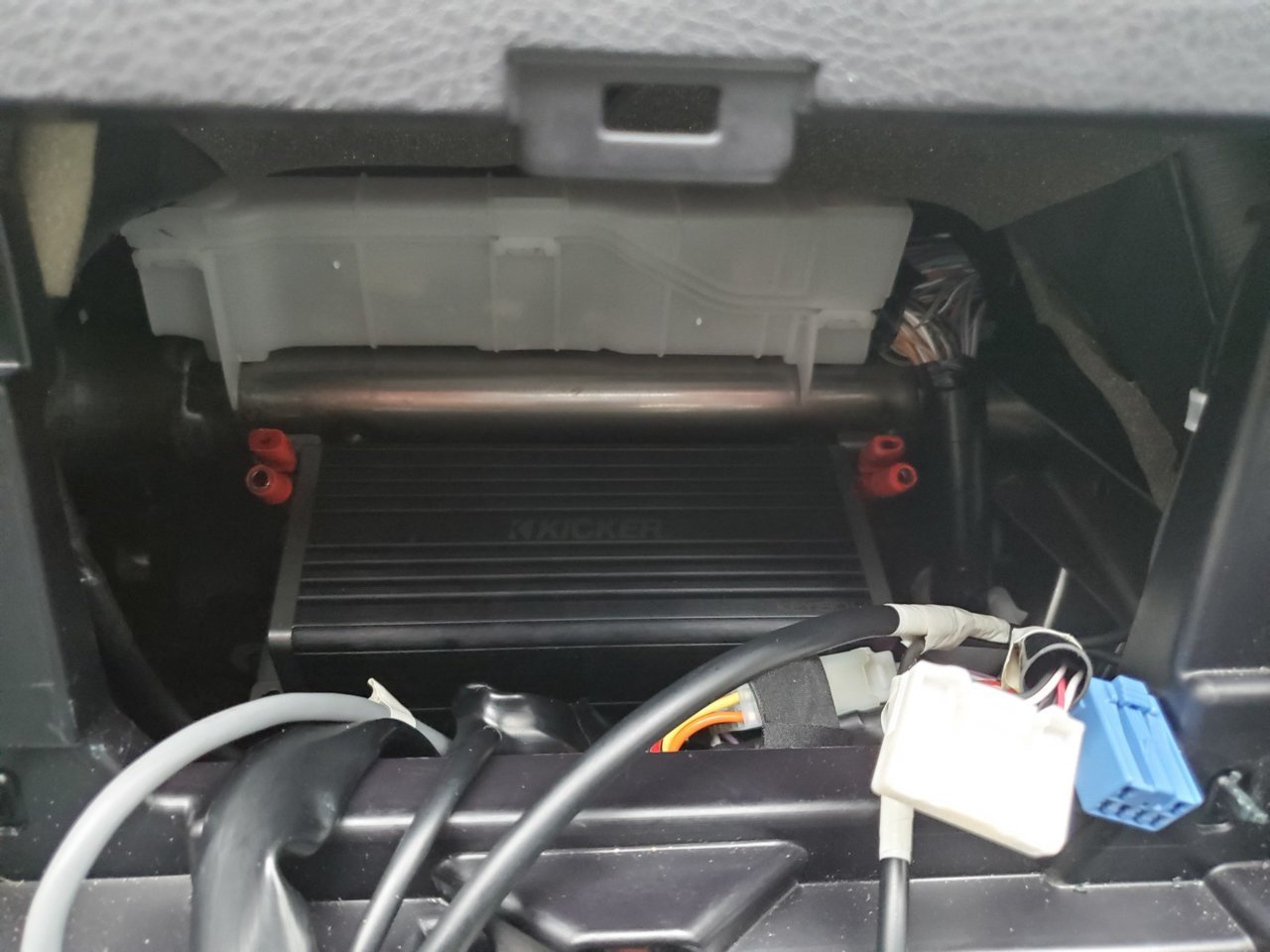

    I put mine behind/under the head unit, fits here nicely

    I’m wondering if the amp will get to hot to put behind the HU.

    Do you live in a hot climate? I have played mine and tried to break it... for science... It doesn't get that hot if your gains are properly set.

    There’s enough air space around it that it’s not a problem. It’s not right up against the HU, maybe 1-2 or inches under it
