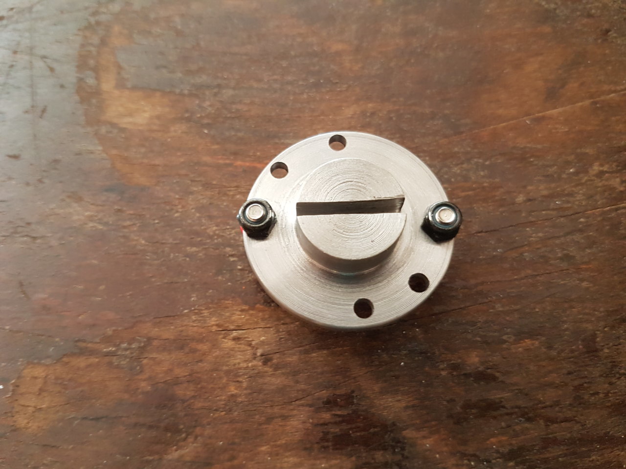

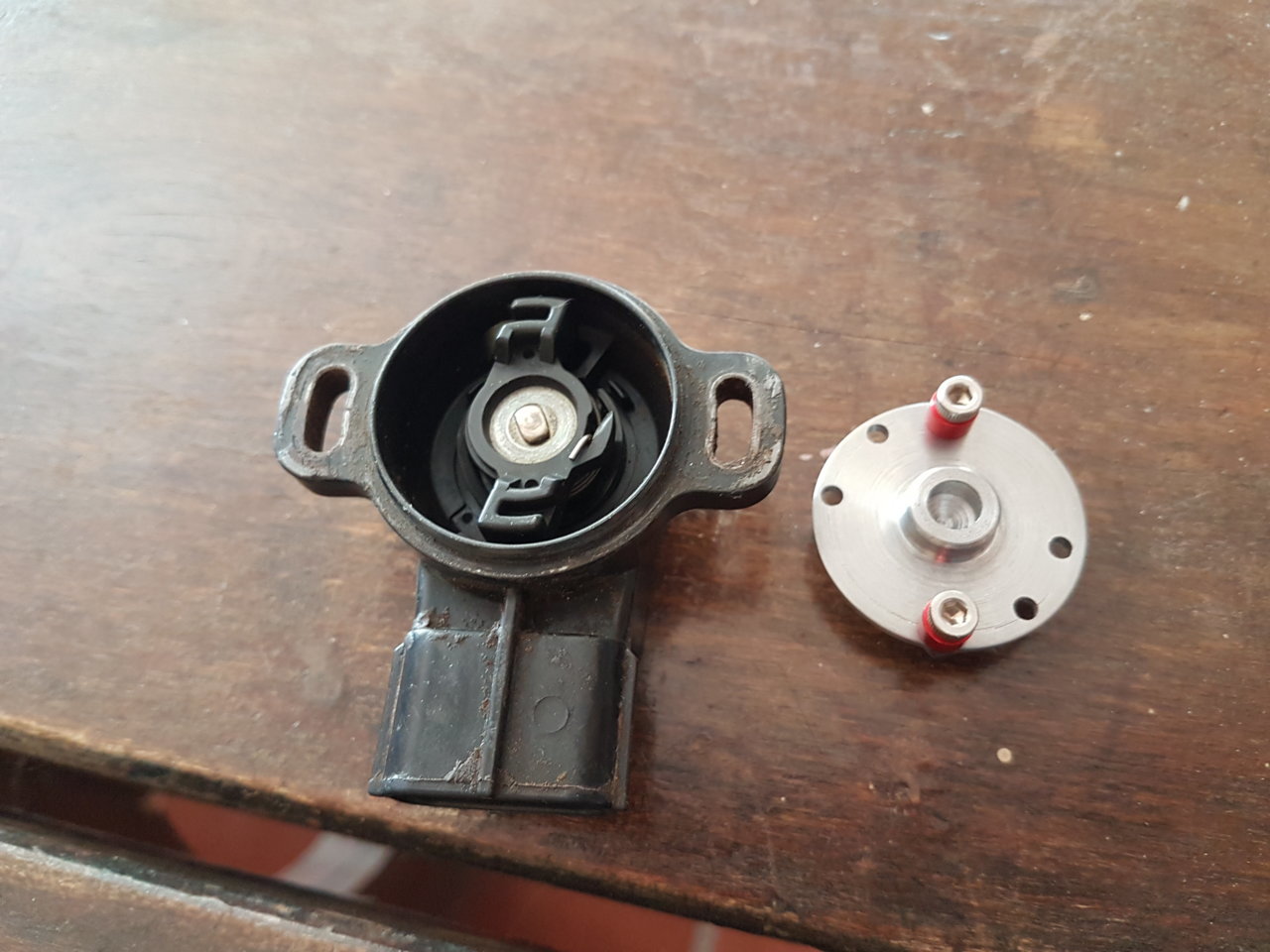

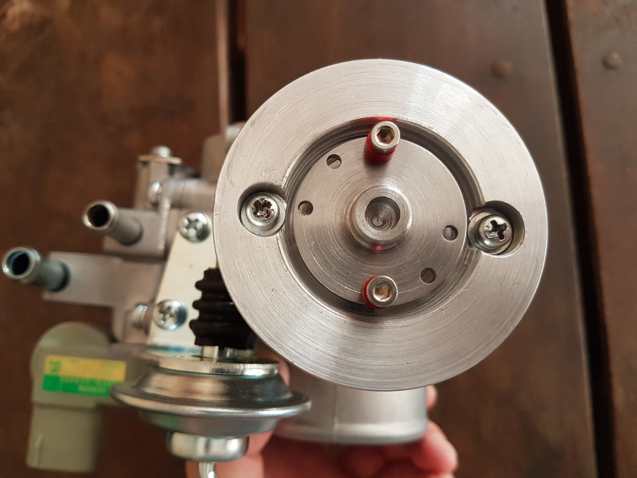

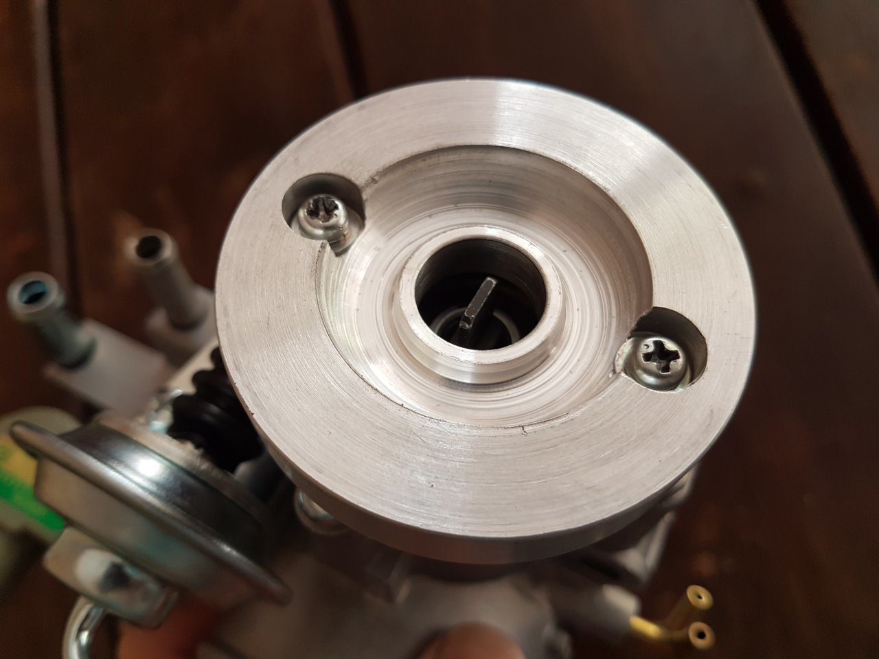

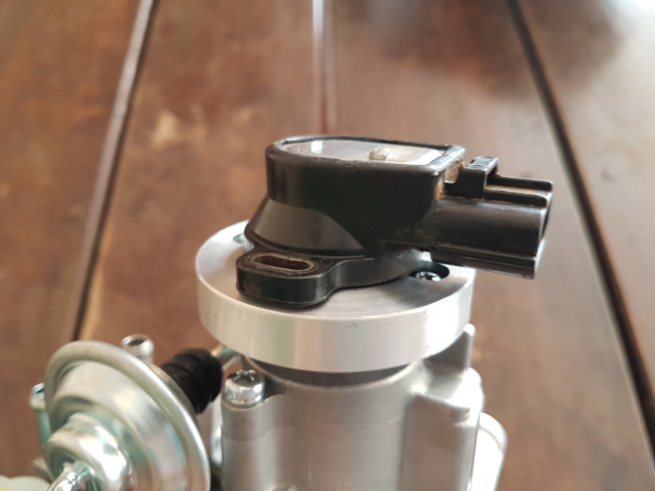

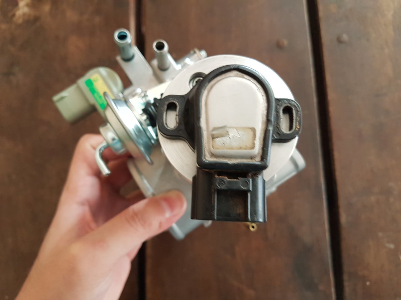

    well houston :cheers: we have good news, the adapter worked, it only requires patience to centralize tps.
    I received messages from people with the same problem that I had so I recommend them 100% it works
