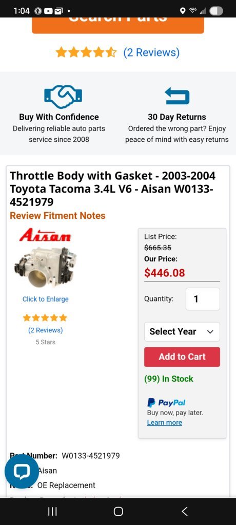

    Okay this is pointing me in the right direction. The other issue is have noticed is when I gave toyota my Vin they referenced wrong part numbers for my truck. When I gave them the part number from the image I found online they told me the sensors weren't placed on my truck or they were only installed on the Tundra.
