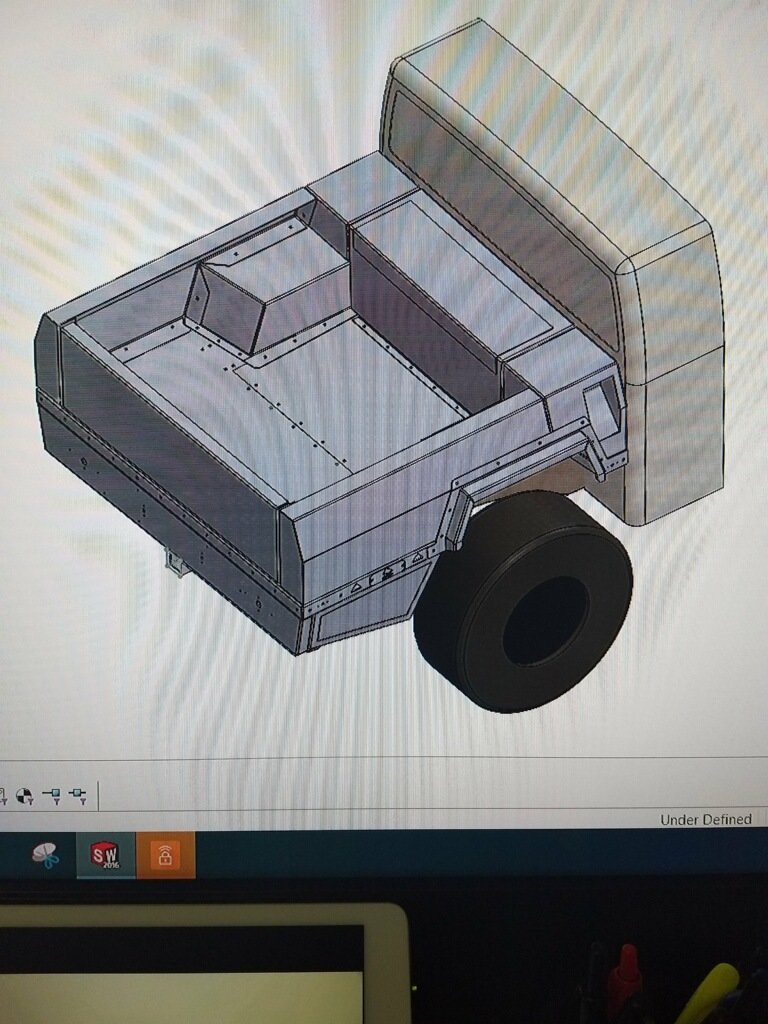

    I am still working through the bid process. I have a few targets I need to hit before I can comment on pricing. I will say that this has been a long road. And many different design languages have been scrapped before I settled on this one.
    My biggest hurdle in all of this is the manufacturing side of things. I was hoping to use a local shop to build these for me. Unfortunately for me(and fortunate for many on this forum) they are just too damn busy to take on this one. This has forced me out of my comfort zone and now I have to be willing to trust strangers with my baby, so to speak.
    This does not require the modification of your trucks frame. I know of a few flatbed manufacturers that have had some issues with collapsed mounting points due to the excessive loads being placed on them. My target customer isn’t the tray style insert campers like Lance or the like. However, the distance in between the wheel wells is factory spec and you could put a FWC Fleet on this. My target is more of the cap or shell or “Overlander” with accessories attached to the rack system. This has the floor width of full-size with the potential of midsize caps/shells being mounted to the bedsides.
    There is a lot to unpack with all of this. I have a headache rack/Tail rack designed w/ lateral bars that will accept mounted accessories like a bed rack system would. Or you could not opt for those but still have the bedsides and mount an aluminum cap on it. There is also a full canopy in design still. It’s hard to explain it all. I’d rather wait till I have something on my truck to show you all.

    Modular, yes. So modular that it can be packaged and shipped around the world on a 4x8’ pallet...
    Material is aluminum.
    I wish I could get someone with a longbed to commit to this so I could use their truck to verify dimensions and comparability with the frame.
    The basic flatbed would include the frame, deck plating, wheel wells and fuel boxes.
    Accessories include rear bumper w/hitch, laser cut birch baseplate, belly boxes, center box, bedside panels, headache rack, tail rack, lateral rack bars, detachable table, etc...

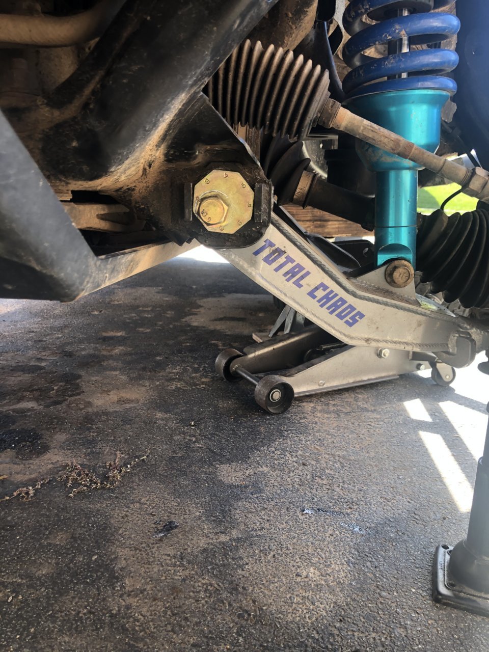

    I was able to get +6.1 caster, no more rub a dub dub.

    Thats all from the TC expedition series LCAs?
    You're running the standard TC UCAs right?

    I know you got all the other goodies, just referring to the caster. Nice to know the expos really do get you the extra 2 or so of caster like we were talking about recently.
