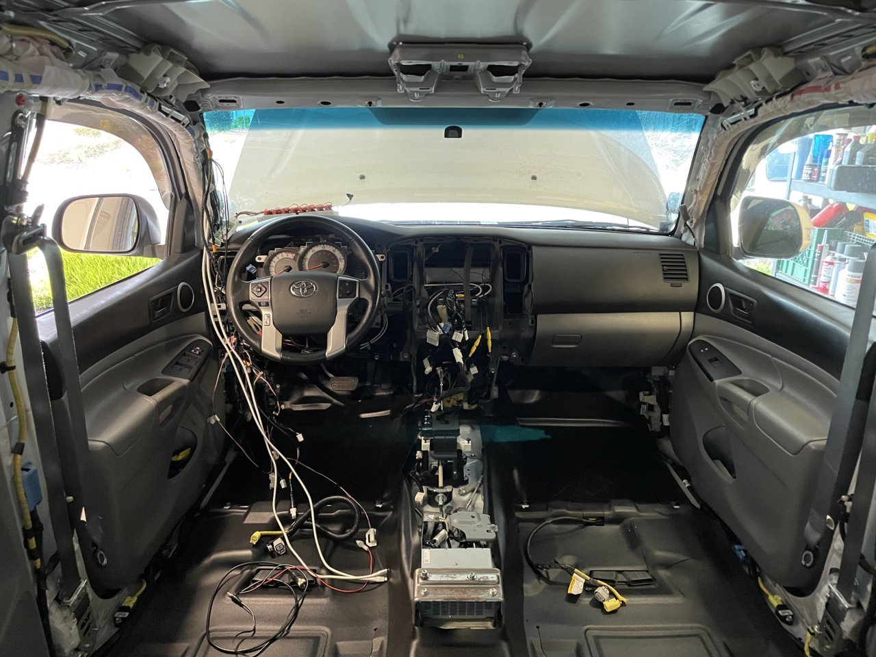

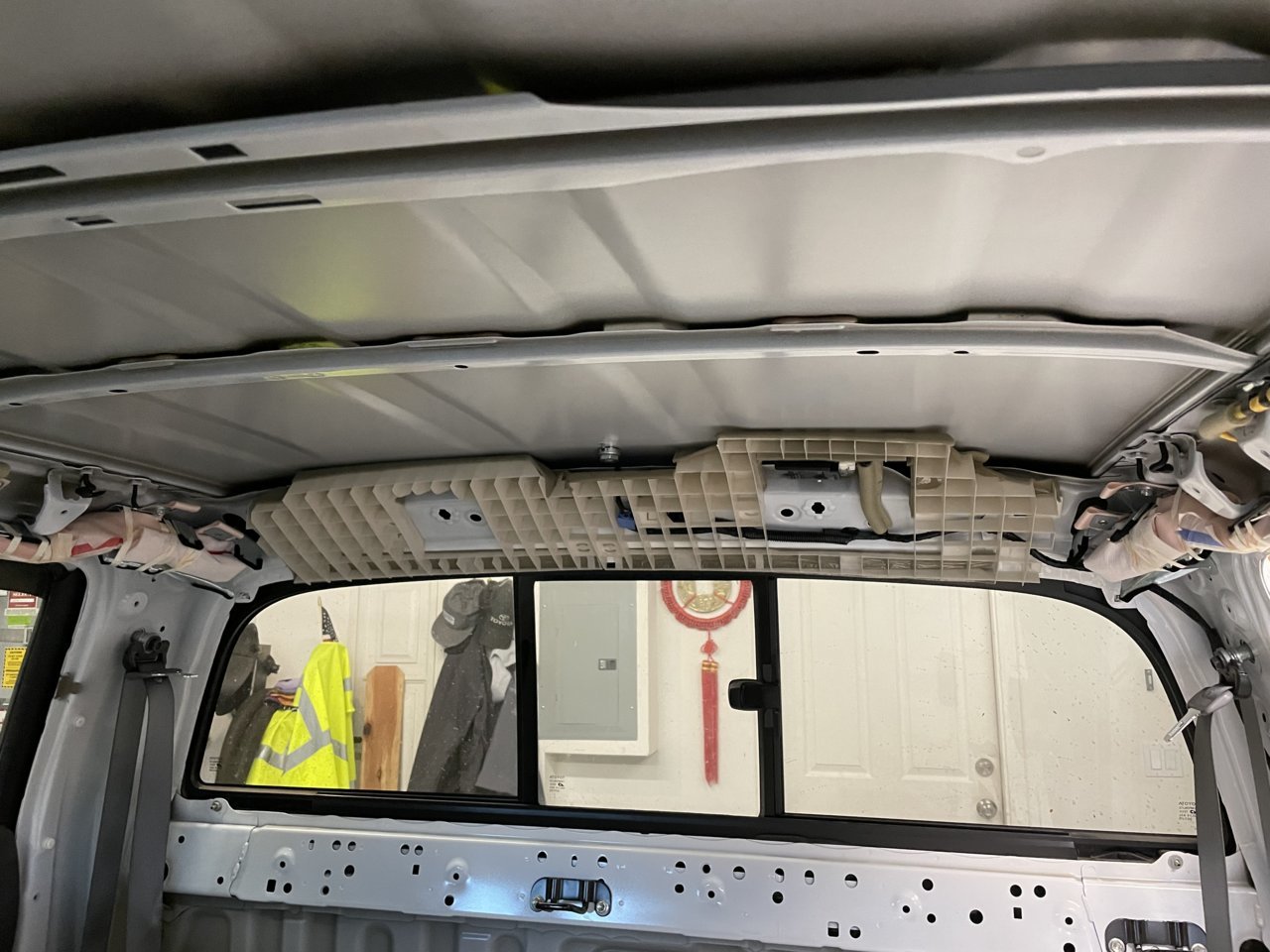

    It’s back in the garage after a few months at a buddy’s shop. We scanned the rear frame section and worked on a new rear crossmember design.
    And now I have the interior ripped out of it again...

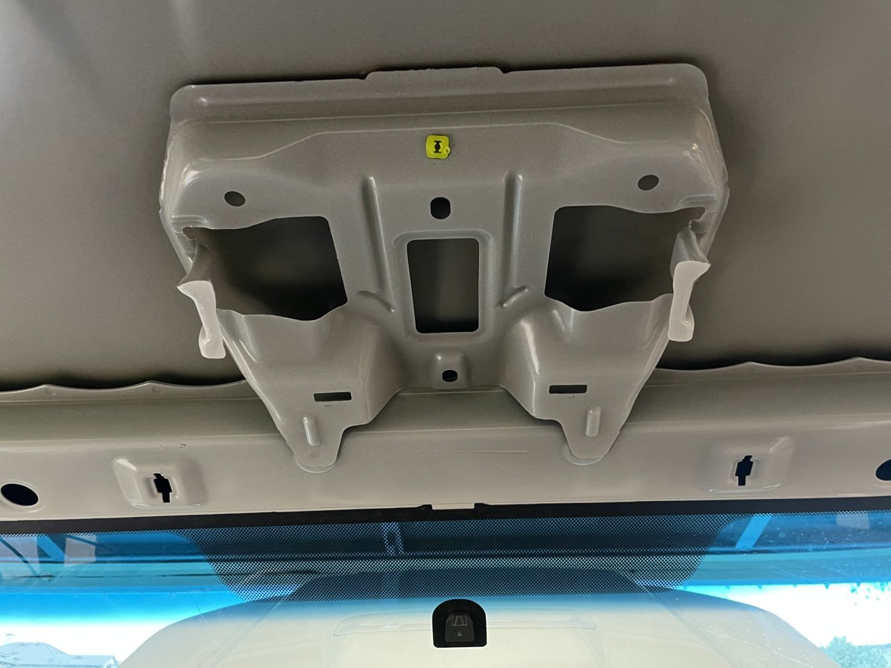

    Due to having a Drifter with a solid rear door(privacy issues), the rear view mirror becomes obsolete. I designed a solution to the tech-deck ergo problems. I mount an iPad where the rear view was. Plus it has integrated dashcam/go pro mounts.

    My delete is a metal plate with a 3D printed insert. You can use a ram ball mount or 67 designs ball mount. And then your arm/tablet mount. There is also an anti rattle arm that connects the top of your tablet as well. Hoping for a thorough test in the desert here in a couple of months.

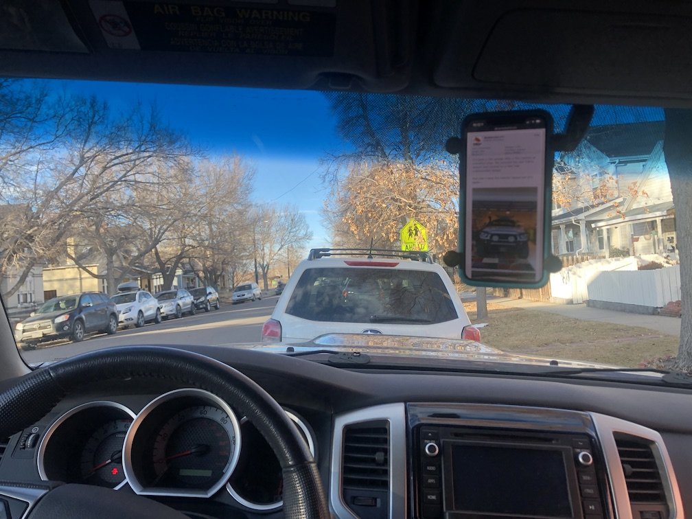

    The problem with most of these is that they are too wide and prevent you from using your visors without having to push the mirror way out of adjustment and twisting it to make it effectively less narrow.
    Like this?

    Mine is a full plate that attaches to the roof bracing. It’s a fully triangulated pieced that shouldn’t have any, if much, “slap”. You can run a tablet of your choice with my setup. I recommend an iPad mini.

    On my 1st gen, I got used to driving with only the side mirrors through the various shells and campers I had on it.
    Now I just have the rear view removed in the 2nd gen, but I do have the head unit with tailgate handle camera on the 2.5 gen...

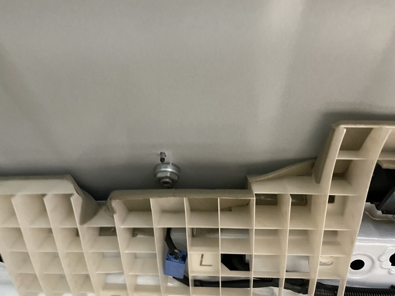

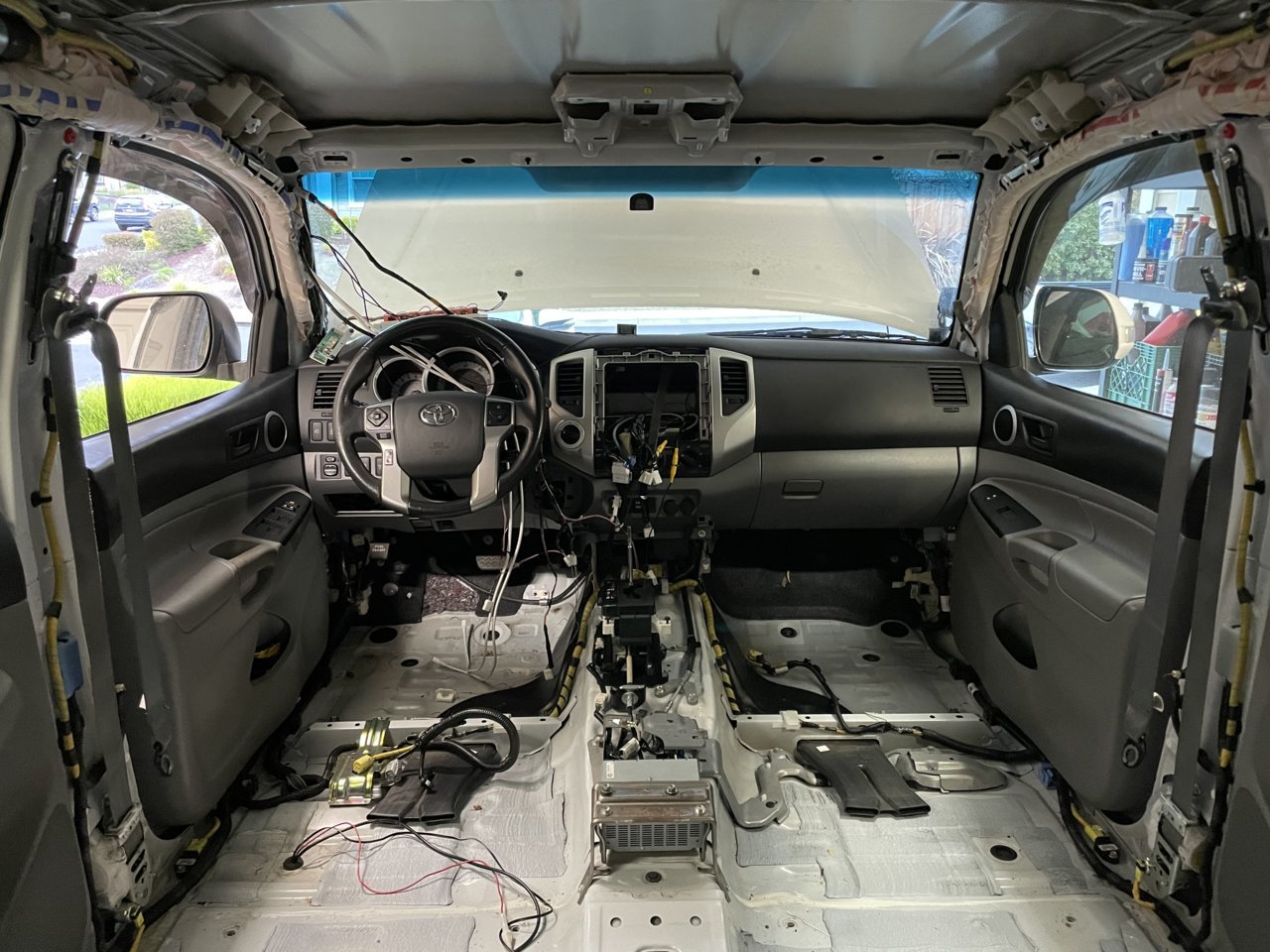

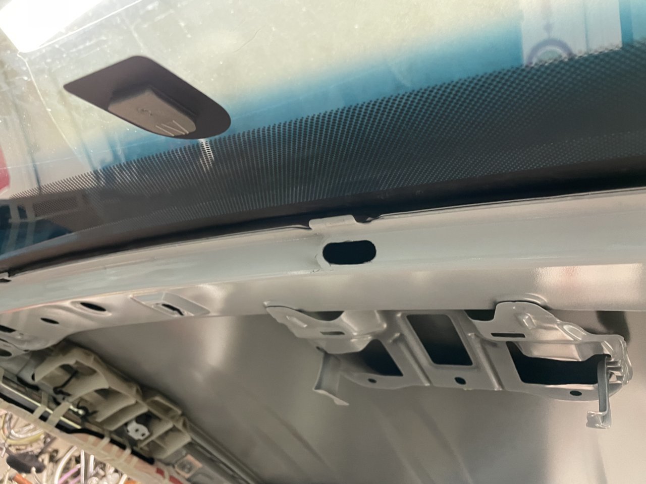

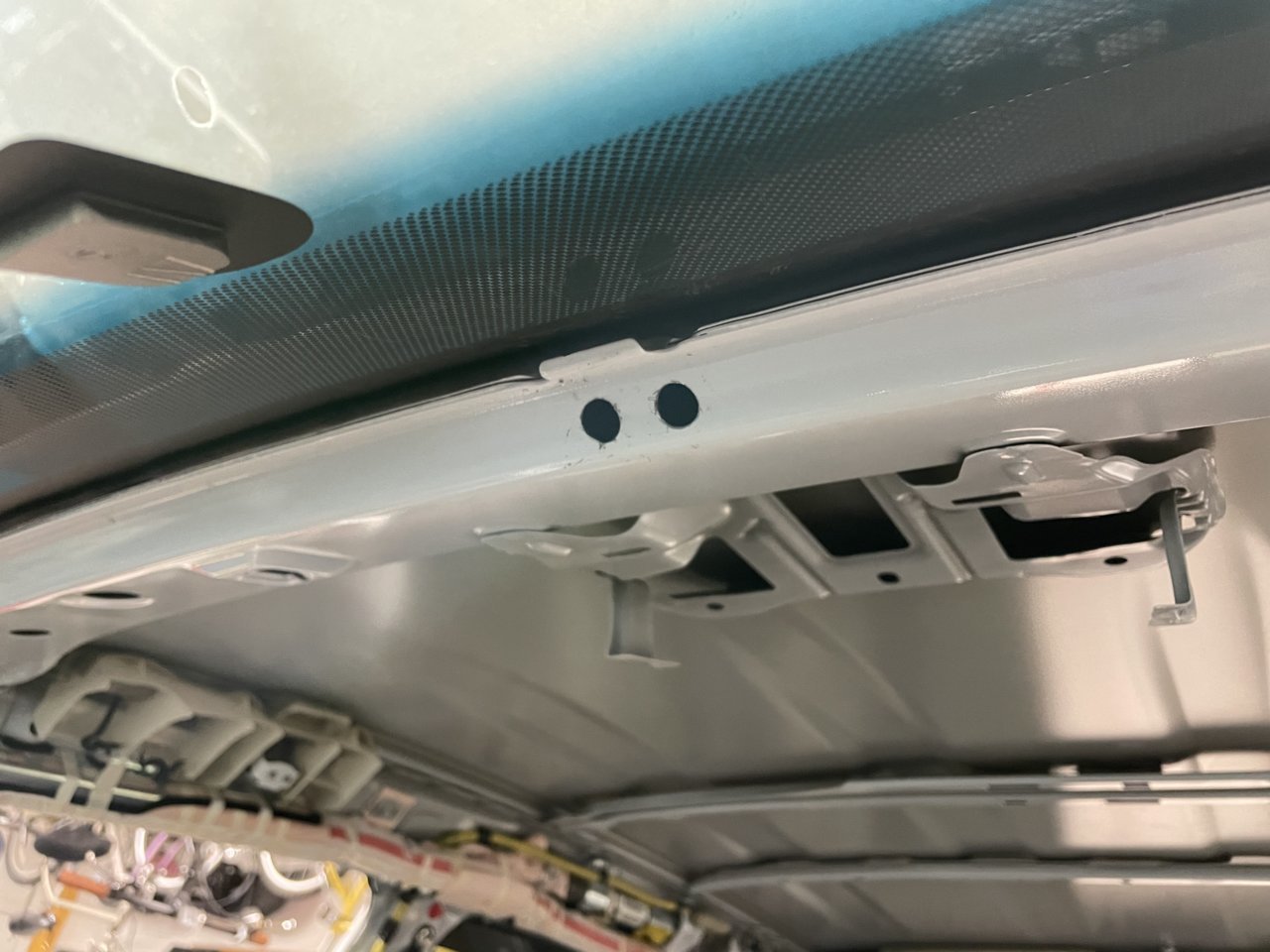

    I started in on re wiring the interior accessories and running power to the iPad, dash cam and the GoPro.
    Last year I installed an SPOD Bantam accessory switch system. It’s a great way to quickly organize your accessory switches. I opted for the carling switch model. The little screen doesn’t quite have the old rocker switch tactile feel.
    I also wanted to replace the carpet with the factory vinyl flooring.
    the entire interior was removed.
    The flooring was installed with the help of my 3.5 year old daughter.
    Time to drill some holes for cable routing.
    Time bust out the dremel.
    I slit a silicon vacuum hose to protect the cabling.
    The rear camera data/power cabling was routed through the roof of the cabin and out the rear grommet on the lower driver side of the cabin.
    More to come...
