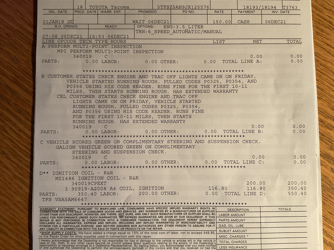

    Well, dropped it off at the dealer and they made their diagnosis. They said three bad coils in bank 2. Coils B,D and F. Tech said he checked all wiring and it looked good, said he also checked for intake leak (non found). Expressed my concern that about suspecting some other common denominator possibly affecting the coils; maybe failing ECM or injector (as I have been reading elsewhere).
    They ordered the coils ($657.00) and extended warranty should be covering it. I really hate for the error codes to return but have to wait and see. Parts should be here by 2:00pm and hopefully my truck will be done end of day.
    Truck drives fine until it's sufficiently warmed up and then it starts running rough sporadically. This morning it did just that; drove fine to the dealer (11 miles) and after I sat idling for approximately 20 minutes waiting for them to open, it started missing and running rough again.
    Why the coils fail after it's warmed up is the mystery. Why are the other coils not failing in bank 1? I wish he swapped the coils between the cylinder heads but apparently that's not how they are troubleshooting it. If it happens the next time, I will ask them to do that, to see if the error follows the coils in their new location.

    All fixed (I hope). Three new ignition coils installed on bank 2 ($350.40 and labor $200.00 = $550.40) All covered under extended warranty. Hope these last more than 18, 000 miles... Truck is purring like a kitten again.

    But the burning question is still 'why'?
    What you describe sounds most unusual.
    Glad it's running again........

    Did they pull and inspect plugs? All 3 coils failing on the same side seems like a clue to a cause. Supply power (all on same branch of harness/same sub harness?) or working too hard because plug problems or cylinder problems causing plug issues?

    I agree with you and Clearwater Bill. Besides confirming the PIDS I don't think the tech pulled the plugs or went further troubleshooting besides doing a visual check of the wiring. I'll certainly be bringing it back to them again if I see these codes pop up, and will push for more detailed troubleshooting.
    I am wondering too, if the ignition coils were actually fine but there is an issue with the wiring between them or the ECM. Why does the truck run fines and then sporadically run rough. If those ignition coils were certainly non functioning wouldn't the truck be running rough all of the time?
