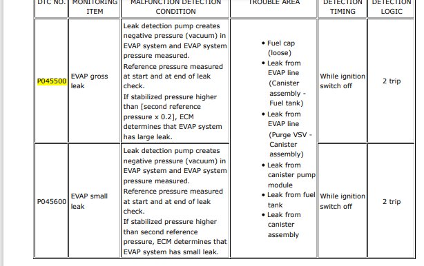

    Your codes a are not MAF related. You may need to troubleshoot the evap components
    BTW, OEM MAF doesn't cost $400. It is around $150-170.
    here are items for you code p0455
    here for the other p0441
  3. Feb 9, 2024 at 9:03 PM
