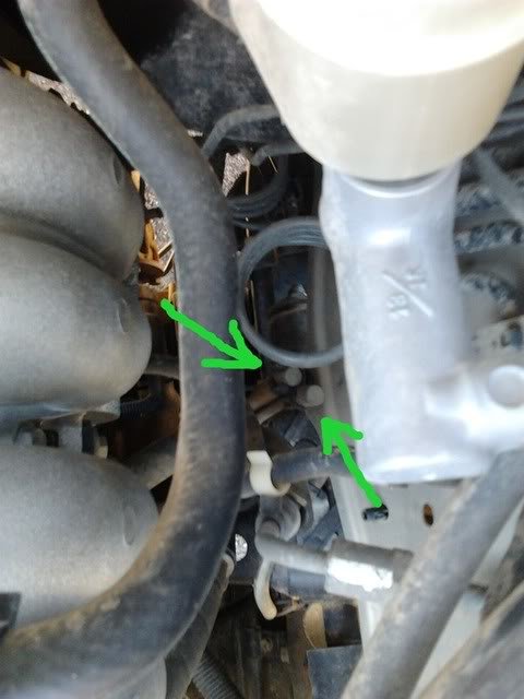

    I just saw another thread suggesting that gear oil could be pumping out of the front diff. breather and or grease flying off of the front yoke onto the exhaust?

    That doesn't not sound like a good thing... If it is happening you should see oil around the breather. The front diff breather is under the hood.
    Here's the best pic of them I could searching around a little... This is on the drivers side of the motor compartment
