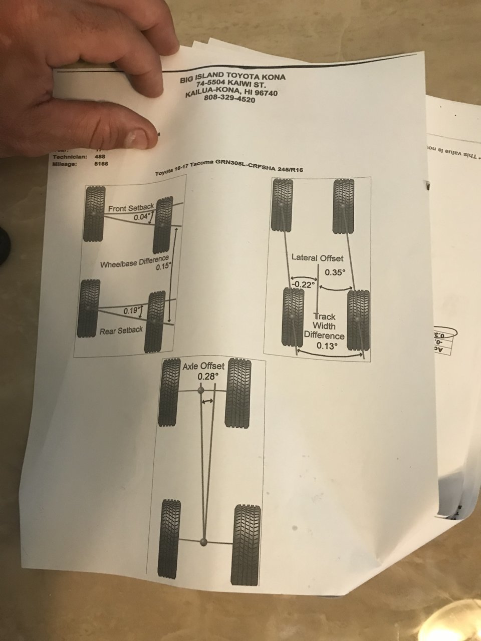

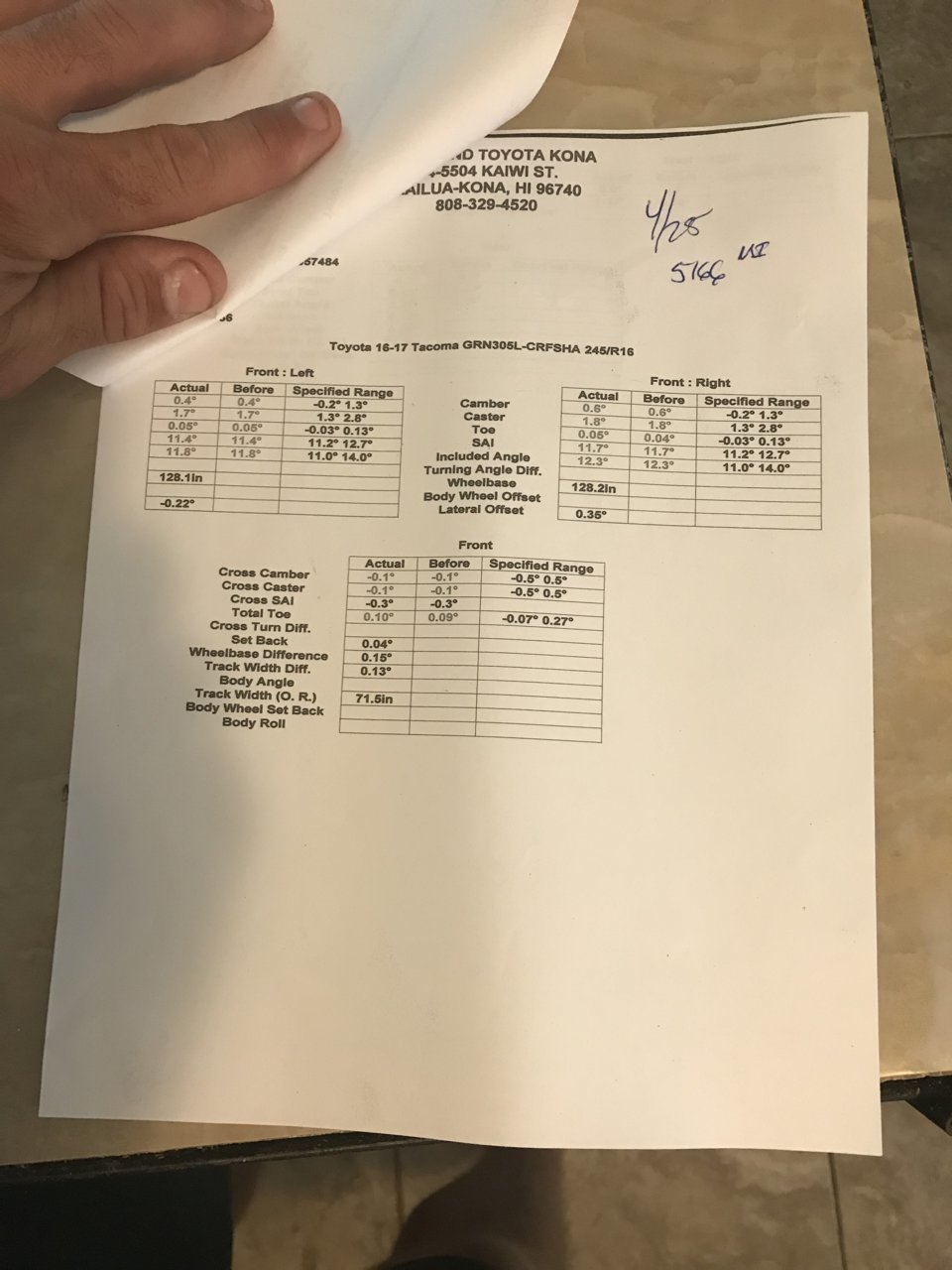

    Here are the number please help

    Looks like your frame has 'diamond'.

    The 6th picture you posted sort of says it all.
    I'd take it a collision wheel alignment shop to verify.

    Bad news can’t correct that with alignment need a big ass hammer...numbers indicate a twist happens when you run into a ditch too fast.

    Caster, camber and toe are within spec....
    SAI and included are technically within spec, but you have some side-to-side deviation. This is indicative of bent or worn parts.
    There is no specified range for your passenger side set back, lateral offset and thrust angle; but they are 'off'.
