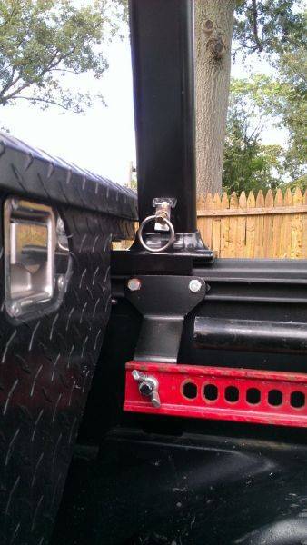

    So I turned my front rack around removed the front bed rail for max clearance and bed space
    Tool box mounts right into the 3/8" standard threaded holes on top of the brackets. Each bracket has one. They also give you two additional brackets should your tool box be more than 12" deep. I didn't need them.
    still plenty of room for the hi lift

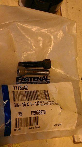

    I recommend swapping out the bed clamp bolts. They suck and are to long due to being universal. Use stainless 3/8" - 16 x 1-1/2" Hex heads

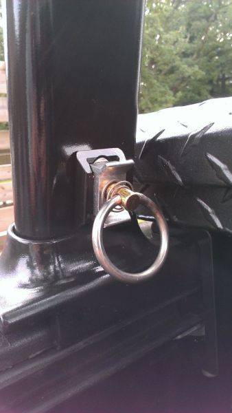

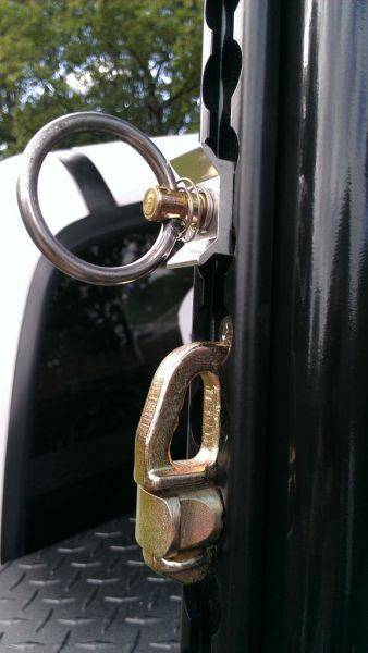

    Recent mods.....

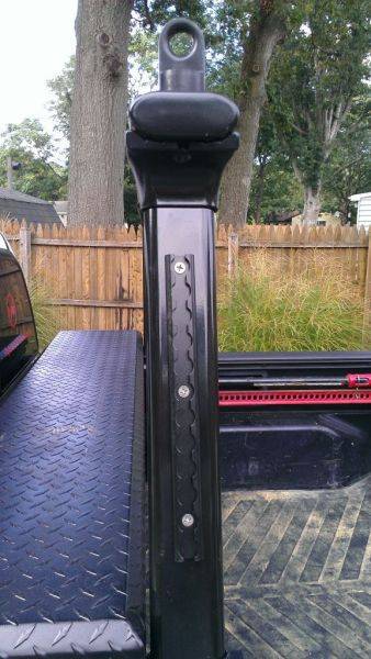

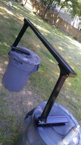

    Sanded/primed/painted black
    added 1' of airline/"L" track to each outside vertical

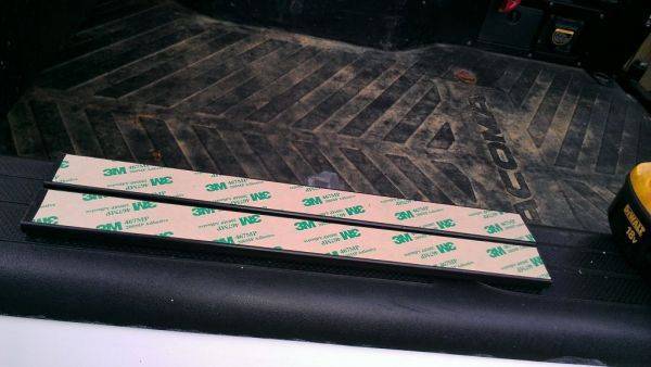

    I put some great 3m tape on them so there wasn't metal to metal contact and to help hold them.

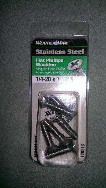

    used 1/4-20 tap
    1/4-20 x 1" stainless screws
    you can get all kinds of fittings but I chose these for my uses
    Added single pc of L track to each lower inside corner for strapping stuff into the bed or in the middle of the rack.
    Be sure to Loctite everything and you should be good to go.

    Thanks. No the paint will not hold up. The original powder coat didn't either. The yaks wore down to raw aluminum. I didn't post it yet because I didn't take pics, but on the front in the middle I didn't paint it and put down rubber roof flashing. I just painted the rear today so in a day or two when it's cured Ill do that one and take pics. I looked all over for a good rubber and even got some 1" x 4' strips I was going to glue down. One day I was walking by my tape shelf and saw the flashing and a light went off so I said screw glue and rubber just use the easy stuff.
    Powdercoat & crappy at that. I got pics of it bubbling up on my camera Ill post when I'm done with the rear rack. I sanded the bubbles down and primer/filled them before paint.
    I know it won't hold up with tree's scraping it up, but a touch up every year or so is easy now.

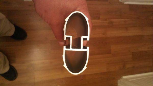

    What's the width of the track on the top of the bars , looks like it's the same as my DeWalt ProRac on my cap
  17. Sep 17, 2013 at 6:28 PM
    #17
    XXXX
    XXXX [OP] Well-Known Member
    Sep 1, 2011
    #62715
    20,904
    sKiP
    05 Prius
    exactly 4" at it's widest
    very possible to have a similar extrusion die used for both products.

    Sorry , I meant the actual T slot track
  20. Sep 17, 2013 at 6:39 PM
    #20
    XXXX
    Sep 1, 2011
    #62715
    20,904
    sKiP
    05 Prius
    11/16"W x 1/4"H ID with a 3/8" wide slot
