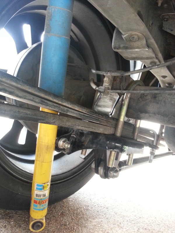

    I have the Caltracs. And yes, they do limit travel, but in my case, that is just fine. I never fully liked the bud built because the front mounting location, next to the carrier bearing, isn't very strong. Not for the forces going on at the axle. As well as the fact that many people have had bolt hole alignment issues. Even though a drill would solve that.
    Having something custom to aid in inhibiting axle wrap and lateral movement would be awesome. Custom though as well. Something like the two triangulated link bars of a 4-link setup. From the spring perches to near the center of the axle. Attached in a similar manner as the Caltracs.
    There is a member on XRU and the FJ forums, FJLED, who has opened a bad ass custom fab shop, for extreme off-roadists, here in Houston. His FJ is ridiculously built. His fabricator, is who would be good to come up with the proper solution, in the available space constraints.

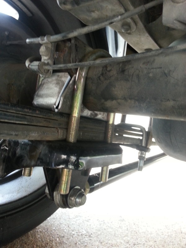

    I have a U-bolt flip kit, but it was something I pieced together. Which brand U-bolt flip kit do you have?
    Those are the Caltrac XR lowers, XR U-bolts, inch(?) longer trac bars, and 2-hole front perch brackets.
    For your setup, you'd need to swap out the TR axle perch for the Caltrac one, or the one that Voodoo has, as well as add a block back under there, to get back to the height that the TR axle perch.

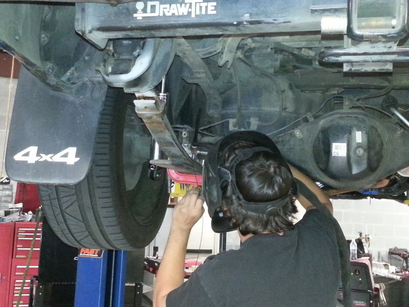

    Also, definitely had to weld up these Caltrac axle perches. Otherwise they would flex way to easily. And that was unsafe.
