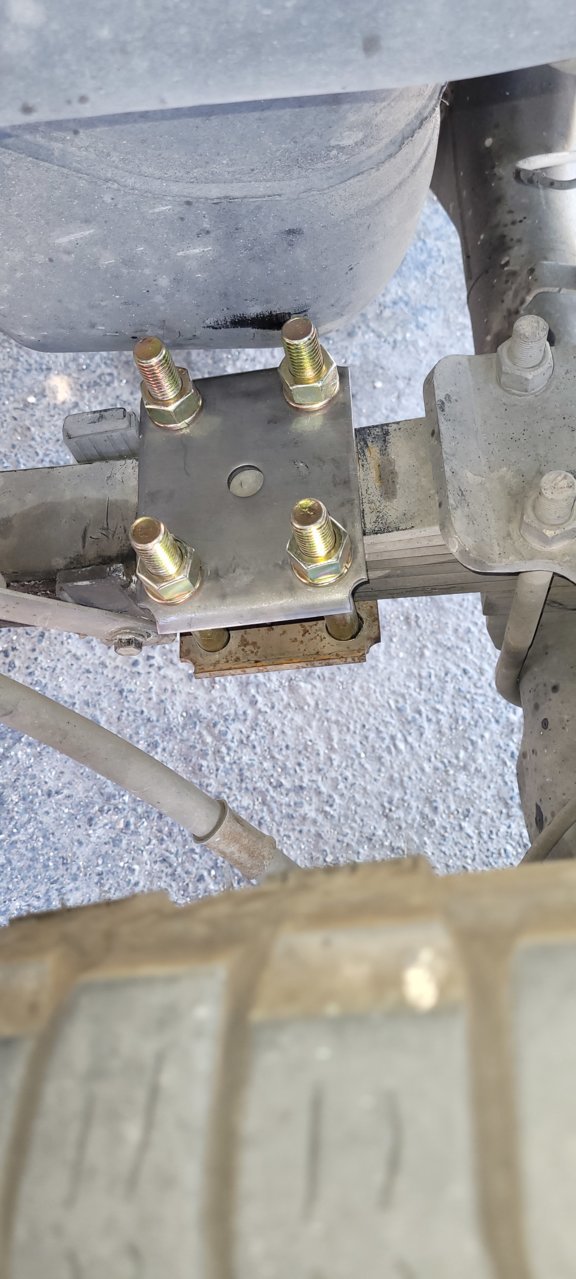

    There is a YouTube video on how to limit axle wrap.
    I did something similar to the video, and as soon as I left the driveway I felt this simple mod working, and much less axle wrap. I did this in hopes of extending the life of these wimpy carrier bearings. (just replaced) I'll post a pic in a bit...

    it's simple and cheap for now, just to see or feel how if it makes a difference or not. I feel something g different.. Lol.

    of course, I used leaf spring perches for now, but it's working... Trim work is coming soon; the are 5" bolts. Maybe 4" will better suit...
