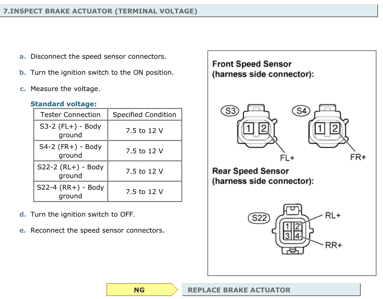

    Take a good look at the right rear speed sensor.
    A scan tool is handy, as it will tell you if the sensor is reading correctly.
    You can also try the below to see where the problem is

    So pulled the connector on the right rear side and there isn't voltage at either of the two pins. Came back to look at this diagram and I noticed it says to check it at the 4 pin connector. That's at the brake actuator? I'm not sure where the actuator is.

    I think the 4 pin connector maybe be back by the center of the rear axle.

    Ya, the 4 pin is just over the pumpkin.
    That's where the problem was. I'd extended the rear axle breather via a tube up to the bed storage box. I had routed the tube around the wiring bracket and it had slid off the bracket onto the wiring harness. Of course it sat between the sheath and the plastic connector, slowly rubbing directly on the wire. :rolleyes: Wore completely through the copper, but not the sheath.
    So I spliced in a 1" length of wire, twisting and soldering the ends. Coated the whole thing with some liquid electrical tape and then slid a piece of shrink tubing over the whole thing. I'm hoping the liquid will fill any gaps in the shrink tube.
    I'm giving it a couple of hours for the liquid tape to seal, then I'll go back out and put it all back together. Hope it works:fingerscrossed:
