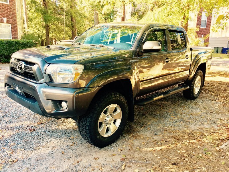

    What's up fellow awesome people. I put 2.5 strut spacers on the front and 1.5 block on the back over the weekend. Now the traction control/abs lights stay on. I purchased new 265/70/17 tires and got the alignment. The technician said he doesn't have the means to reset the steering angle sensor. I'm worried Isnapped an abs line during the lift. You guys have any tips or help? I'm all ears.
