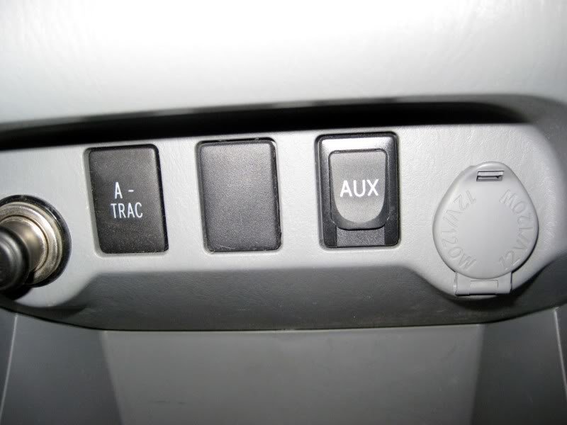

    But, out of curiosity sake so I can catch up with you... please show me where my A-Trac button is.
    The 2015 Tacoma owner's manual has a section for Auto LSD and A-Trac. Both say you'll have a specific button. I do not have an A-Trac button. Only the VSC/Auto LSD button (vehicle with squiggles).

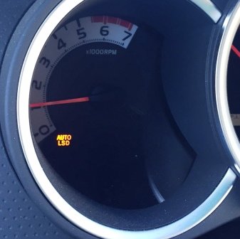

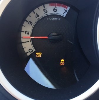

    Ok I've been reading even more of the VSC / Auto LSD / TRAC threads here and it's still not adding up.
    Here's a good summary:
    @Kyitty doesn't that mean I have a locking diff AND limited slip (even though they can't work at the same time)?
    When I hit the traction control button on the dash, Auto LSD lights up full-time and VSC goes on and off at seemingly random times.
    Auto LSD should be applying the brake to the spinning wheel, sending torque to the opposite wheel.
    And that's the issue: it isn't happening.

    You can have a locker and Toyota's "Auto LSD" at the same time. You can't have a locker and a true limited slip differential at the same time. Toyota's "Auto LSD" is traditionally called "traction control" and yes, it should be helping you when you spin your tires while accelerating.
    Have you compared performance with and without the "Auto LSD" activated? Light em up at a stop sign with it on and again with it off. It's possible that it's helping you somewhat but you're still slipping a bit, this should reveal if that's the case.
