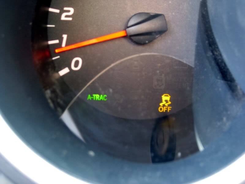

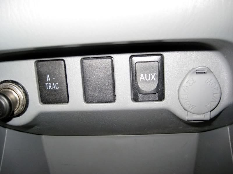

    You need a Tacoma with this button for A-TRAC:
    Then this lights up:
