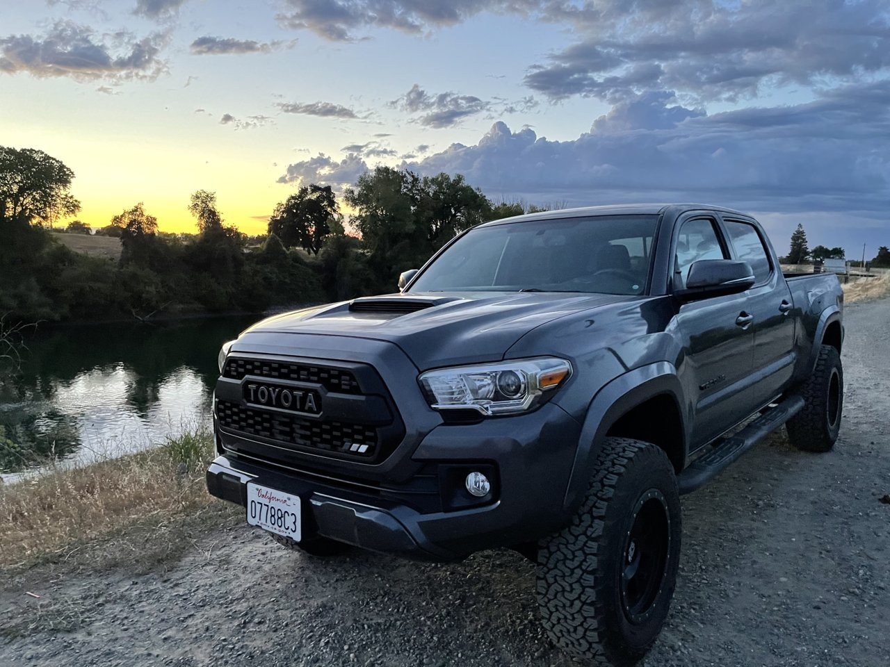

    Yes I have a 3 inch leveling kit

  12. Dec 29, 2021 at 8:49 PM
    #32
    GrundleJuice
    GrundleJuice Well-Known Member
    Mar 15, 2015
    #150931
    2,346
    Michigan
    2016 TRD Bro
    [S]Un-Molested[/S] Lightly Molested
    That size only comes in E load according to bf Goodrich. 38 is probably ok for a stock weight truck. Could probably go down a psi or two in the rear

  14. Dec 29, 2021 at 8:52 PM
    #34
    GrundleJuice
    Mar 15, 2015
    #150931
    2,346
    Michigan
    2016 TRD Bro
    Spacers?
  15. Dec 29, 2021 at 8:53 PM
    #35
    dannwil2000
    dannwil2000 [OP] Member
    Sep 18, 2021
    #377415
    20
    2017 Tacoma TRD Sport
    No my KMC wheels came with a half inch offset
  16. Dec 29, 2021 at 8:54 PM
    #36
    GrundleJuice
    Mar 15, 2015
    #150931
    2,346
    Michigan
    2016 TRD Bro
    No, I meant shock/leaf spacers for the lift?
  17. Dec 29, 2021 at 8:57 PM
    #37
    dannwil2000
    Sep 18, 2021
    #377415
    20
    Oh mb, no I went with the rough country shock and strut lift(Ik I cheaped out don’t be mad) and it came with leaf spring spacers but I just ordered new Old man emu leaf springs to get rid of them
  18. Dec 29, 2021 at 9:00 PM
    #38
    GrundleJuice
    Mar 15, 2015
    #150931
    2,346
    Michigan
    2016 TRD Bro
    Besides checking that install was done correctly and thrust angle is straight it's probably worth getting vsc calibrated like had been mentioned.
