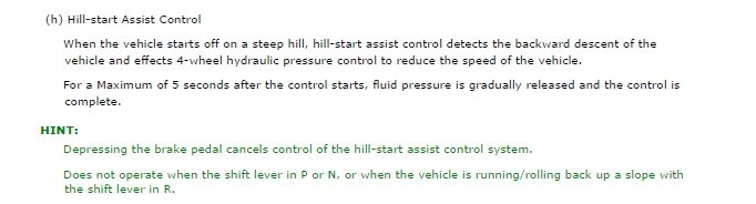

    2016 TRD OFFROAD DCSB MGM
    Hill start assist is active when the brake is released and no throttle. It gradually releases brake pressure over a 5 second period. Slip indicator flashing is normal; it indicates VSC is active. Solid slip indicator light would be a malfunction
