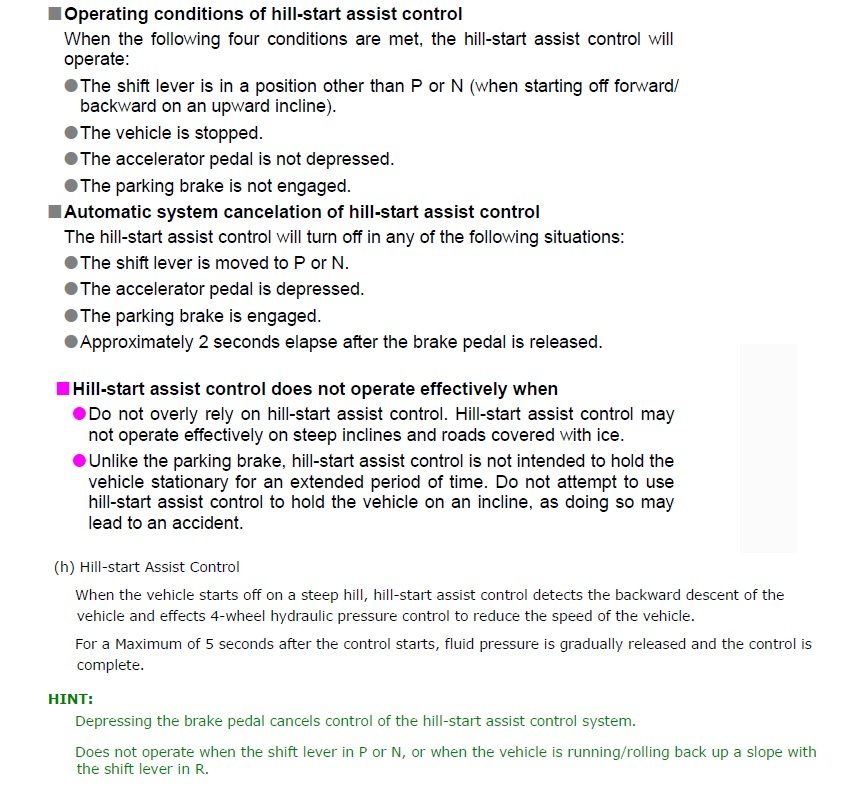

    If your truck is rolling back then the hill holder is not active. Hill holder retains the brake pressure for a couple seconds or until forward movement is detected.
    My MT equipped truck has hill holder active regardless of transfer case settings. If the hill is steep enough, it will engage. I have never driven an AT version of the truck so I do not know if you have hill holder or not. It would be a matter of how Toyota programmed the truck. All the pieces that are needed to activate hill holder are there and the same regardless of the truck.
    Also a side note, the hill holder only holds uphill, not downhill. If that isn't obvious.

    It's supposed to do that. It's hill assist not holder. It's only supposed to be active for a little bit. The thing you are hearing from what I have researched is the brakes cycling on and off. The computer is trying to figure out what you want it to do. Either roll back or maintain so instead it slows the roll down. The reason why it does it when you step on it again is because of the throttle delay (lot's of topic here on that dumb accelerate by wire tune). So when you let the accelerator off; it holds it for a bit, but when you step on the pedal again, the throttle takes a bit to kick in/register so the hill assist lets go and does a "control" roll back.

    It's not suppose go forward unless you regear and increase torque.
    Its HILL ASSIST. Suppose to give you time to let go of the brake and transition to gas pedal so it's only active for that split second. If you don't go for the gas pedal or take too long, its suppose to go backwards, but will try to slow the descent (ie. not a free gear decent like you would have sticking it neutral).

    I have the 2018 Sport and it has a vacuum brake booster and works quietly. Stop on the hill over a certain degree of slope, take foot off brake and the truck stays put for around 2 seconds or so or until you give it gas, then the brakes release. No rolling back and no noise. The OR has an electric brake booster that works differently than the vacuum booster. I've been in the OR on the same degree hill, let go of the brake and the vehicle rolls back a little and the individual brake cylinders and calipers seem to fire off as if it's controlled by the abs system. Didn't know what it was at first and it was noisey and jerky, not like the vacuum system which is quiet and seamless... I've been told it's the difference in the 2 types of brake boosters and how the computer interprets the signals being given to it. If I remember right it has something to do with incorporating the crawl control into the system, which the Sport doesn't have...
