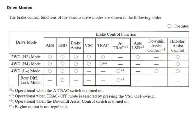

    It is quite obvious and specially on the 2012+ where you have a choice of regulated (TRAC) vs. non-regulated (TRAC-OFF) in H4. In the chart at the bottom, note the *4 notation.
    Note there is a difference between the 2009-2011 trucks and the 2012+ trucks. The charts below are the 2009-2011 instructions:

    I understand what the 'chart' says, and I have read your posts about traction control.
    Although mostly correct, what I experience in 4x4 HI, without selecting trac on/off, is different from the diagrams you have posted.
    And I can't assume that the canadian Tacoma traction control computer for the 09-11 taco is different from the US version.

    In 2009-2011, there was (is) no TRAC OFF MODE in H4. Your TRAC (traction control) is unregulated, and more powerful than the 2WD TRAC (which is regulated).
    In H2 (2WD) you do have a TRAC OFF MODE, but we always call it AUTO LSD (because that is what the light says).
    2012+ Made it real confusing because what is TRAC OFF in H4 (4WD) was called TRAC (ON) before! Now TRAC is the same in both 2WD and 4WD-HI (regulated). However, in the long run, they standardized the meaning of TRAC. It is just odd to me that MORE TRACtion control is called TRAC OFF!!
    No traction control is called VSC OFF, and that is unchanged.
    2WD: TRAC and AUTO LSD (TRAC OFF)
    4WD-HI: TRAC and TRAC OFF

    Trac 1 is a light limited slip and Trac 2 is a strong limited slip:
    Trac 1 (engine output regulation): Trac in H2 and 2012+ Trac in H4
    Trac 2 (no output regulation): Auto LSD/Trac Off in H2, 2009-2011 Trac in H4, 2012+ Trac Off in H4.
