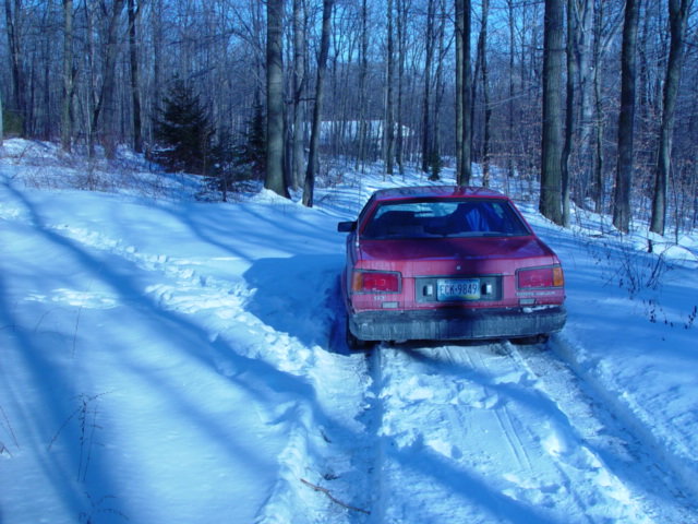

    For a few years because of a very expensive divorce I drove my 83 Celica out of my Bobsled run of a 142.jpg driveway
