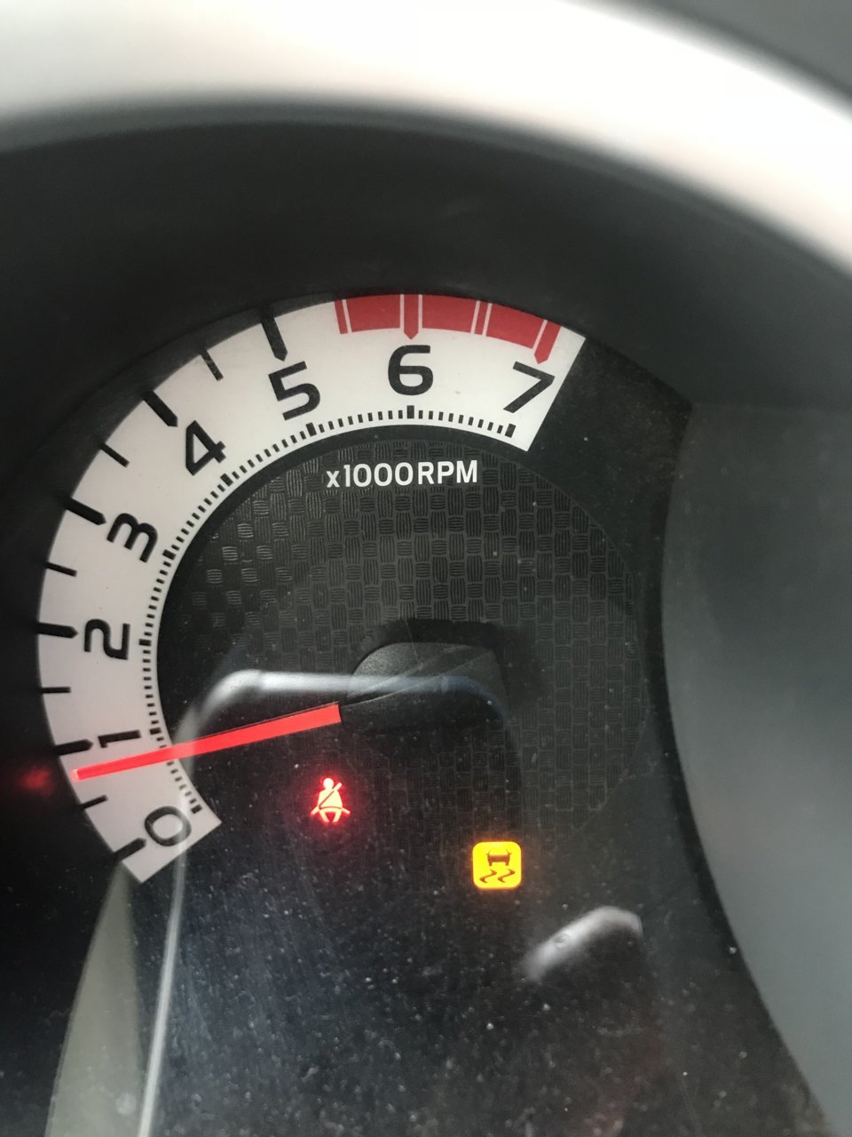

    6FF1D89C-DE8A-4B9D-A1E2-6AACC830394A.jpgThis is what i have on, that VSC. Pressing the switches doesnt do anything To turn it off
  15. May 3, 2018 at 12:52 PM
    fatdad2013
    fatdad2013 Active Member
    Feb 11, 2018
    #244126
    30
    Ian
    white 2014 toyota tacom trd off road
    yup that's the one. If that's the only light you have one then the zero calibration should fix it.
