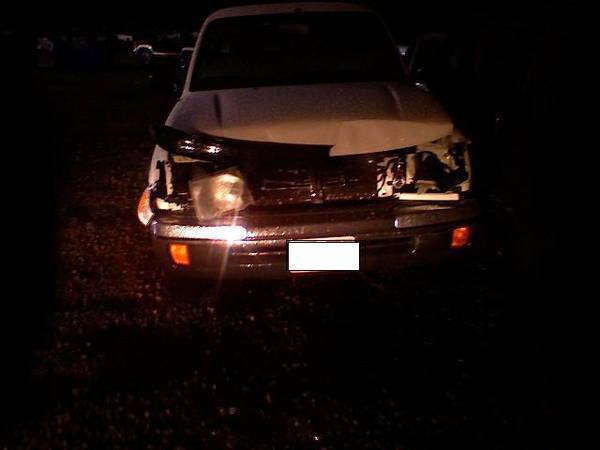

    This is a result of having the tube sand sitting in your garage and not in the back of your truck. I was getting on the Ohio Turnpike and spun out, jumped the median and hit a UPS tractor trailer coming the other way. The UPS guy ran right by me after the accident asking if the guy driving that truck was dead or needed an ambulance. When I told him it was me he got tears in his eyes he was so happy.
    Get the sand.
    Also, Minnesota? You couldn't have stopped of for a few years in Missouri or Iowa to break yourself in a bit, you went straight for freakin Minnesota? Well, good fishing there.
