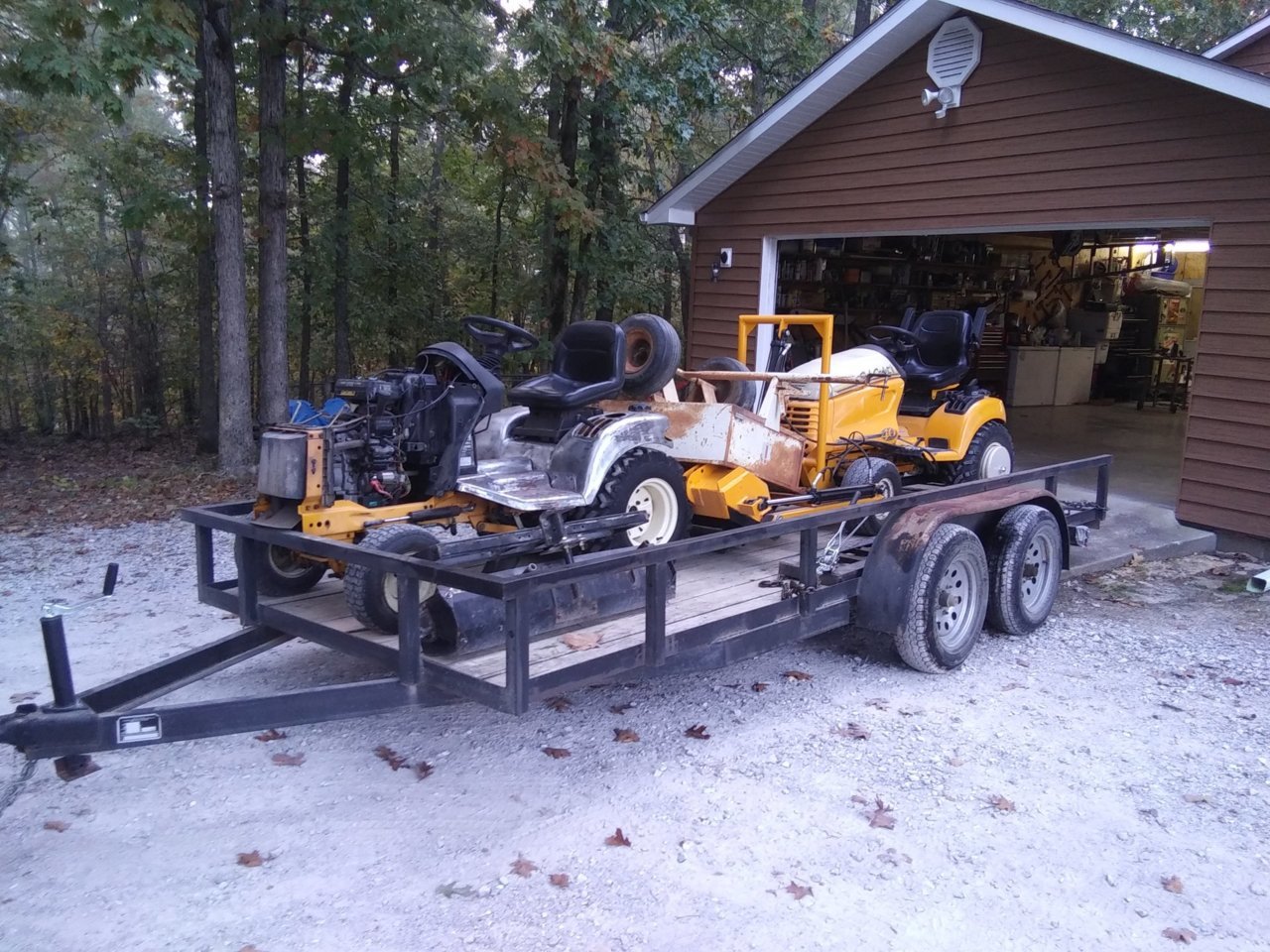

    Thank ya'll for the input on the trailer. I think I hauled ~2700lbs on a 16ft steel trailer with no brakes when I hauled my tractors, cart, and box blade up to a co-workers house for dirtwork. My clutch was not happy with that at all.
    I think if I bought this tractor I'd rent a truck as well. Probably cheaper than a clutch.

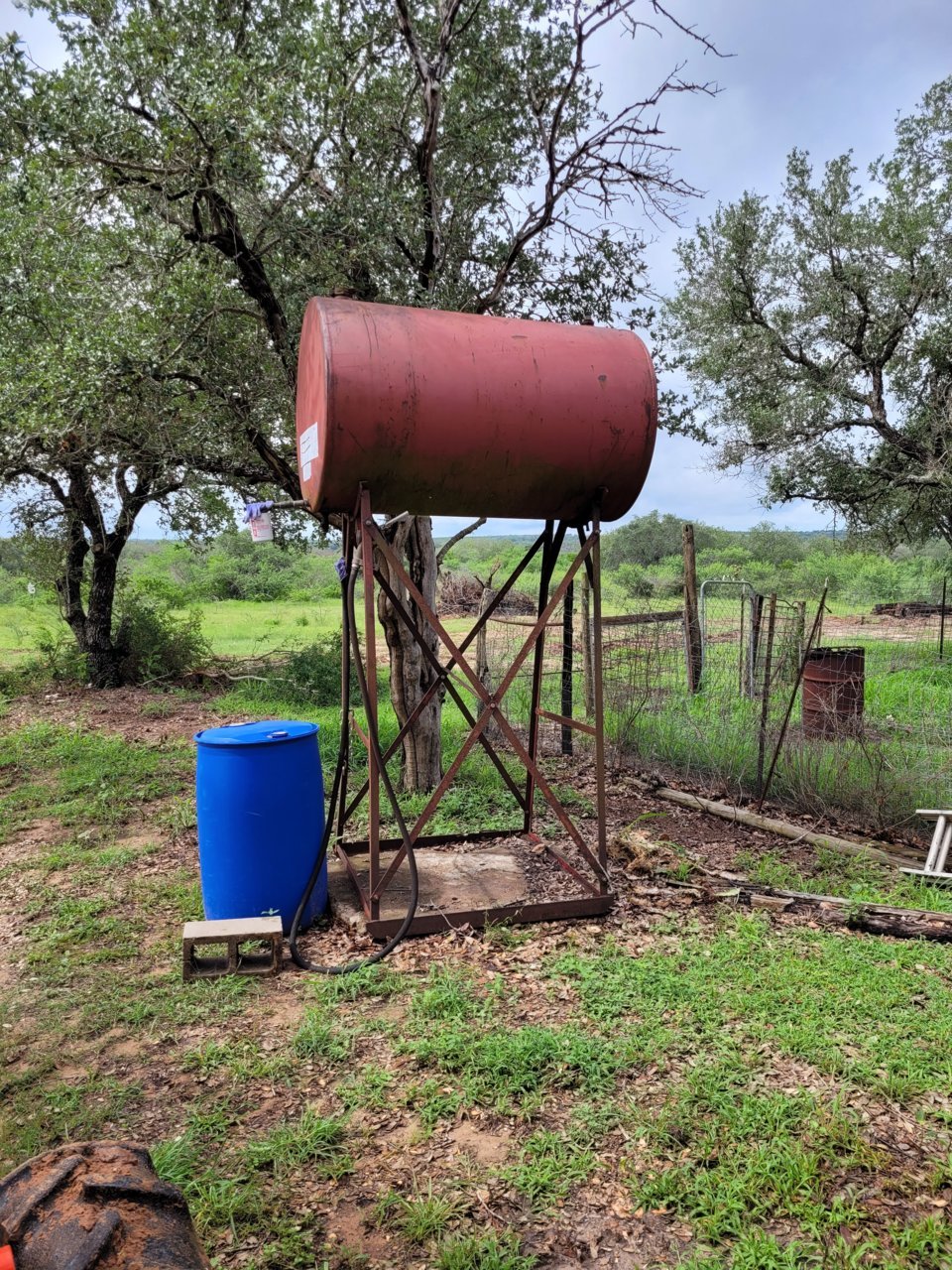

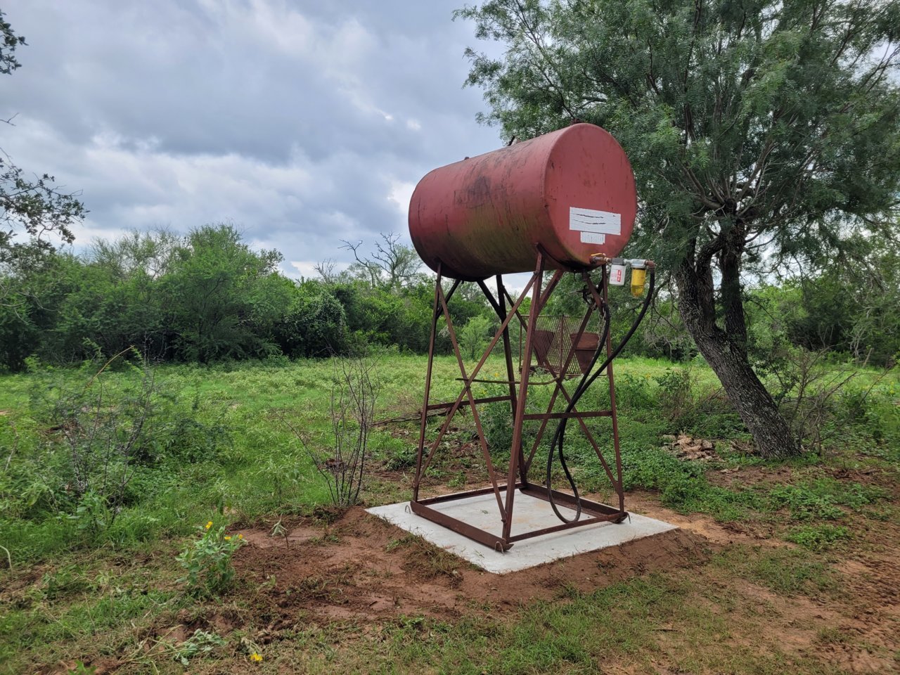

    Water sinks and fuel floats.
    Most of the diesel modern tractors have a water separator built in or in conjunction with fuel filter, most users should dump that a couple times a year.
    **Always keep diesel tank FULL over winter months, reduces the amount of sweat and condensation that will build up in a tank.
    On a 300 gallon tank, not always will it be topped off or full, so they receive more condensation/water with temperature swings, I added a water separator, allows me to visually see if water is in fuel and drain off prior to putting fuel in tractor/equipment.

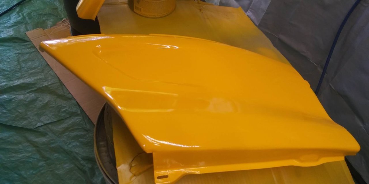

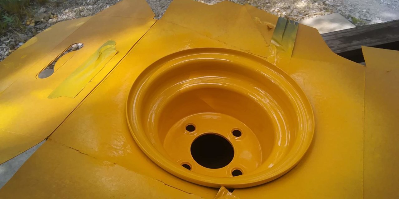

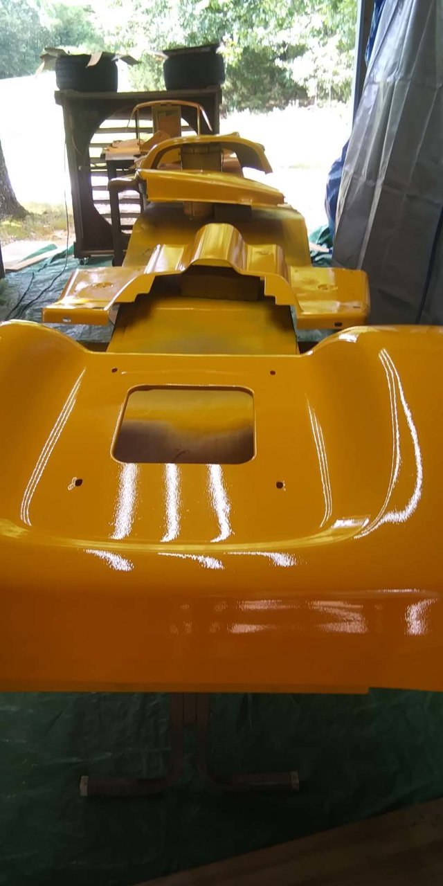

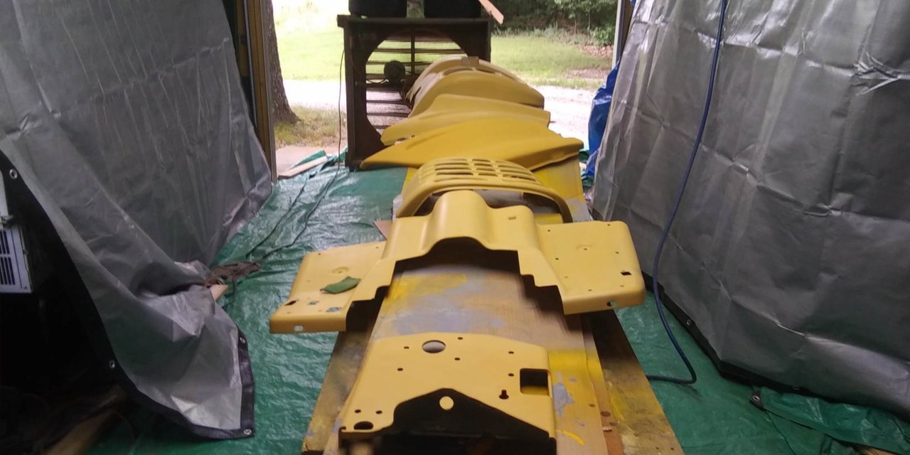

    Getting ready to spray some paint. Scotch brite smoothing yellow primer which was sprayed over over etching primer then will spray with catalyzed IH yellow on my Cub 3205 tins.

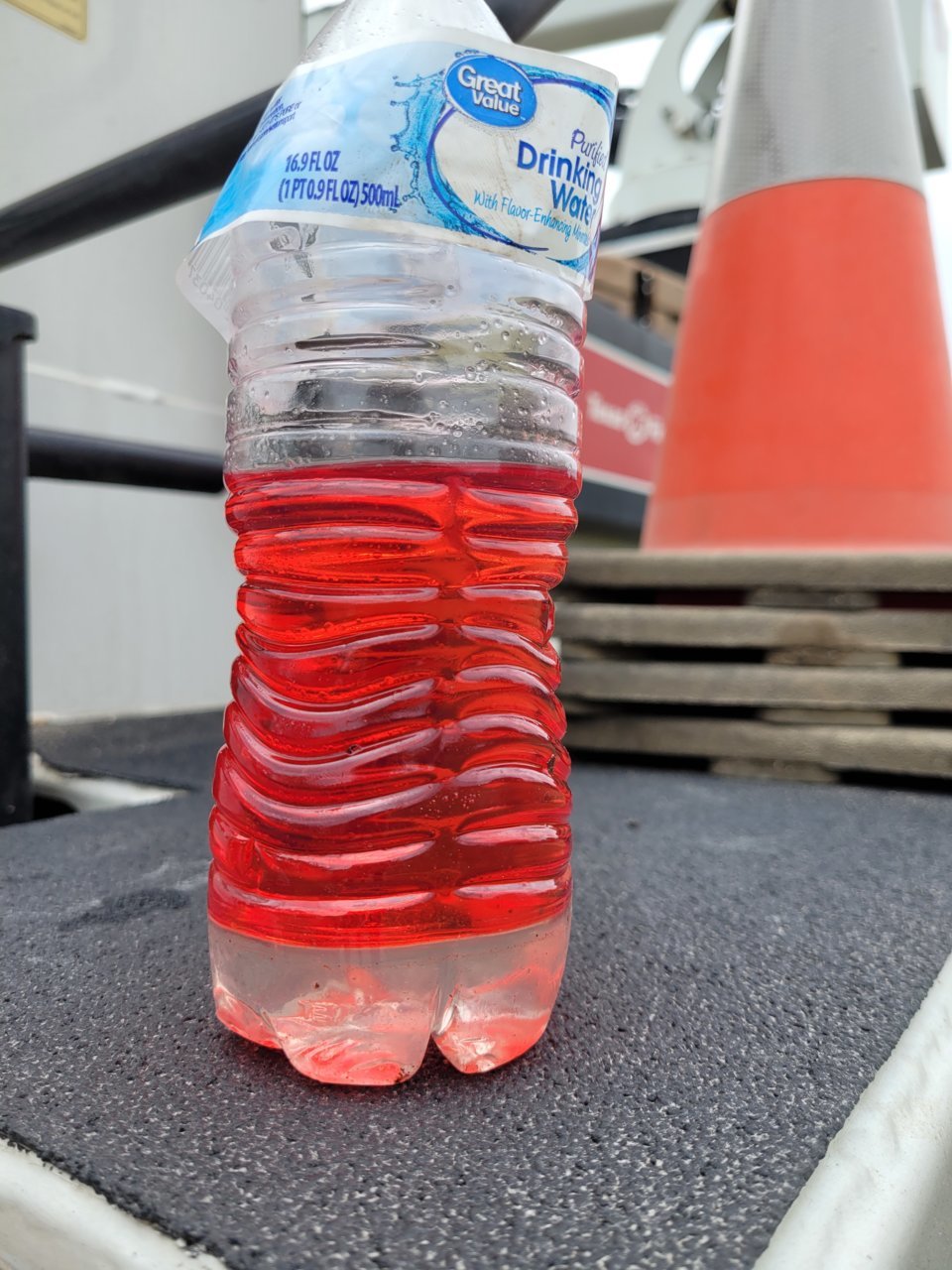

    This is what you don't want, the Cat299 showed up here with bad fuel. If possible always use farm/dyed diesel, so much easier to spot water in the fuel.

    Customers fuel cans are never clean!! “I don’t know how I get water in my fuel”!!!

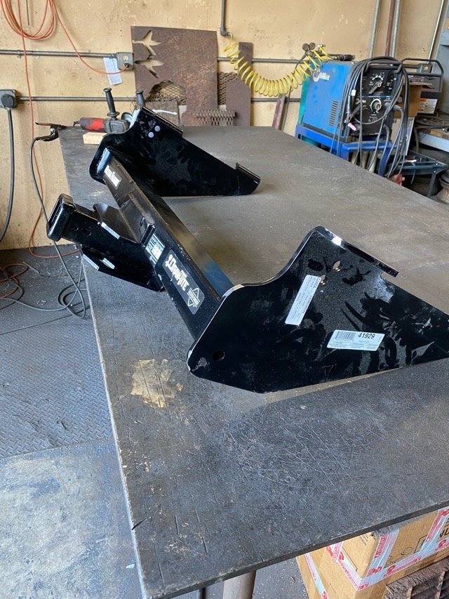

    The Boss?
    I have a similar hitch that was ordered for the bosses Crosstrek and would help with the install. Hitch is still on the ground in bosses garage.

    A friend repaired kerosene heaters for many years, same deal, people say "we only use the can for kerosene" -- yeah, right... :smack:
    And gasoline, diesel, heating oil, rainwater -- all of which will instantly :censored: up a kerosene heater.

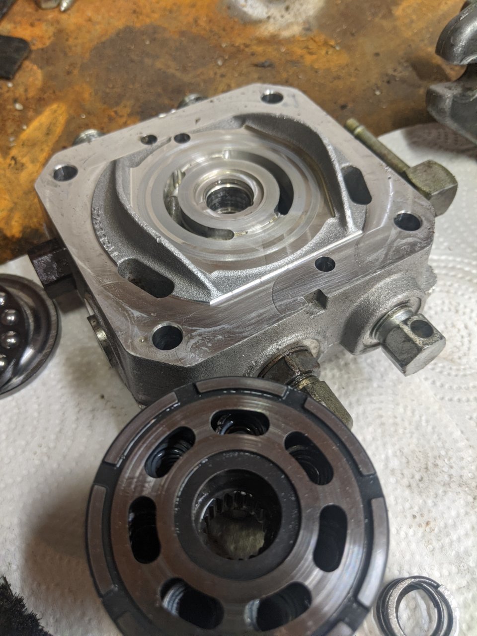

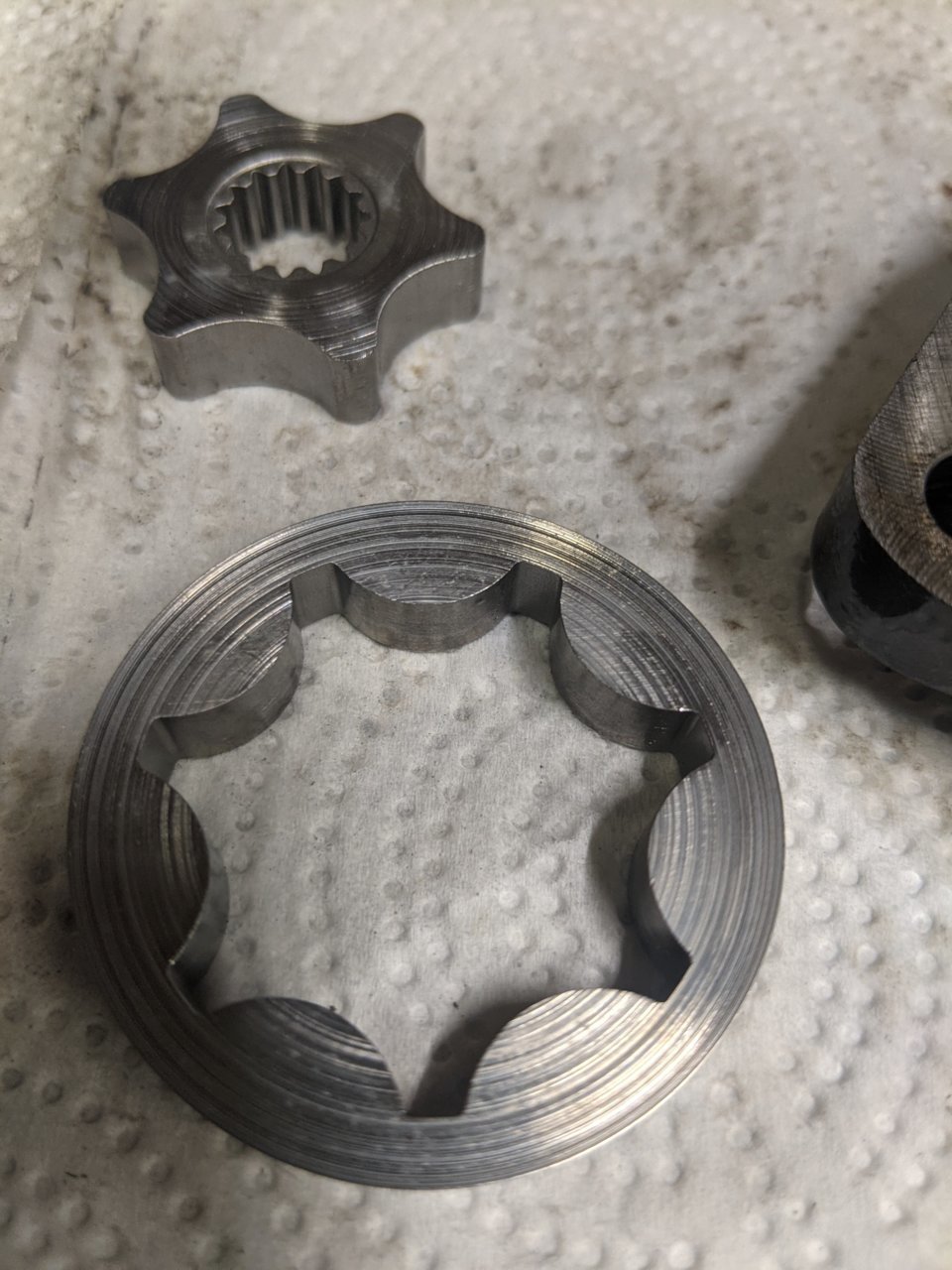

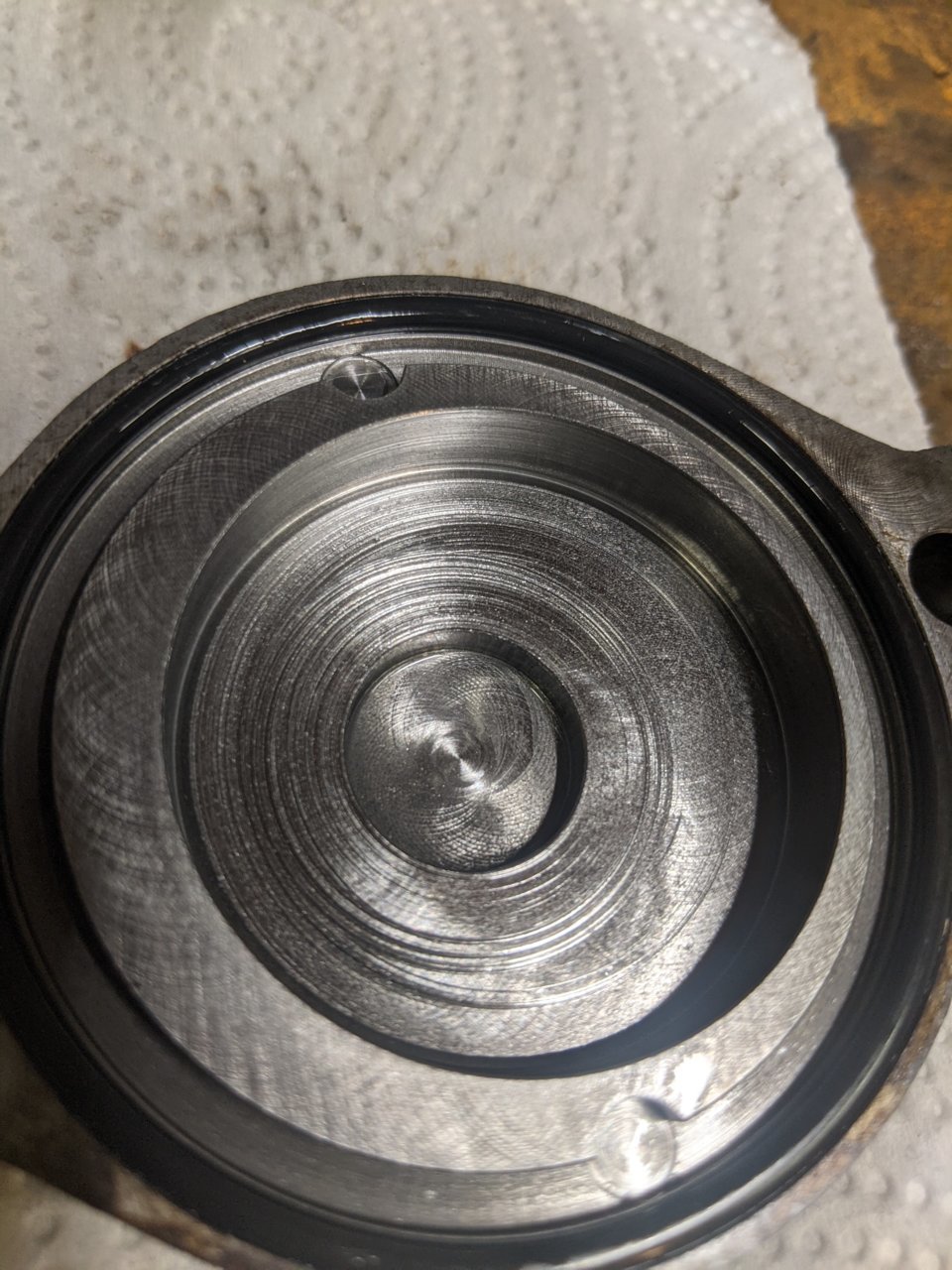

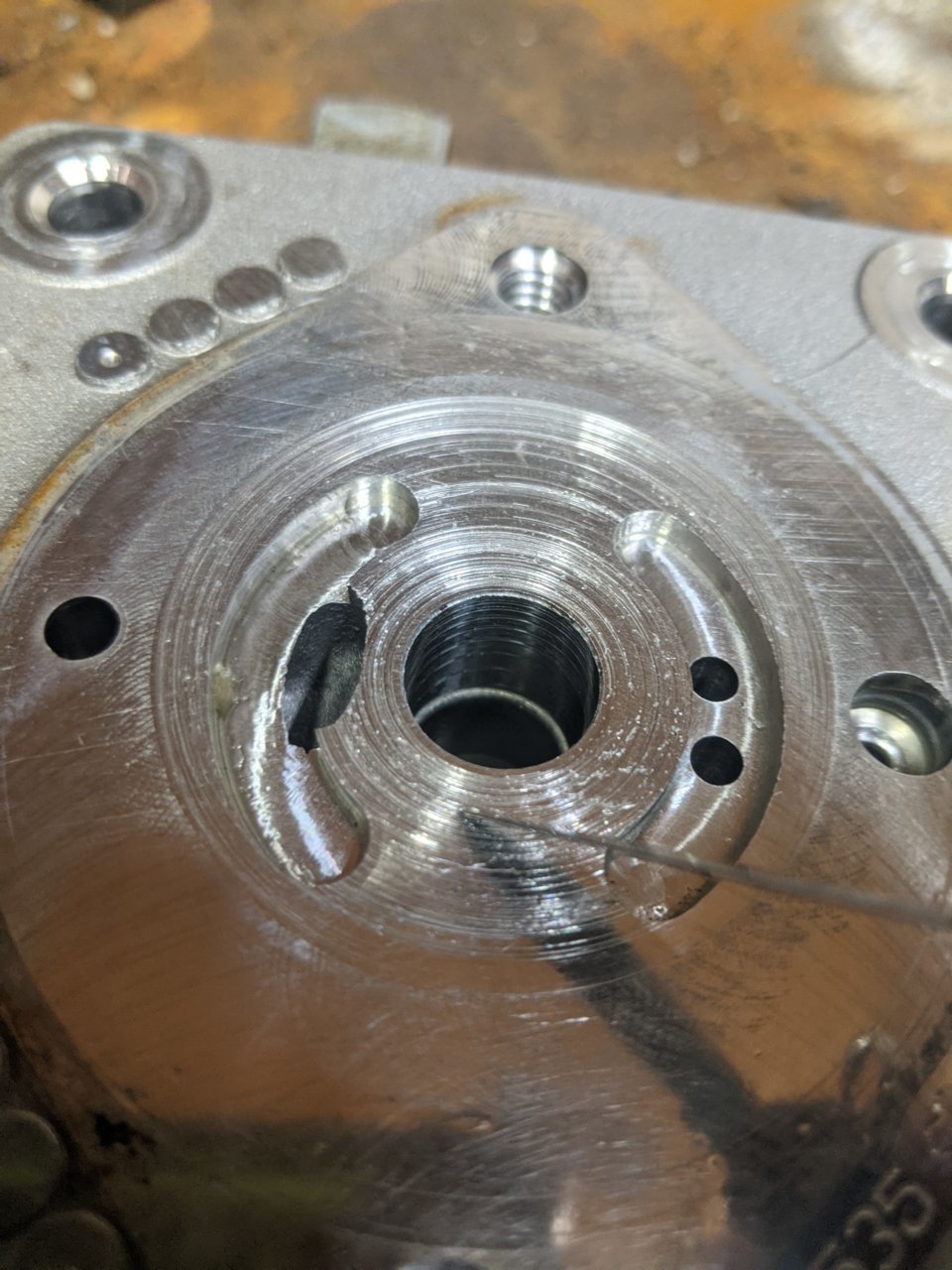

    Hydro pump experts:
    There is significant wear on the surfaces of the gearator oil pump. The finger nail drags quite noticably.
    There is very little wear on the surface of the piston cage.
    Does the wear on the oil pump side indicate replacement is required? I can find no references telling when replacement of the oil pump and case cover and oil pump cover are required.
    I still can't figure out what was causing the clatter when changing directions. I need to look at the relief springs yet.PXL_20210711_214044775.jpg PXL_20210711_214050673.jpg PXL_20210711_214116813.jpg PXL_20210711_214205787.jpg

    Very interesting…. You think this where your chatter is coming from…. Sometimes our a/c compressor clutches look like this and they’re toast once scored….

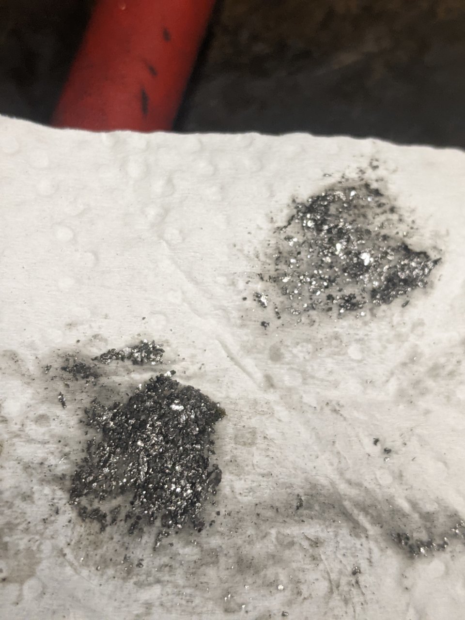

    I can't see where this would cause the clatter.
    There is no difference on the power from one side to the other. Just a very annoying clatter, shudder, ratcheting sound-feeling.
    I took the filter apart and ran a magnet along the filter media. This is what I got. The only thing that is iron and shows wear is that oil pump assembly. I assume the metal is from the oil pump. It may have come from the old motors, so it may look worse than it is.PXL_20210711_221505300.jpg

    I’m not much help but I’m not a big fan of said scoring :-/
