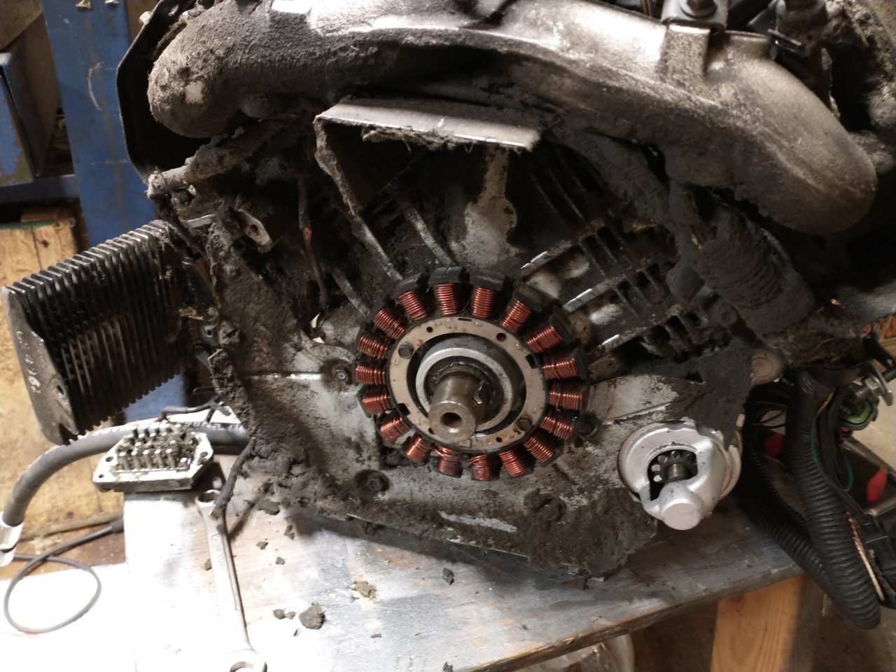

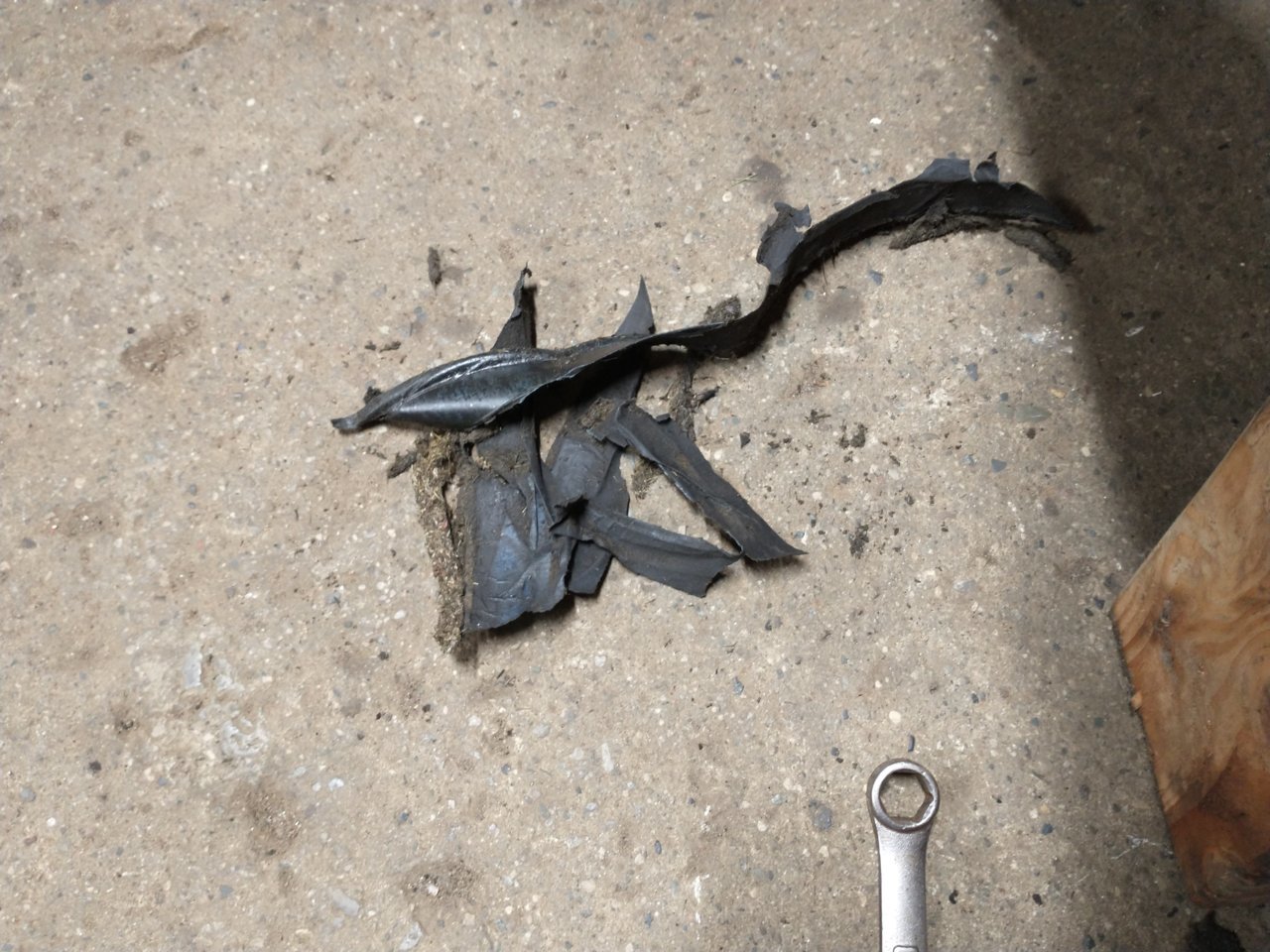

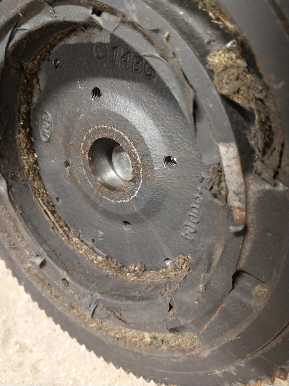

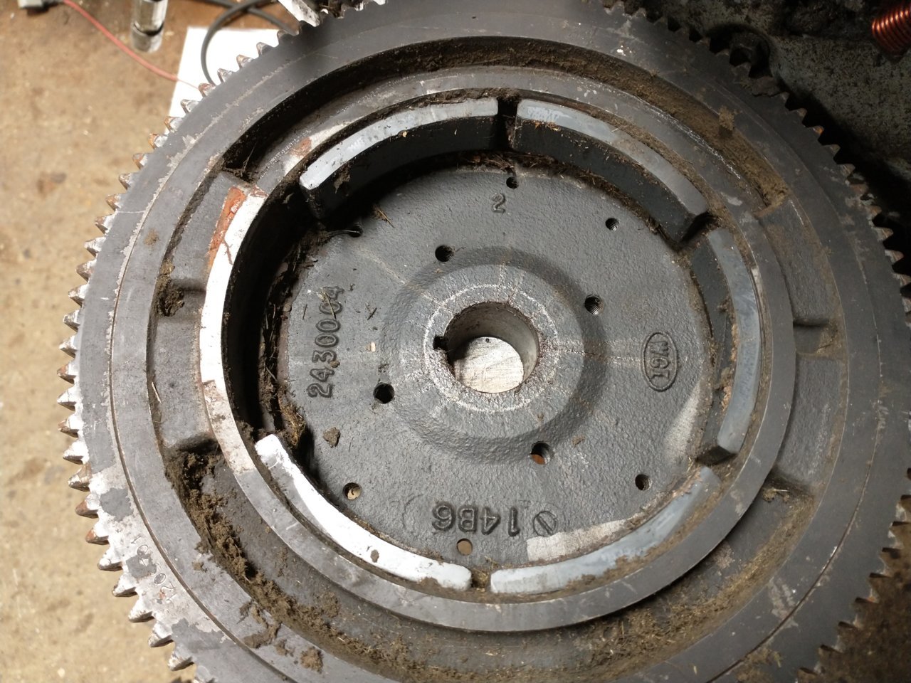

    New stator and voltage regulator as well as a replacement magnet epoxied onto the inside of the flywheel.
    Old mags were taped in. Some sort of vinyl tape was helping holding the mags in position. I've never seen this before, but I'm sure it happens.
    Inside of flywheel area was pretty nasty. She should cool a lot better now.
    No head gaskets were needed.
    Engine is installed and running properly putting out 14+ volts at a high idle.IMG_20210723_221438374.jpg IMG_20210723_220429798.jpg IMG_20210723_221447793.jpg IMG_20210723_220508596.jpg IMG_20210723_220605317.jpg

    That was one dirty engine! Should run happier now. :)

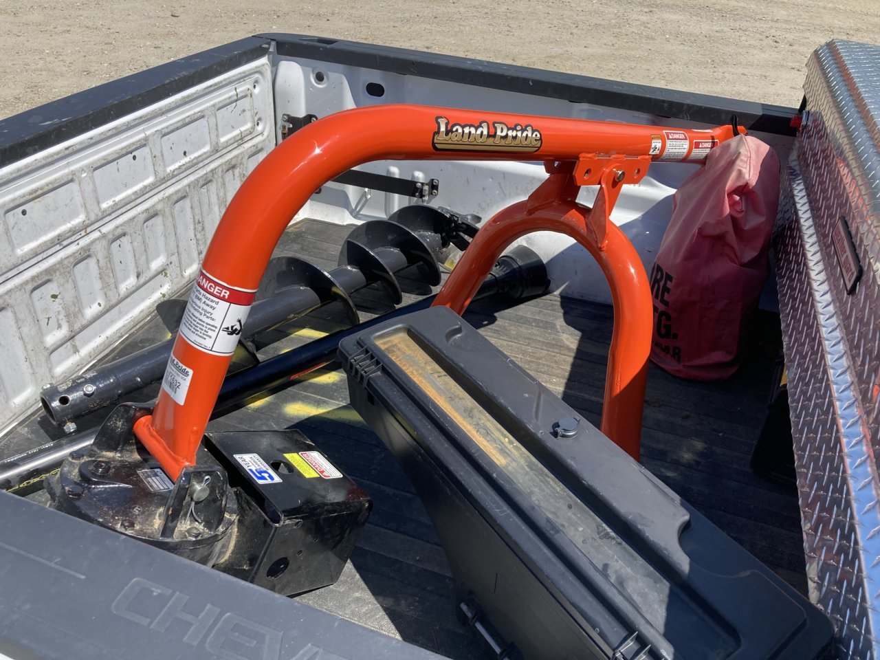

    For sure, it beats hell out of hand digging with a post hole digger.
    Just got to be careful is all. I have one. Mine is no good on hardpack since there's no downforce with the 3 point. I'm not an expert, but I think it's only the very large tractors that can push down on the 3 point. Mine is a little bit floppy and vibratey too like it's not in perfect balance.
    Another thing to watch out for is if you have grabby clay soil, you can suck it down the hole and if you can't reverse your PTO, you got yourself in a bit of a pickle. My theory that seemed to work for me was to run the thing full speed so that it was always shaving and never grabbing and let 'er down easy.
    Sorry, I wasn't trying to rain on your parade. I'm genuinely curious if you'll feel the same as I did, that it's not a magic bullet without any of its own issues.

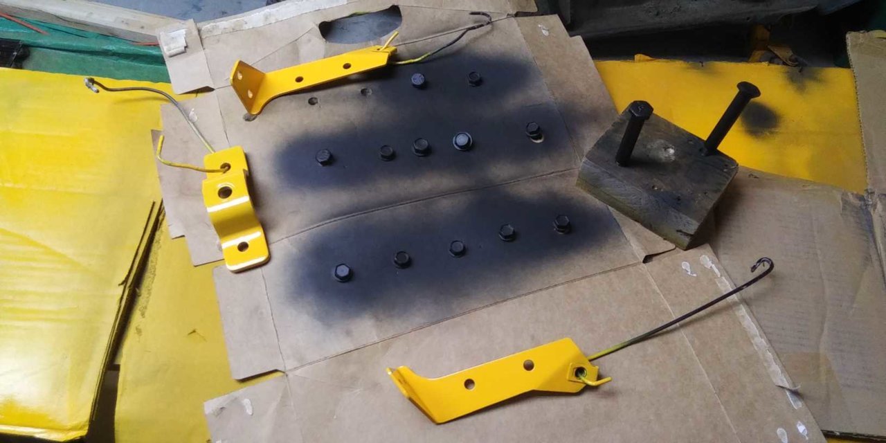

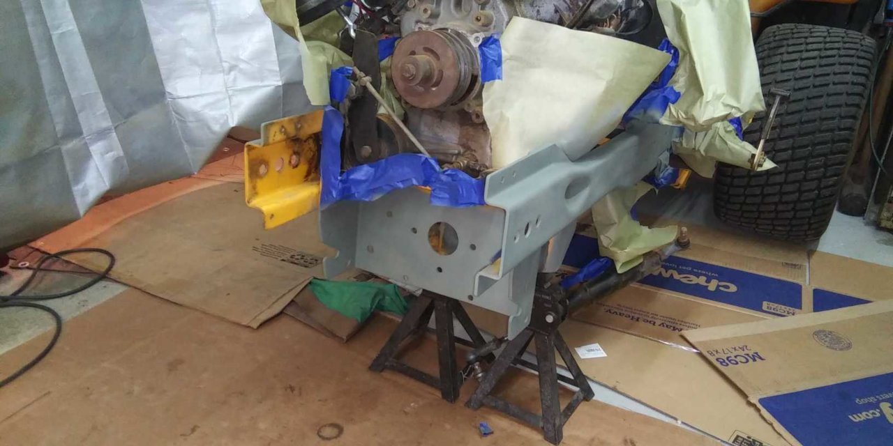

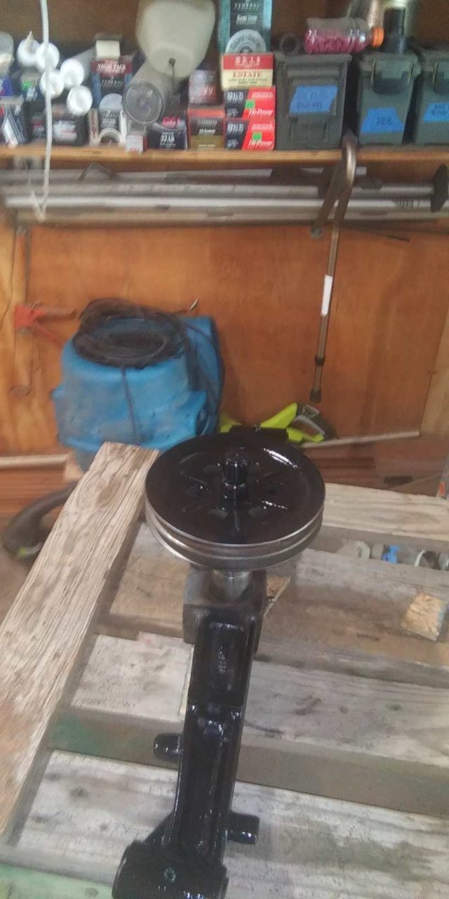

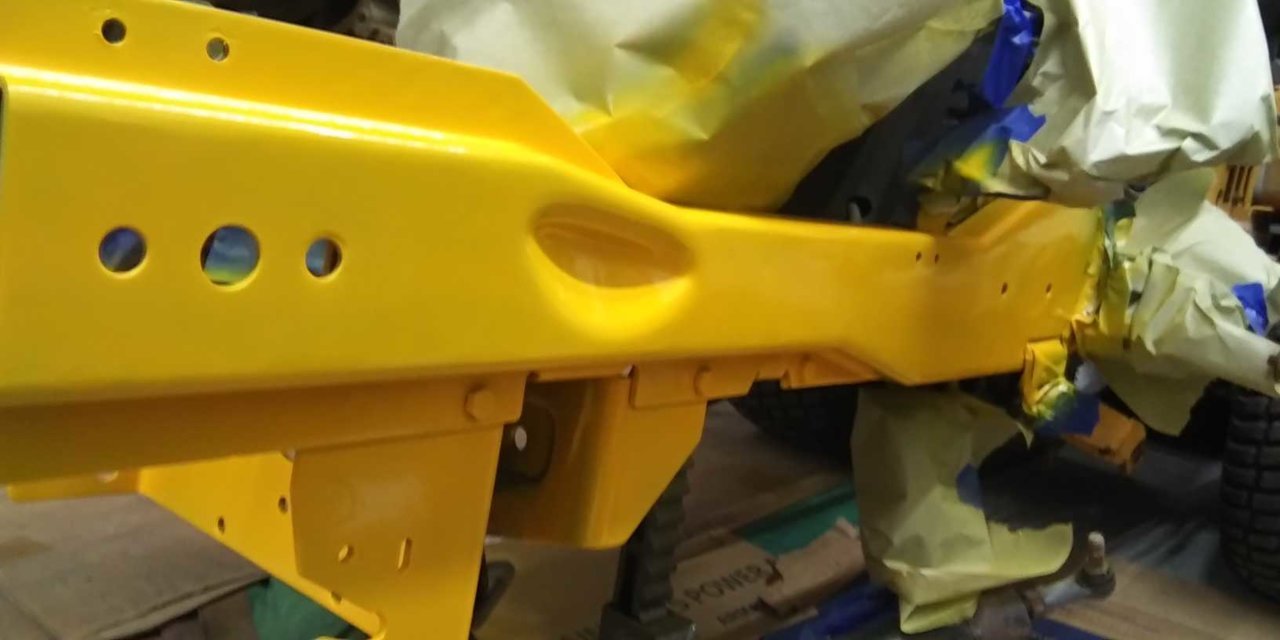

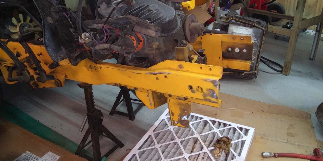

    I had the front end torn apart on the 3205. Someone painted the frame w/o sanding it and that was cracked and falling off. I took off the brackets, sanded the old paint off, etching primed it, and painted the frame. Also painted the bolts, front axle and PTO.
    20210725_125746_compress31.jpg 20210725_153834_compress27.jpg 20210725_200925_compress67.jpg 20210725_210412_compress4.jpg 20210725_125725_compress58.jpg

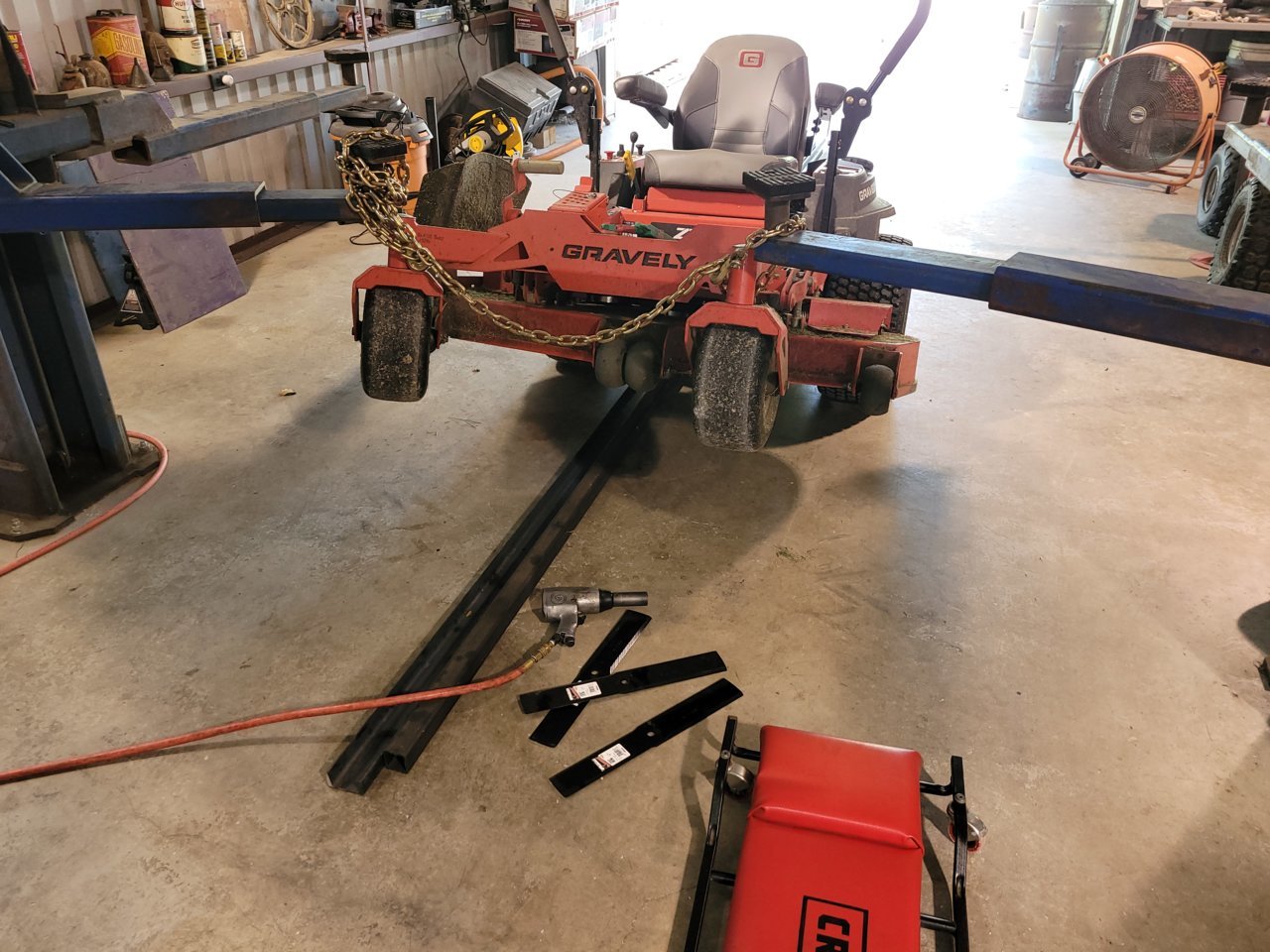

    New sand blades, I still had to cut everything twice, I been at the farm for the past month.

    The cheapest blades you can buy, since the sand you are mowing thru is gonna wear them down Uber fast.
