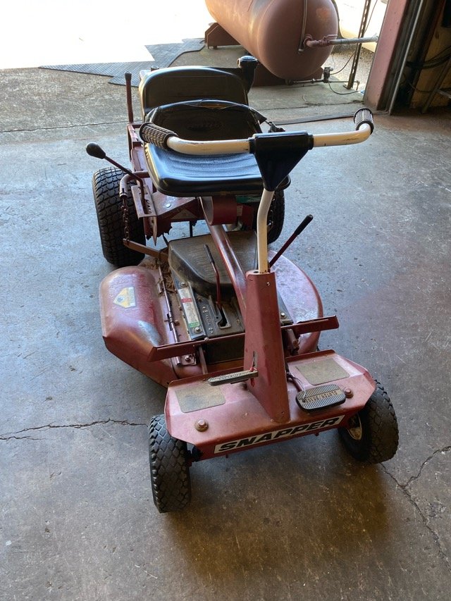

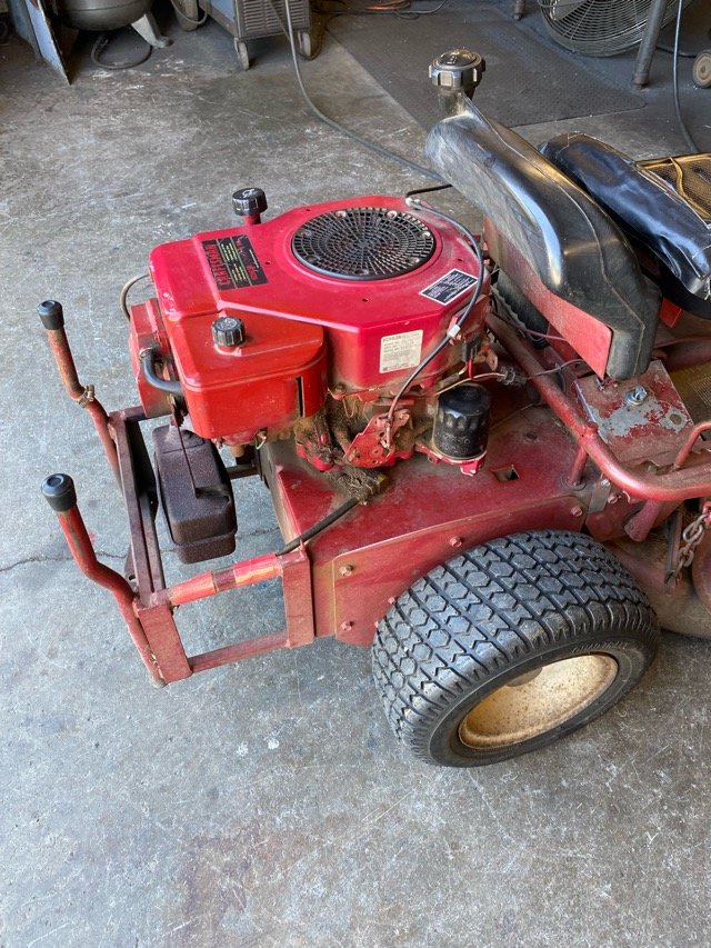

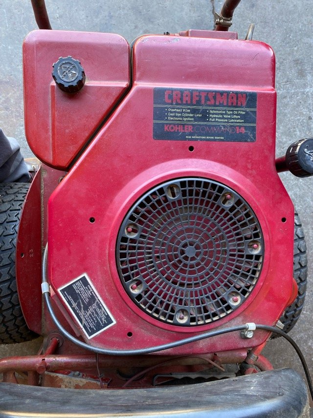

    I forgot about this mower. About 15 years ago my uncle gave me a craftsman mower with a Kohler 14hp engine. The mower was shot but the engine was good.
    Not long after my bosses dad threw a rod in the Briggs on this snapper.
    He ask me about an engine, long story short I put the one I had on this for him.
    Today my boss brought it in for me to look at, he said it runs great until it gets hot then it shuts off.
    Reckon it’s the coil?

    The iconic Snapper Comet. I believe that the Command 14 HP is larger than the original engine, must not ever bog down. :thumbsup:
    Pull the blower housing off, might be full of crap making the coil too hot.
