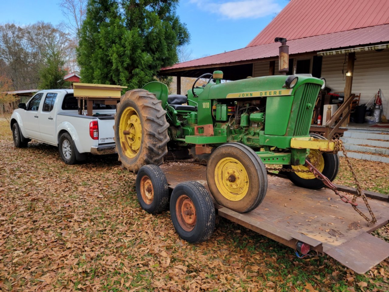

    I know a guy that pulls his tractor around with his Nissan Frontier. He says it does great but sometimes stopping is tricky. Yesterday he pulled it up to the mountains more than three hours away. Is this guy crazy or does the Nissan have a lot more pulling capacity than my Tacoma?

    The saying "just because you can, doesn't mean you should" comes into play here.
    That looks sketch as fuck. It might get going ok, but stopping is another story. Also feel bad for the transmission... I don't think those have a much different towing capacity than our Tacoma's.

    I believe the Tacoma is rated slightly higher, but not very smart to exceed what your vehicle is rated for.

    Frontier towing capacity is around 6500 lbs. Tacoma is about the same. That tractor weights about 4K lbs. plus the trailer he’s still within limits. Tacoma could tow that the same as well. That weight is on the high end for a midsize but it’s doable

    That tractor weighs around 4,000 lbs. I wouldn't pull it the way he has it, too much tongue weight.

    Does it have trailer brakes?

    He doesn’t have trailer brakes. It’s an old homemade family trailer. I would never use my Tacoma to pull a tractor or a skid steer around like that. I thought he must be an idiot or his truck is a good bit stronger than mine.

    Thats really what you want when towing. It lets you know you are being as safe as possible :facepalm:
    You mean the trailer built out of scrap angle iron? Imma guess no

    Going is no problem, but the lack of trailer brakes is pretty negligent. Towed with my frontier around the limit and and didn't have any issues, but I did have trailer brakes.

    Accident waiting to happen, but that custom bed rack is sweet :)

    Ok so he already admitted it's not capable of towing. Yes it pulls it, but if it's incapable of stopping in a safe distance and/or without damage to the brakes, I wouldn't say it's capable of Towing.

    Trailers over 3000 pounds need brakes in most states
    “Any trailer over 3000-lbs must have brakes on all wheels in most states, but laws do vary.”
    https://www.etrailer.com/question-329430.html
    When I use to go camping, I remember a guy towing a camper over the limit. He couldn’t stop, crashed into car with a family, and killing people. He was changed with manslaughter.
    It’s not good to mess around towing.
