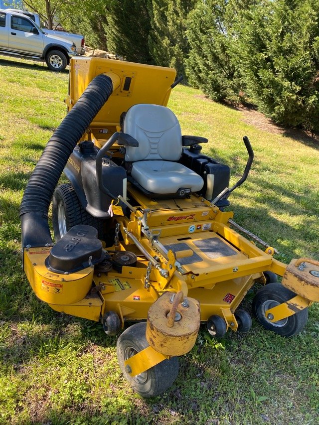

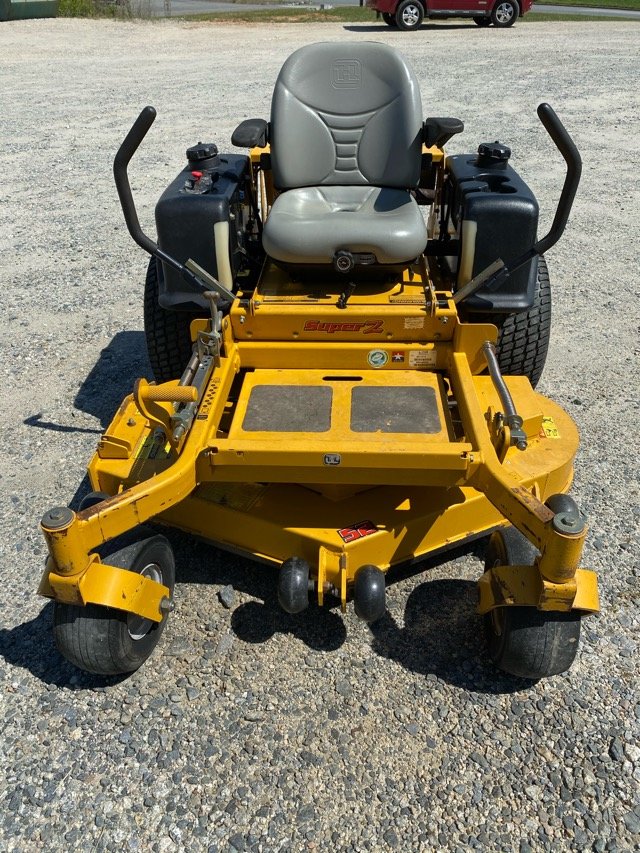

    I saw this one sitting in a friends yard, has around 600 hours on it. 25 HP Kohler, I gave him $4,000 for it with the vacuum. I sold a small rider I pulled a tracvac with, the tracvac (bought it at an auction, used it a lot), and the zero turn I had. I did some trading for the zero turn I had, I figure I have around $3k in this one after all the trading. It made getting leaves up this season so much quicker and enjoyable. I couldn’t justify buying a new one for no more than I mow.

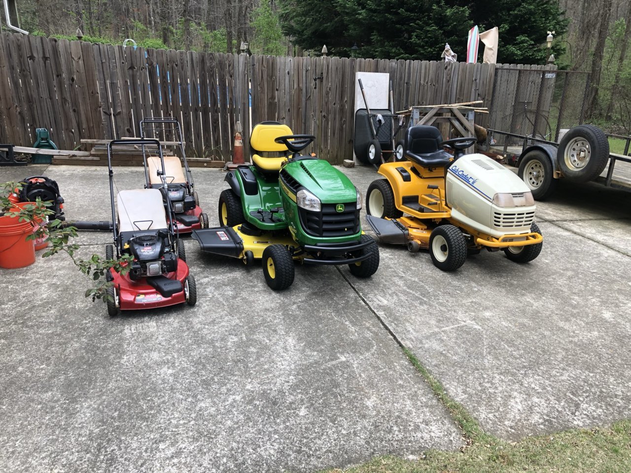

    A little of this and a little of that.

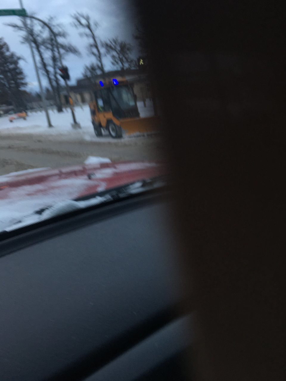

    Super bad pic but these sidewalk scrapers are pretty cool. Most times they pack a sandin’ trailer/spreader too.

    I agree. I’ve seen both blades and blowers, some double row augers

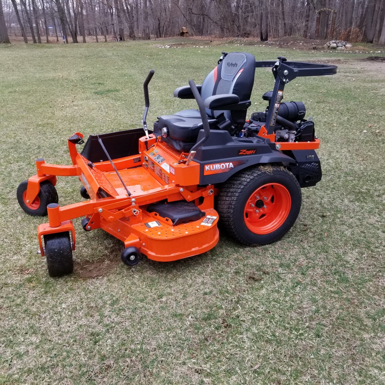

    Well, the new mower is here.

    :fistbump: Awesome mower!

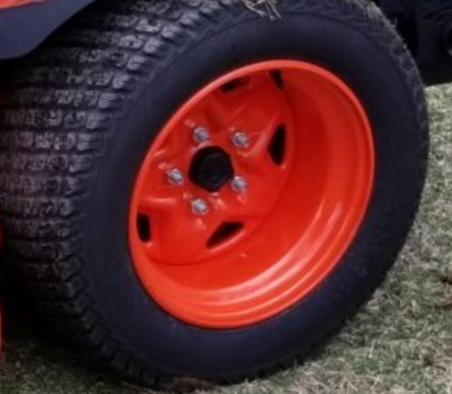

    Nice. Looks like they put Tacoma SR steelies on it.

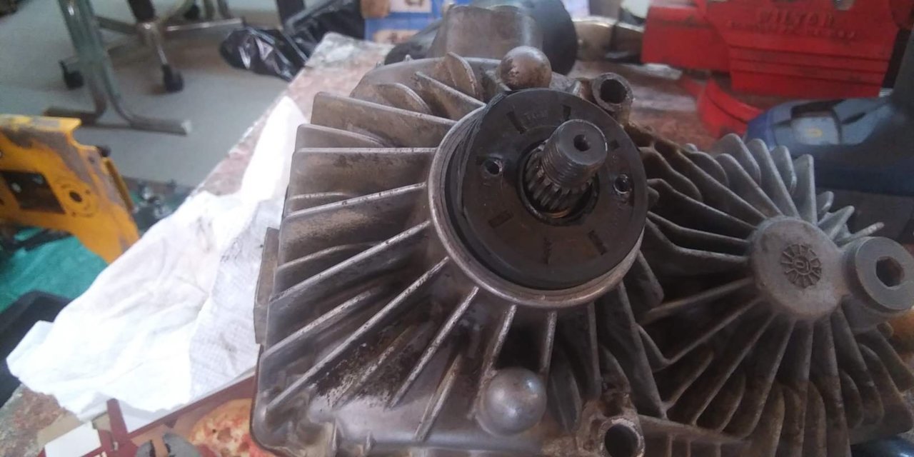

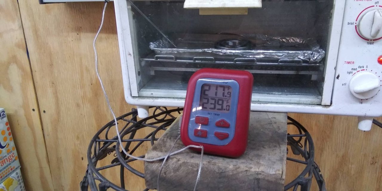

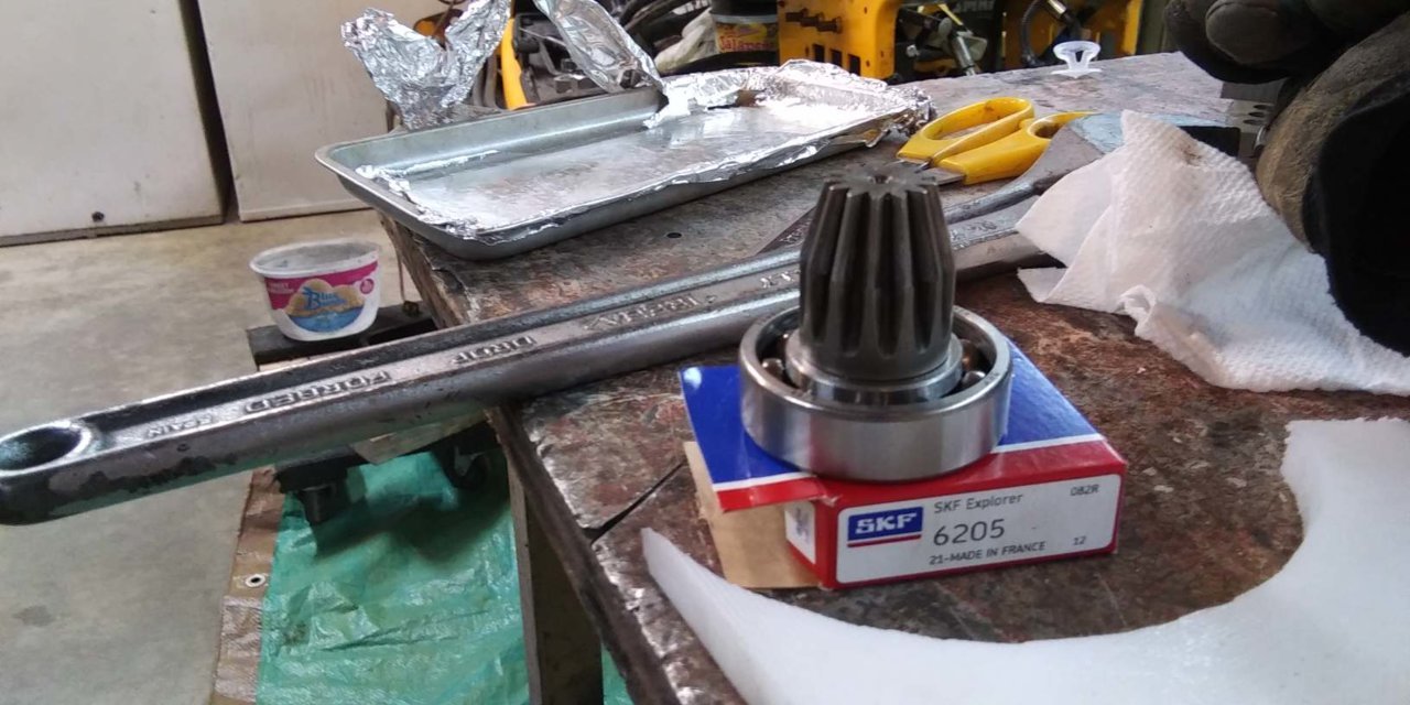

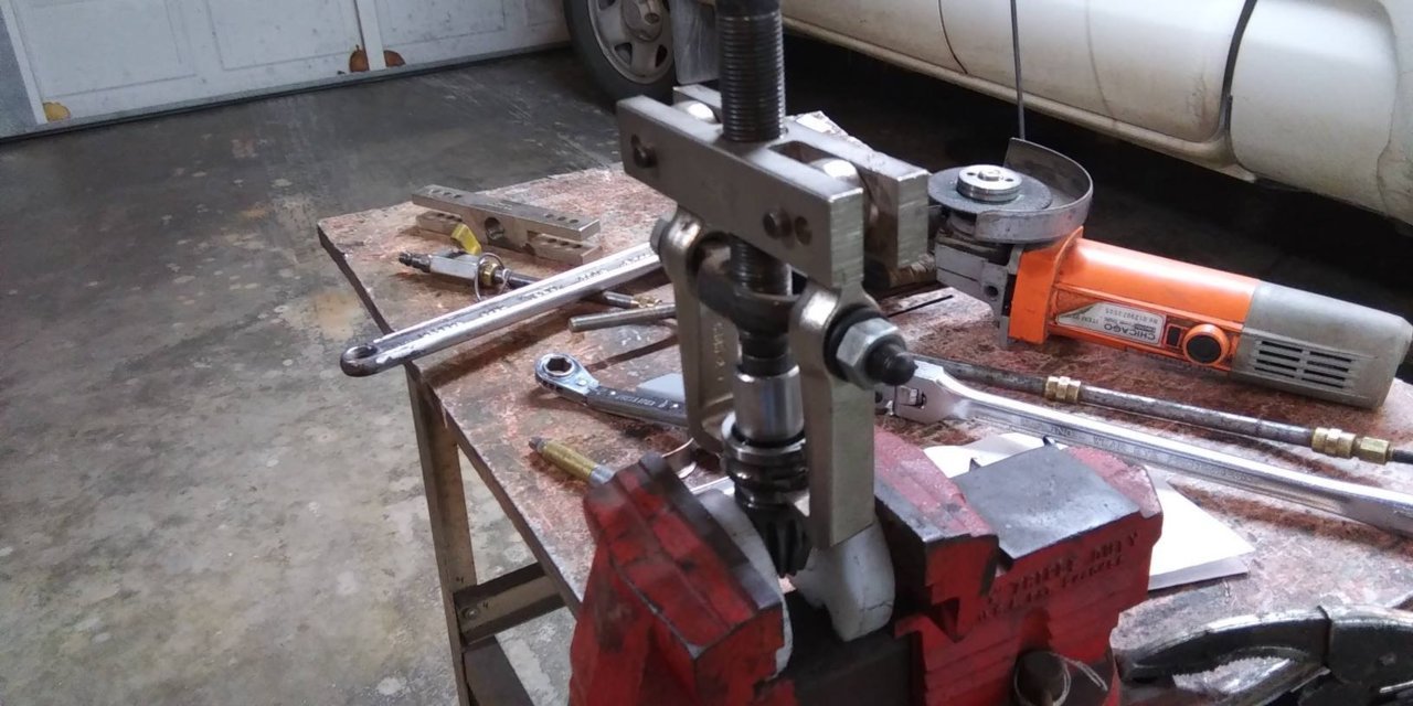

    Working on the 3240 rear today. My hydro drive gear bearing was noisy so I cut the outer race off and pulled the inner race off. Heated the new bearing to 250F and froze the gear. Pressed it on with the vise set up with soft jaws. I used the inner race of the old bearing to press the new one on.
    I put in all the seals I had--wheel and hydro. I messed up ordering the brake shaft seal. Ordered one based on my wrong measurement of 2.40" when it's actually 2.040". Re-ordered from oringsandmore. I knocked the seals in using the old ones as drivers.

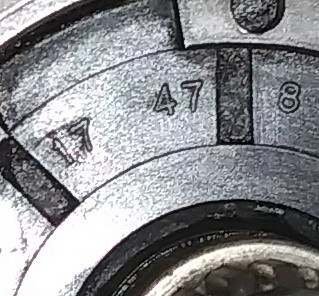

    If ya'll don't know, most seals can be ordered by the metric numbers on the seal. I saved a ton of money ordering from oringsandmore over buying MTD parts. Seals that are $25 each were $3 ordered by size.
    Below is an example. The numbers mean the seal fits 17mm shaft, 47mm bore, 8mm tall. You can convert inch measurements to metric and order them as metric as well.This seal was $3 vs "no longer available" from MTD.

    Nice machine! :thumbsup:

    I’ve never noticed those numbers on seals, only the part number (if there was one). Thanks for sharing :thumbsup:

    No problem. I figured it out when I rebuilt my other Cub differential. Here's where I order from. Enjoy buying the same seals for < 1/2 the money.

    They are very small and usually covered in grime but they are almost always there unless you are talking old. I've used them multiple times at the local industrial store that supplies bearings, bushings and seals to local industries. It's saved me a ton of money over the years and allowed me to repair items that the manufacturer says are no longer supported and the part is "NLA."
    I rebuilt the spindles on an old walk behind that had an oddball bearing size and the only way to get one was to order it new. $12 later I walked out with two bearings instead of $120 for a new spindle assy. If a good place has the numbers [check before mangling the seal] then it's probably available. FWIW, always spring for the US or Japanese made one over the China made one if possible, China ALWAYS shortcuts on tolerances and material.
