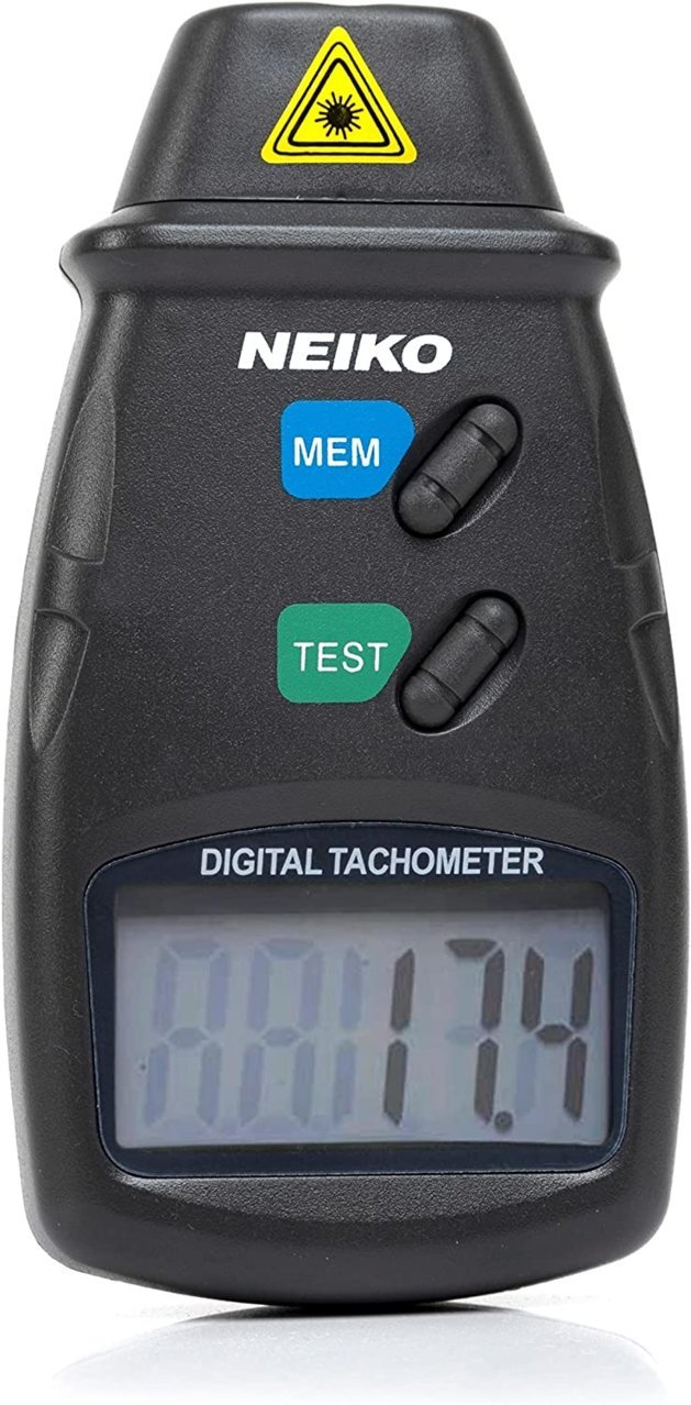

    I got this cool little non contact tachometer a while ago, only $25! I checked it on the bench grinder and some drills, seems quite accurate. I have set the governor on several small engines so far. It uses reflective tape, a tiny piece is all that is needed, it came with enough tape for years.

    I’ve been looking at this one, it is a bit more expensive. but I don’t think it requires tape to function.

    That is the old style that uses the spark plug impulse therefore engines only.
    The one with the tape works on anything that rotates. I checked my oldie air compressor, the new (to me) exhaust fan I installed, kind of fun to tinker with. :laugh:

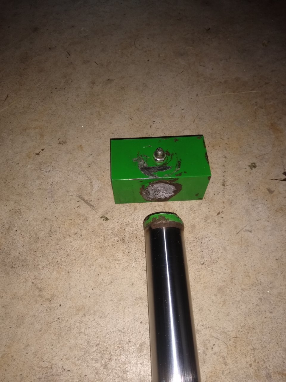

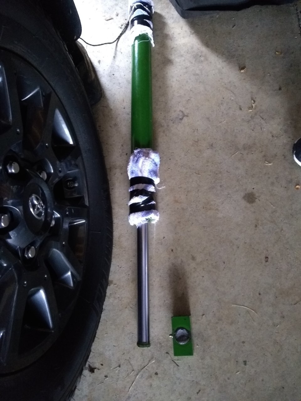

    Thanks for the offer Adam. Dad wants me to see if local weld shop can weld back together. We need this tractor operating this time of year, tends to get some deer blood in the bucket....

    Well that picture is way more helpful. That surely can be welded. Is the ram bent at all? That’s a serious shear off.

    No not bent. Thanks

    Grind the paint off and that won't be a problem at all to weld back together :thumbsup:
    A good welder won't even mess up the chrome :D

    Doesnt look like it was a good weld

    Too bad my little 110 MIG welder couldn't do that work. I know the 480V MIG welder at work could do that, but I doubt I could sneak that in there :laugh:
