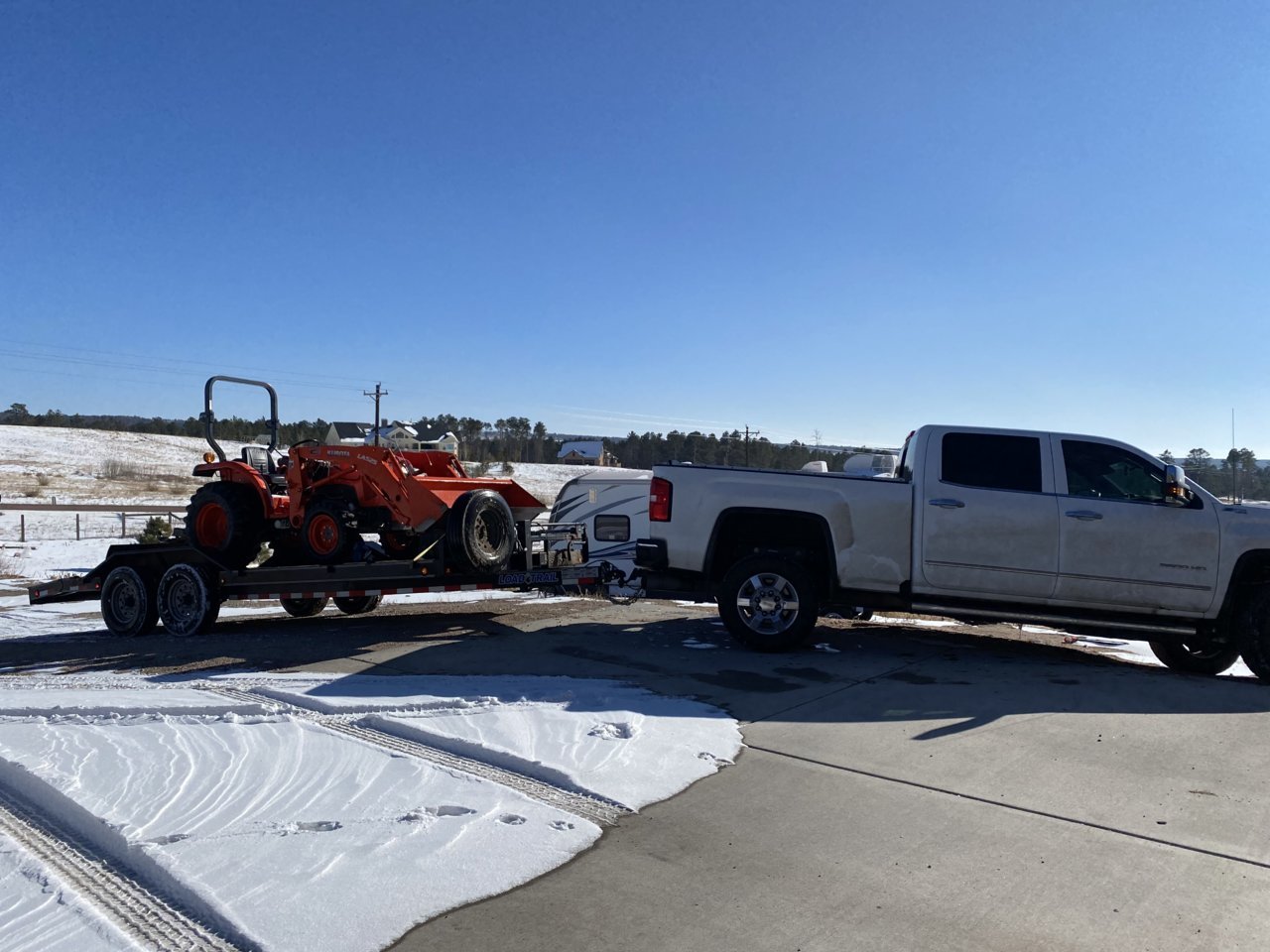

    And we are back. That was a snowy/icy mess.
    I will definitely try these measurements. It’s better...from what I have seen so far.

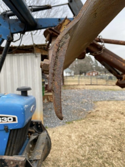

    I couldn’t stand it, I went and got that blade today. I knew it tilted and angled either way, I didn’t know it offsets either way as well. I’m glad to get it.

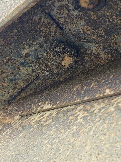

    Pretty sure this is the original cutting edge and bees nest.
