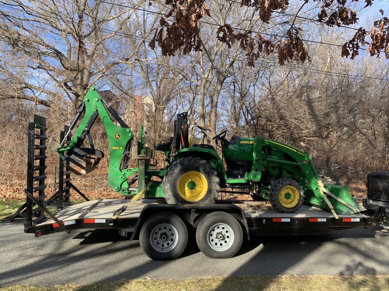

    Nice.
    Watch your power steering line where it goes into the piston on a tight corner; one of our neighbors has one of those and the lugs on his R4's will tickle the line at full lock. He's busted it a couple of times that way. His is an older model, though, so JD may have corrected it on the newer ones.

    I’ll be giving it a good overview in the coming days along with trying to get more legroom on the BH.
    Also has a block and coolant heater.

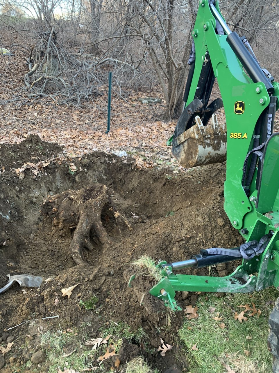

    Got to finally break ground today. Took the last 2 days going over everything, greasing all the joints and also adjusting the BH seat to gain an additional 3”+ of leg room.

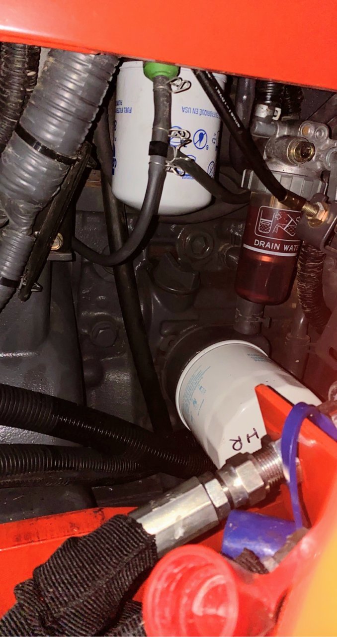

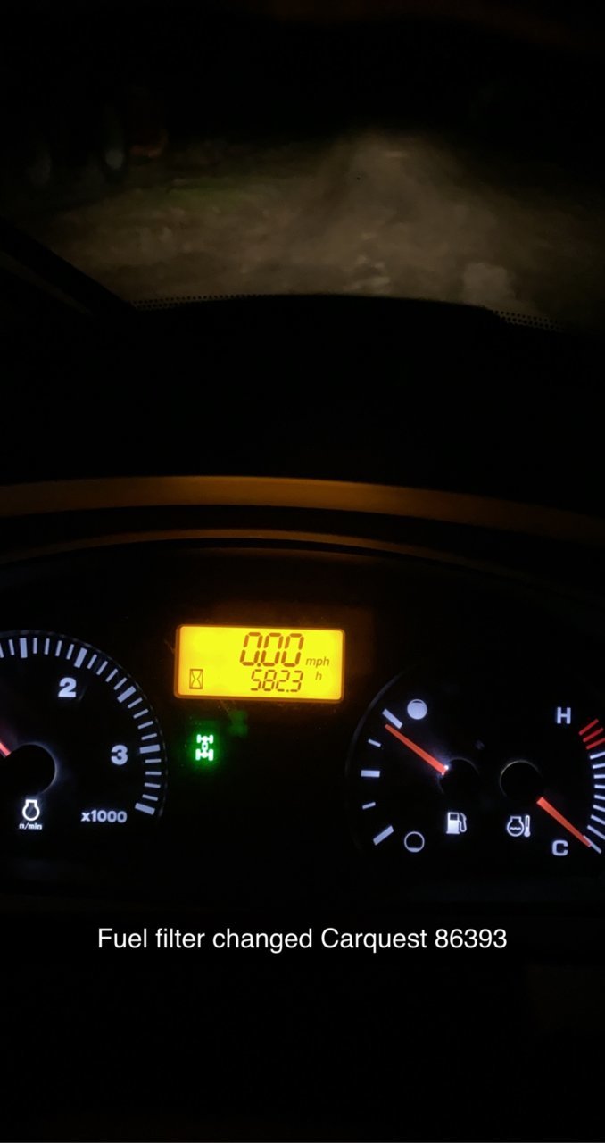

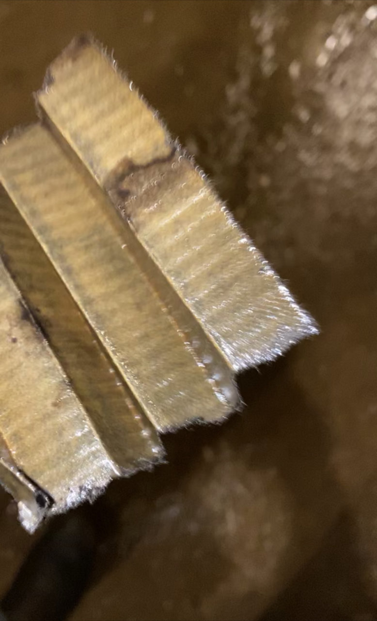

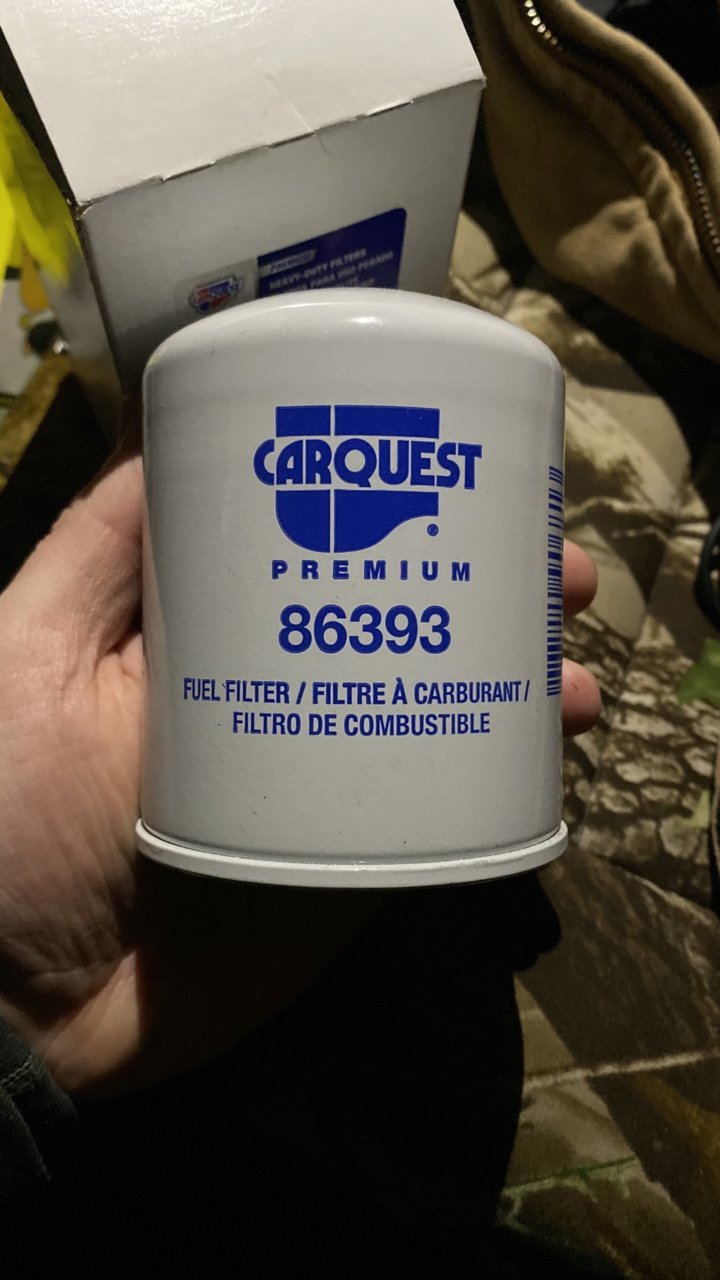

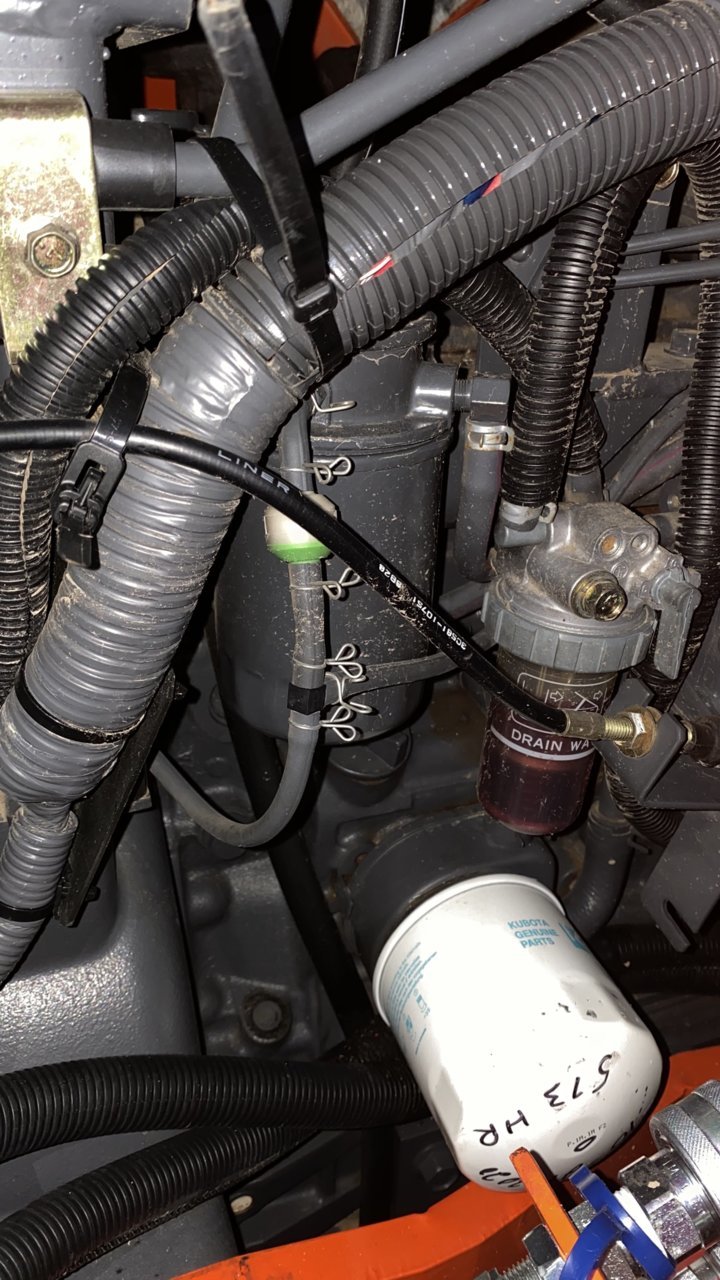

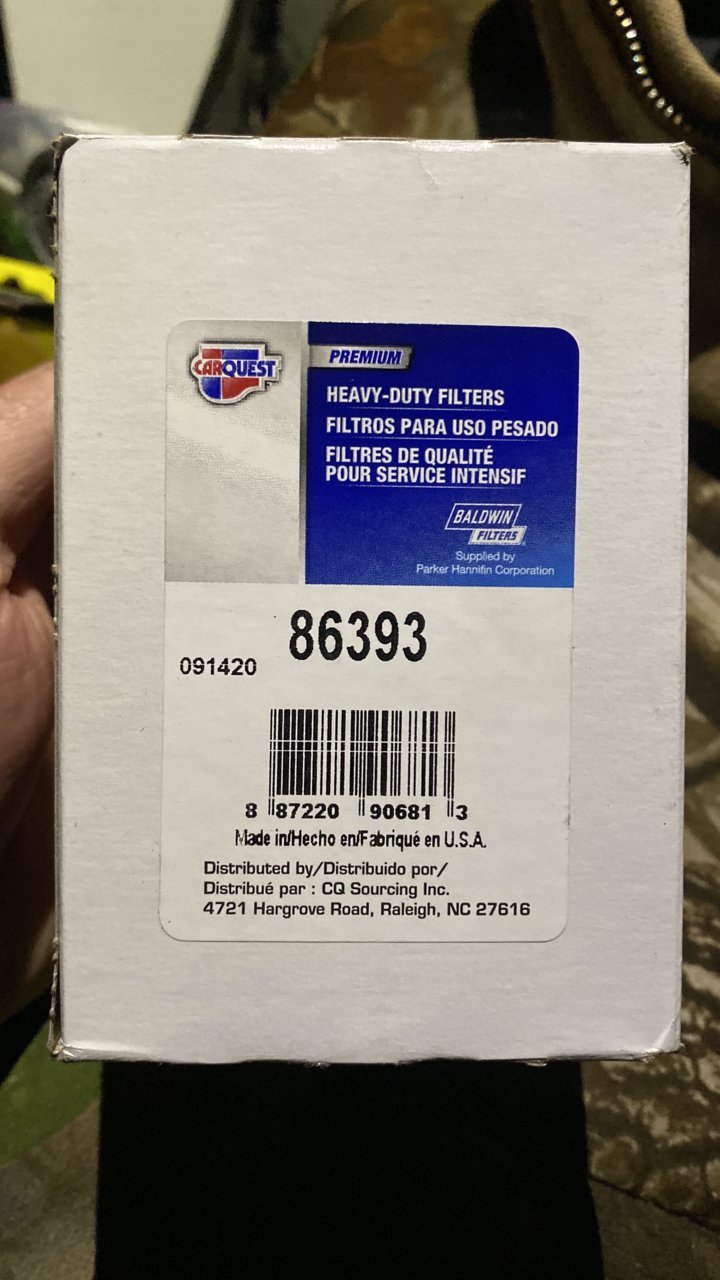

    The Kubota we acquired recently would only run 8-10 mph on the road. I looked and the fuel filter was original to the tractor at 11-12 years old and 582.3 engine hours. I replaced it with a Carquest filter made by Baldwin and now it runs great on the road at almost 21 mph. The factory filter is painted to match the engine and the Kubota replacement filters are white. I cut open the factory filter and took some pics:

    Not making filters stand out is a problem in a lot of manufacturers, I’ve run into that a few times, making them damn near impossible to access is also an issue.
    Granted, the owner of said machine isn’t blameless, he should know how to maintain the machine, Joe homeowner generally doesn’t pay attention to the finer details until it doesn’t work at all.

    Are you sure that's a fuel filter and not a hydraulic filter? The fuel filter is the one with drain water (clear filter housing), unless you have two fuel filters. If you do they should be connected.

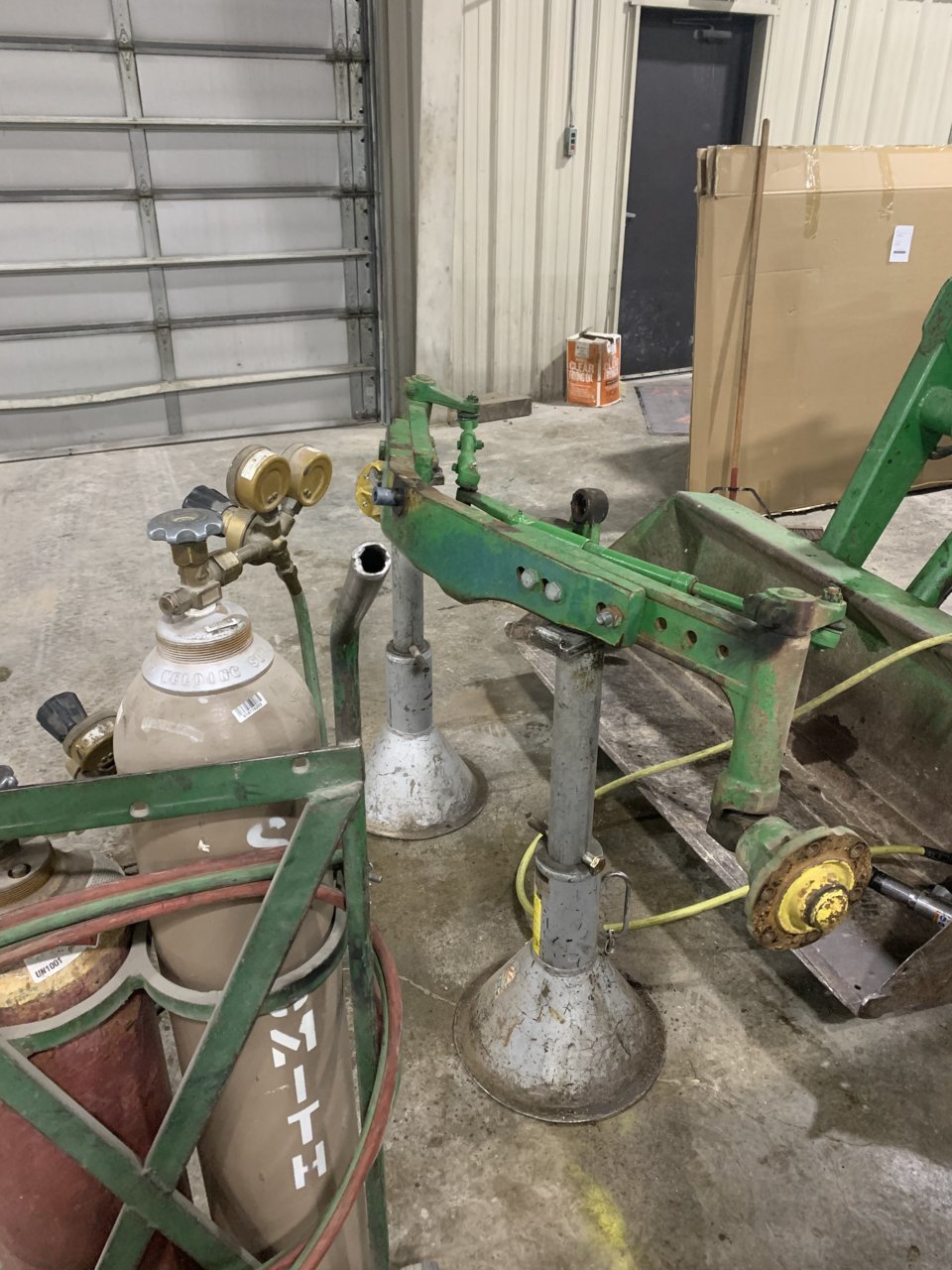

    Rebuilding a front axle on a 2040 from pre 1975. Axle hasn’t been worked on since factory installed it.. almost 50 years ago.
