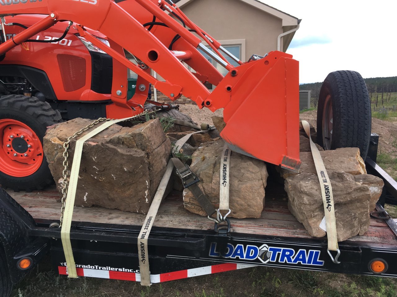

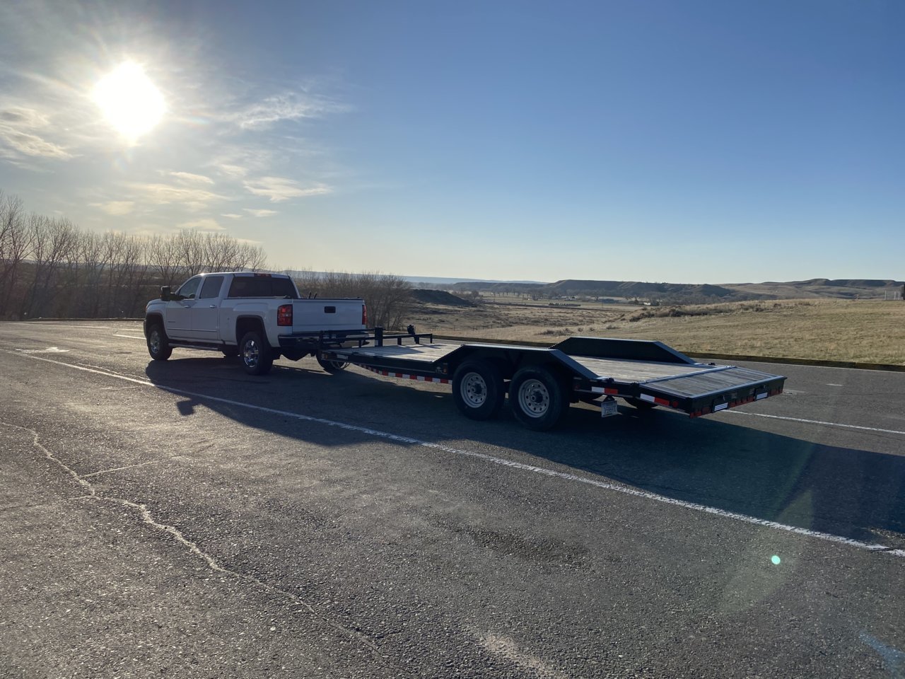

    Been struggling with a dilemma lately on trailers, and a good portion of you all have "other" trucks than a Tacoma to tow the tractors/toys. This will be a longer post...picture heavy.
    What I currently have or have access to:
    Load Trail CC14 102"x20' with drive over fenders, rear stow ramps. When towing the crawler, I don't use the ramps. Now this is hard on the rear frame/hitches/couplers...etc. I plan on changing my evil ways and using some kind of ramp system. Loading the tractor is pretty easy, but humping these ramps around all day does bring on the suck if doing side work. This trailer is going away probably in the next 6 months or so since it's my brothers in Montana.
    20' will allow the Kubota 2501 with loader and brush hog will hang over a few inches. A 22-24' would be optimal.
    This is my last 16' Load Trail trailer that I built drive over fenders and widened the trailer a few inches per side so tires were more planted.
    Next up is a Texas Pride 28' 16K rated gooseneck low boy. This is not completely mine and we use it exclusively to pull doubles when going on longer trips or if one of the clubs tow rigs is down. Not a huge fan of 83" decks with wide vehicles. Most of our buggies are 88-90" wide from outside the tires. Now if I weld on 2x3 square tubing like on my last trailer to the stake pockets...not a problem.

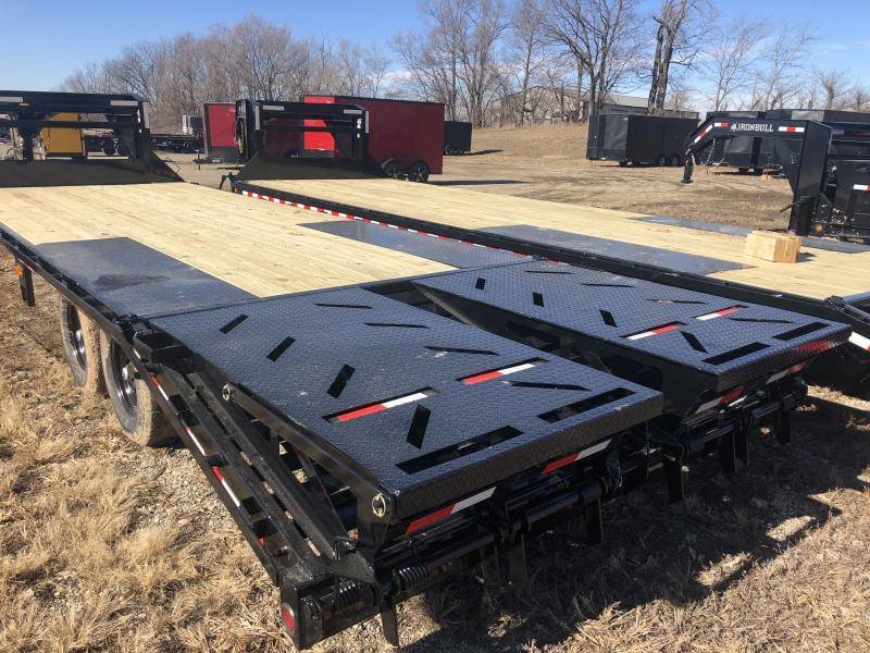

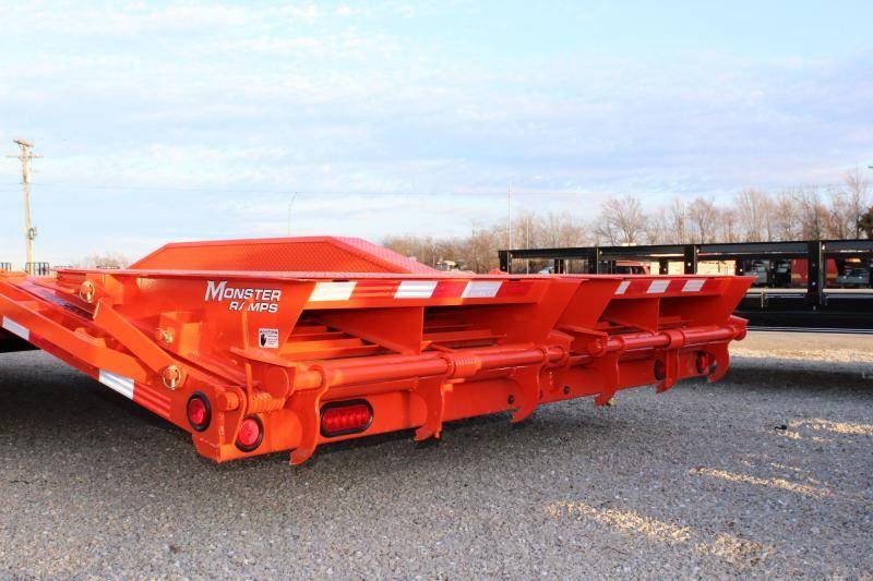

    What I need/want:
    I would like to have either a tilt deck or mega ramps for loading purposes. No more humping 80 lb (or heavier) ramps around, bending over/twisting which as we all get older know this is a recipe for blowing out your back or a nut. This is a need.
    Mega/monster ramp setups on lowboy
    Mega/monster ramps on deckover.

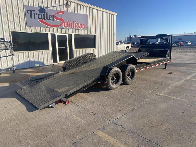

    Tilt decks: I never owned one. Some can't say enough good things about them and others say nightmare maintenance or if the locking pin gets bent you are screwed. Remember I'm not using this trailer at a commercial capacity. Only down side is I need the fenders to tilt with the deck. I would have to make some drive over fenders unless I can find a 102" wide tilt deck. Removable fenders work, but would be a PITA every time.
    Steel deck vs wood. I have always had wood. From my research it looks like about the same amount of maintenance for either one. Sanding and repaint/treating decks is common. Colorado uses Mag-chloride and salt solutions for winter driving conditions. Cleaning off trailers is a good idea for long term longevity. We can't say that Colorado will always be "home" either.
    Deck over vs low boy:
    This is a tough one. Deck overs make weight positioning a breeze. In the picture I posted up top, you can see the last buggy needing to put one tire on the fender and one on the deck to get both rigs on. Hard to see, but this put extra stress on the frame (has no torque tube) and can see it was lower on the drivers side. This kind of sucks. This can be fixed by building something like this. Vehicle tires can sit on this all day long.
    This PJ is set up really nice...except the damn color. If that wasn't General Lee orange, I would have already been in route. 24', 102" wide with drive over fenders, winch plate, Monster ramps...
    Deck over low boys (33-34" off the ground) have become more popular for this reason.
    I would ultimately love to get a gooseneck enclosed race trailer in 28-32' with 7-8K torsion axles, I would be in heaven. Keep toys in trailer and open up a spot in the garage. Cheaper than building another garage. This one is 2008 ATC 28', 7K watt gen....pretty nice. 20K
    No more hauling rocks, but I have access to a couple dump trailers now anyway.
    Comment away....

    1st and 3rd picture, GMC 3500HD.
    The enclosed might help with a move from Colorado to "wherever" in a few years. Not sure yet.
    The tough part is finding one like this. Right now it's in Little Rock, AR and the only one in this length and price point on Racing Junk.

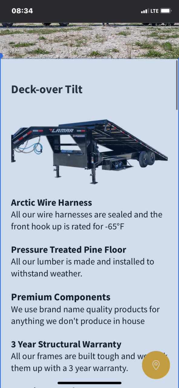

    My vote goes to a Deckover Tilt trailer. I know that PJ makes one that's 102" wide, lengths from 22' to (I think) 26' or 28' and with GVWR's as low as 14k to keep you under the threshold for a CDL (if that's a concern; I don't know if you have your CDL or not). They also make a gooseneck version but I think the lowest GVWR on that model is close to 16k, so depending on what your truck's rated for you may be perilously close to that magical 26k line in the sand. And I'd also vote for a wood deck over a steel deck, personally. There's nothing in the world that's more slippery than a wet steel deck.
    I've heard similar about the locking pins being a problem, but always from guys who don't run one. In my experience with rental units that I've used they're pretty stout. You'd have to REALLY be abusing it (poor loading technique, grossly overloading, etc) to bend one. The place I rent from has one that's 5 or 6 years old and has all of the original parts, which in my mind signals the strength of the locking mechanism since we all know how people treat rental equipment.

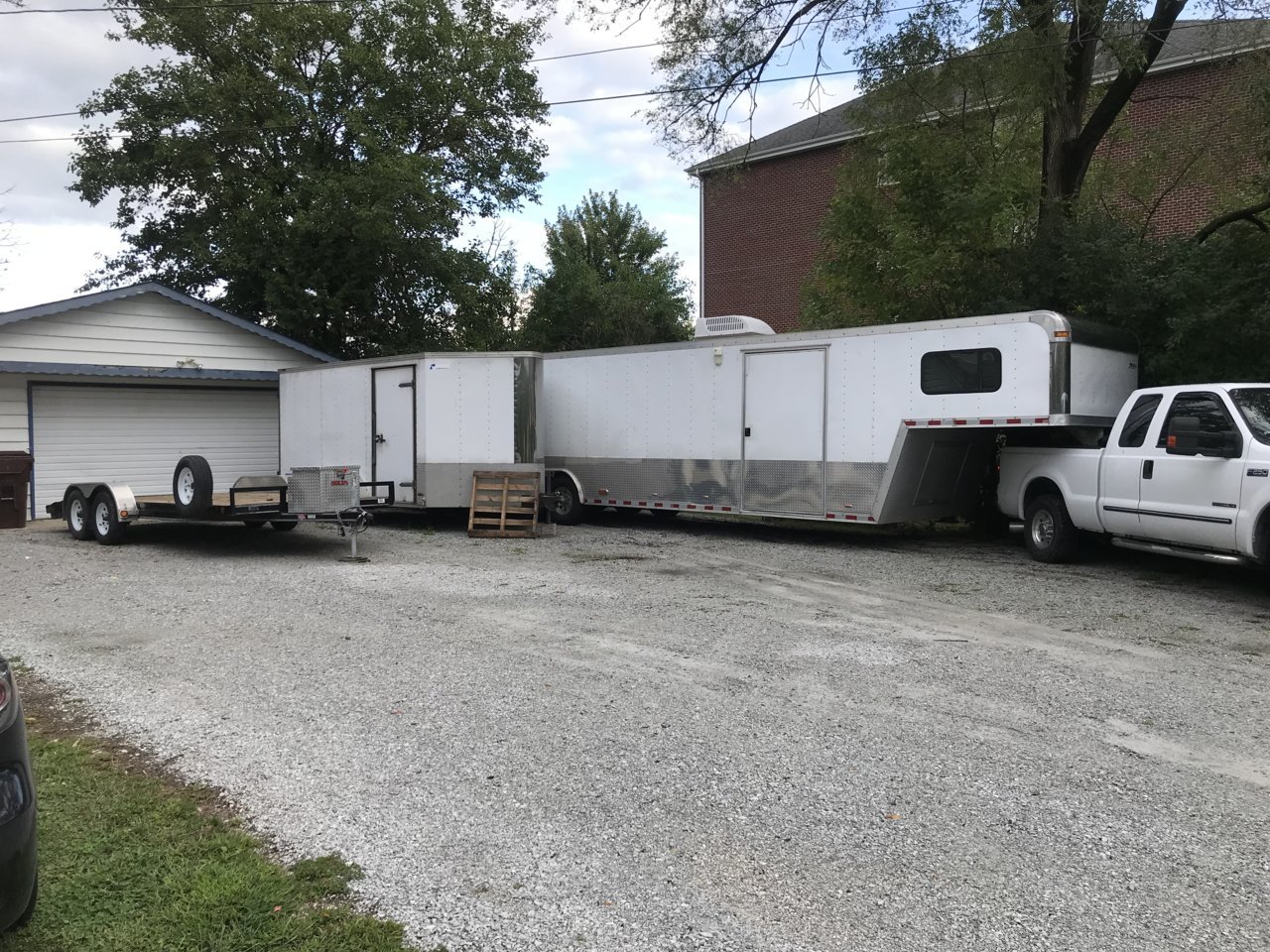

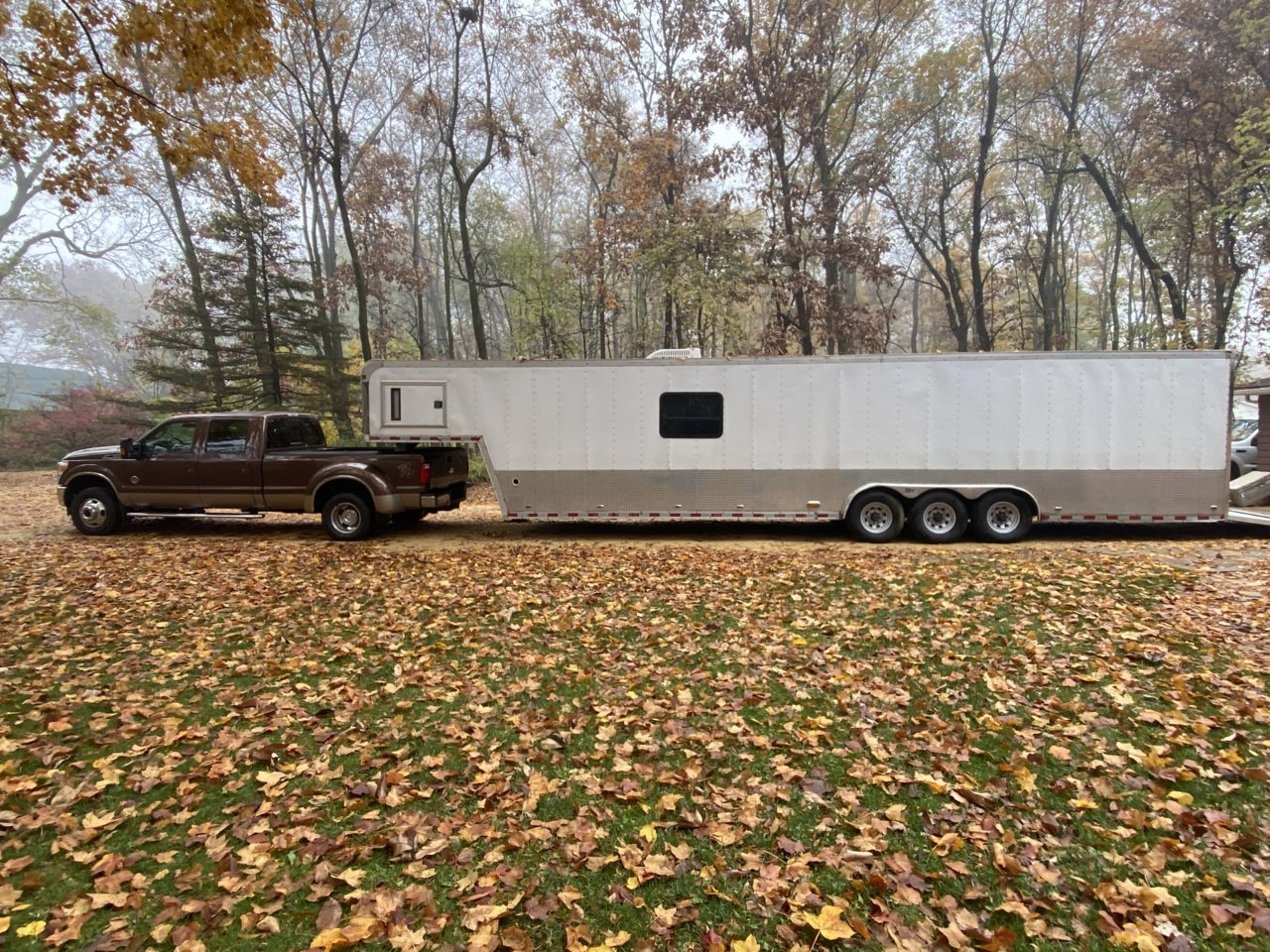

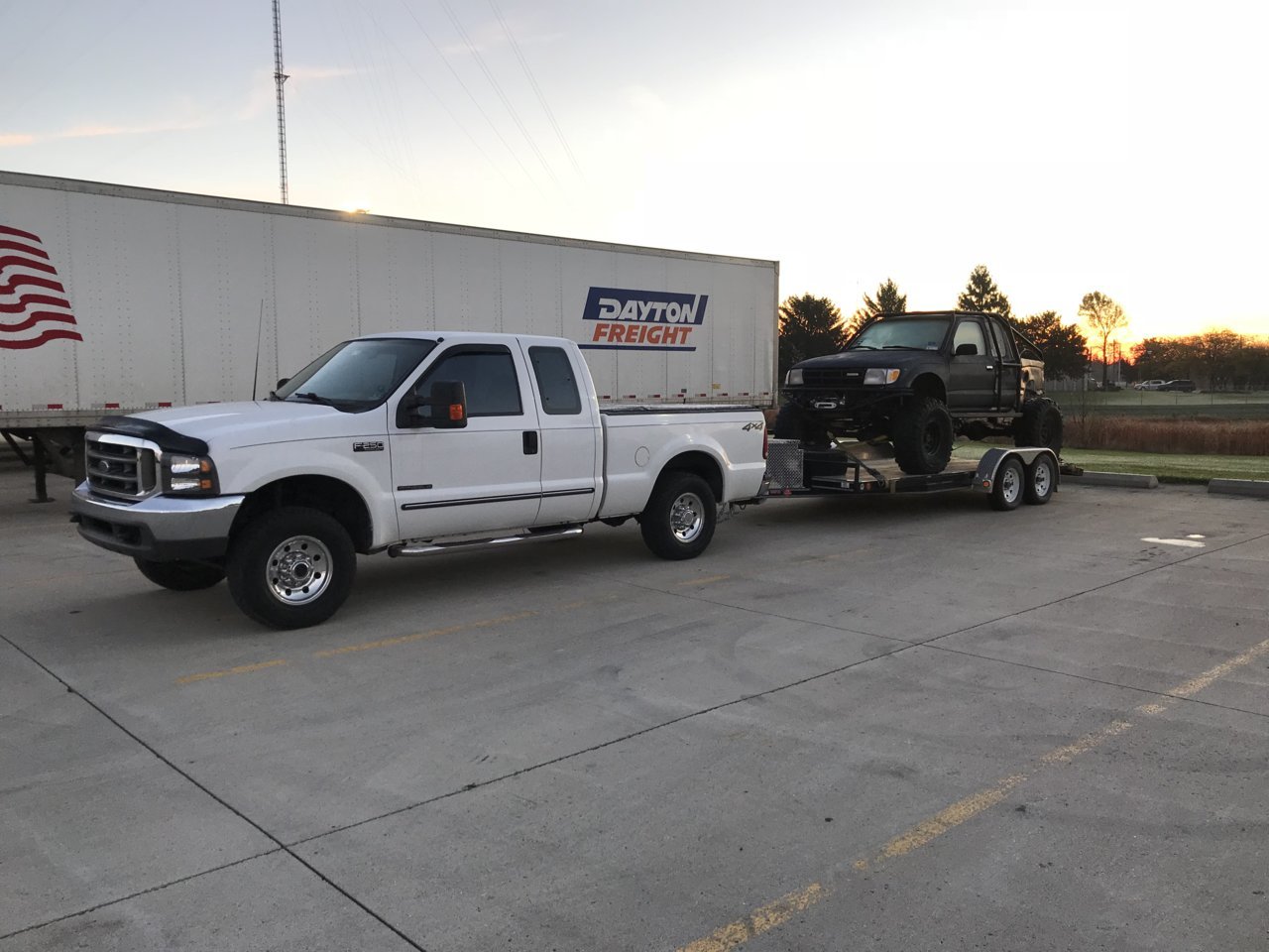

    I’ve gone from a 20’ PJ open trailer to a 40’ Pace enclosed gooseneck with living quarters and I’ll just share my pros and cons.
    Open pros:
    -Easy to pull empty
    -Easy to strap down loads
    -Nice for loading odd materials like sticks of tube with a forklift.
    Open cons:
    -Not as secure on the road to curious eyes
    -No weather protection
    -The gooseneck takes out a lot of bed storage that you need to find a home for now
    Enclosed pros:
    -An extra garage spot is great, I love mine for storing the Tacoma or the race karts in for the winter.
    -More secure on the road and you can toss smaller items in around the truck/tractor easily
    -Being able to camp in it is awesome if you have bad weather.
    Enclosed cons:
    -You get the same mileage loaded or unloaded, it’s a sail in the wind.
    -Strapping down loads is harder and coming up with flexible strapping points for heavier items like the tractor is difficult/impossible if you change what you haul often
    -Overall heavier than an open trailer.
    All things considered, more of the guys I wheel with are starting to move towards enclosed. One has a 28’ tag with bunks in it that is sweet and another one is looking for exactly what you are in that 30-34’ range
    Forgot for a moment that this was my fleet of trailers until I pared down to just the enclosed

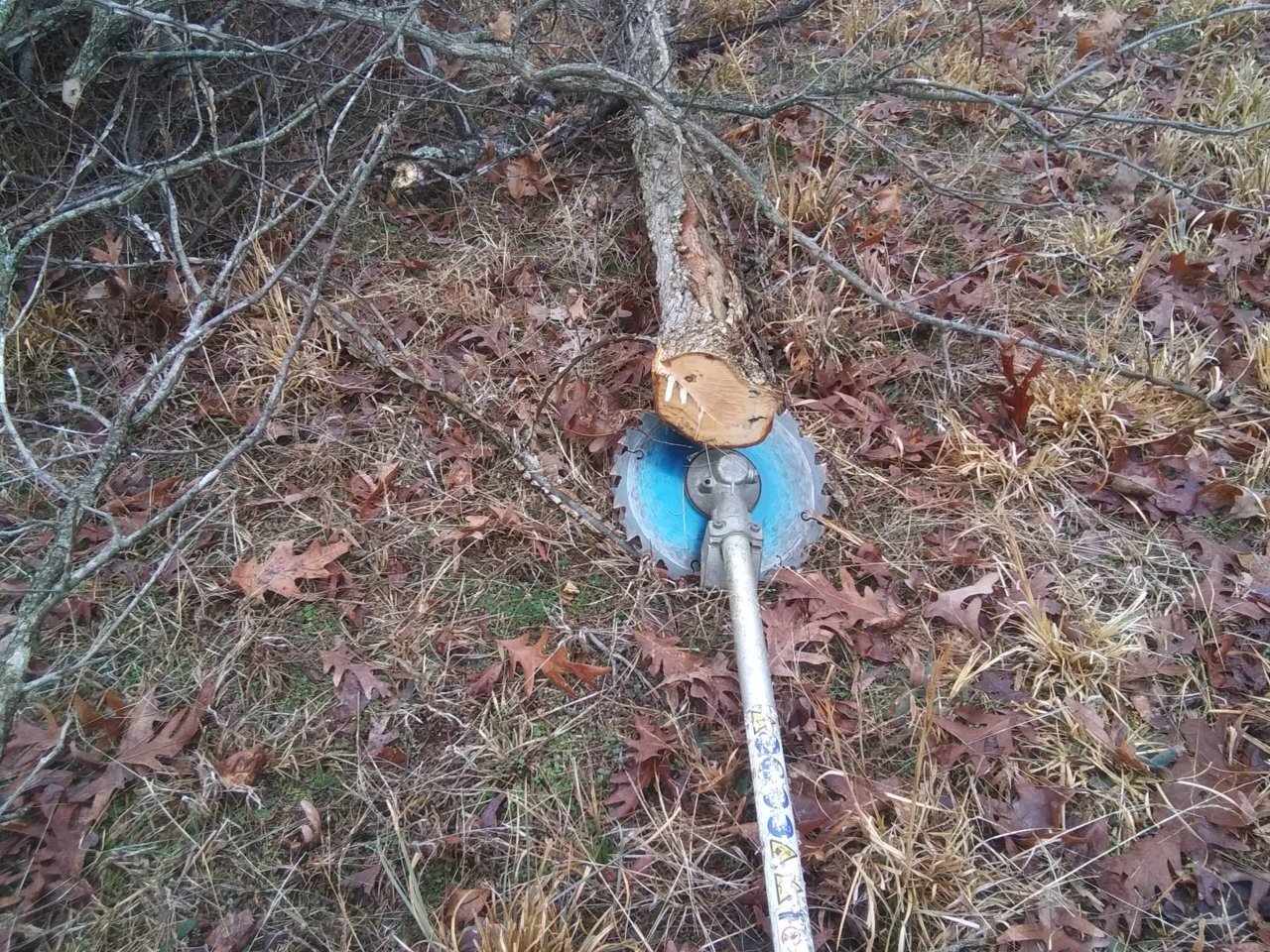

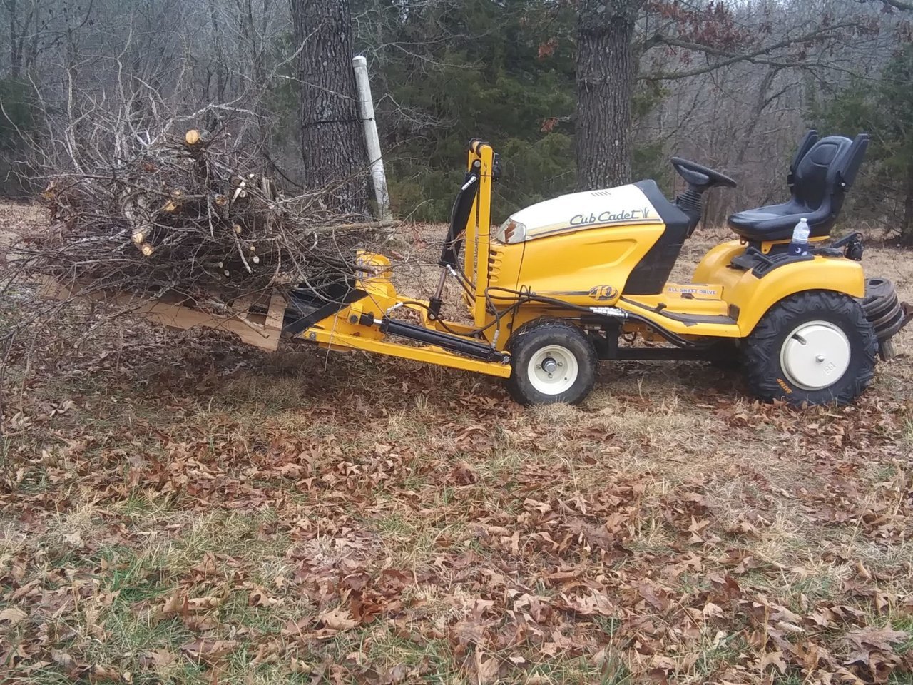

    Cutting and hauling brush today. I strapped my pallet to my bucket so I could tip it all the way forward to dump it. Working well. Gonna brush hog later with the 3205 and Swisher Rough cut.

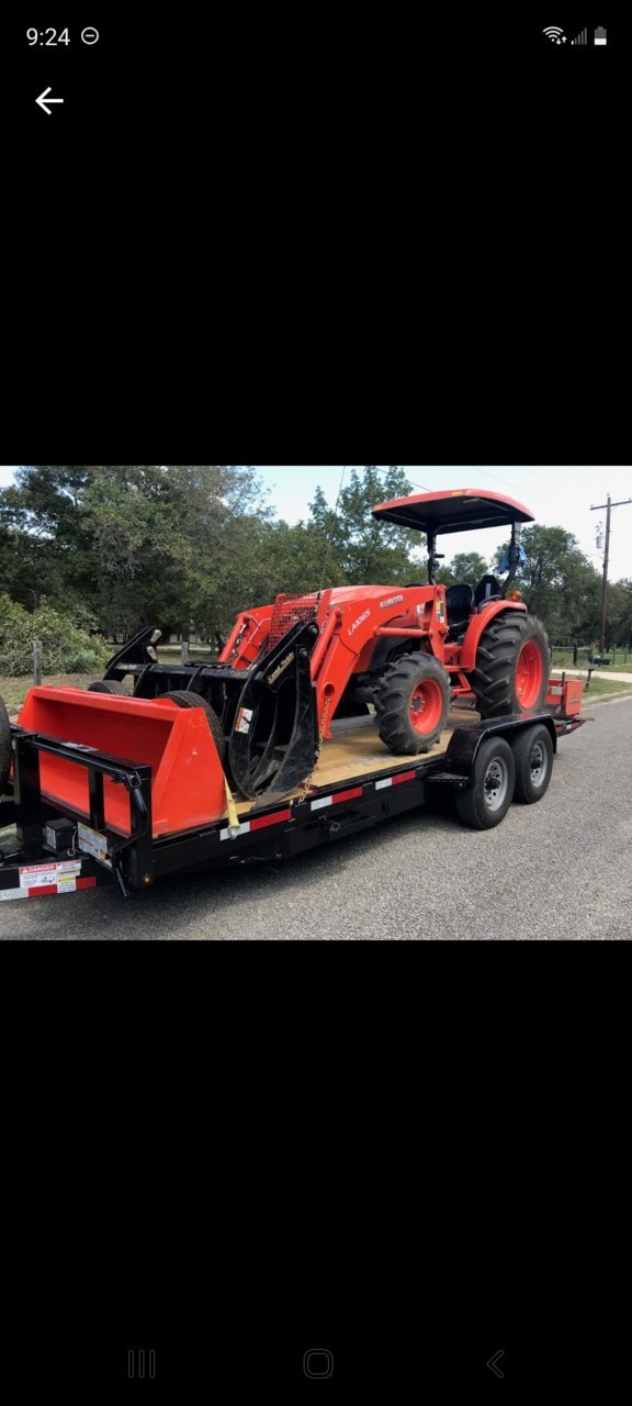

    I might end up with something like that and sell mine, but would like a 23' for the tractor etc. and I was just looking at 75's last week.
    Current TP tilt trailer.
